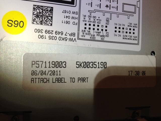

                            The RCD510 code is 5K0 035 190 (no RVC connection)
                            BT code is as per my posted pic on page 3 being 7P6 035 730 F
                            in semi related news, i reported that the address book when displaying entries is all garbled. Marc from vag-navisystems said that its a firmware fault on the RCD and that the dealer has a fix for it, but may not know anything about it, so i would need to push for it. I won't bother as i realistically never use it anyway, i just use the 6 presets, its good enough
