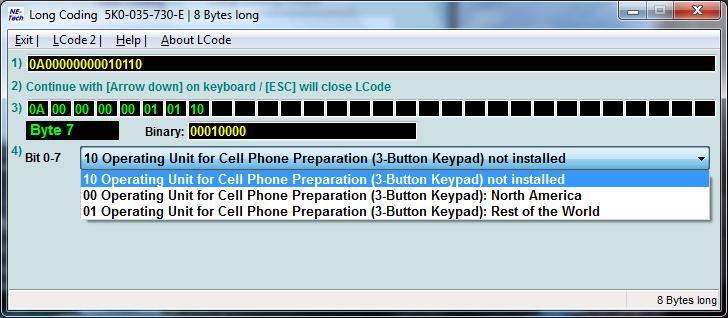

Was in VCDS the other day and found the setting for the Golf to stop faults being logged:
Select None if you don't have the 3 phone buttons in the roof module.
