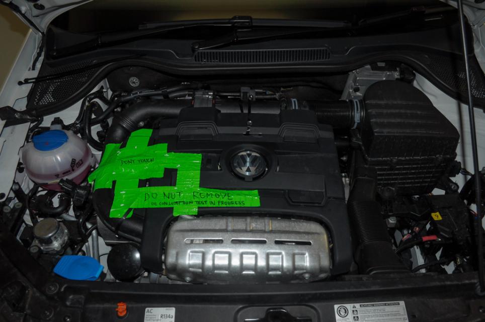

                      • Originally posted by Candy GTI View Post
                        This is currently what my Polo GTI looks like under the hood lol
                        Apparently this is the procedure set out by VW...
                        MIght be the angle, but it looks like your engine coolant is over filled. VW service overfilled mine and it subsequently overflowed. ENded up with dried white droplets over the engine and a white spray over the underside of the bonnet.
