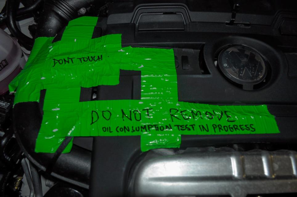

                    • This is currently what my Polo GTI looks like under the hood lol
                      Apparently this is the procedure set out by VW...
                      • Yes, they are doing the same here...
                        What I'd ask if I'd have a consumption test is to be present when they fill the oil, just to be sure that the max level is respected and they don't fill with too much oil, just to mystify the final result...
                        • Looks amazing, NOT.
                          • Yeah I would've liked to see the dipstick as well but this is how it came out from the mechanics so who knows if they put extra oil in to cover their asses.
                            • Originally posted by Candy GTI View Post
                              It's just normal tape. You can always remove it and put it back LOL
                              But I wouldn't do that ofc
                              • Originally posted by cyborgcuprajq View Post
                                You can see where the tape overlaps they have put whiteout marks to make sure it all lines up.
