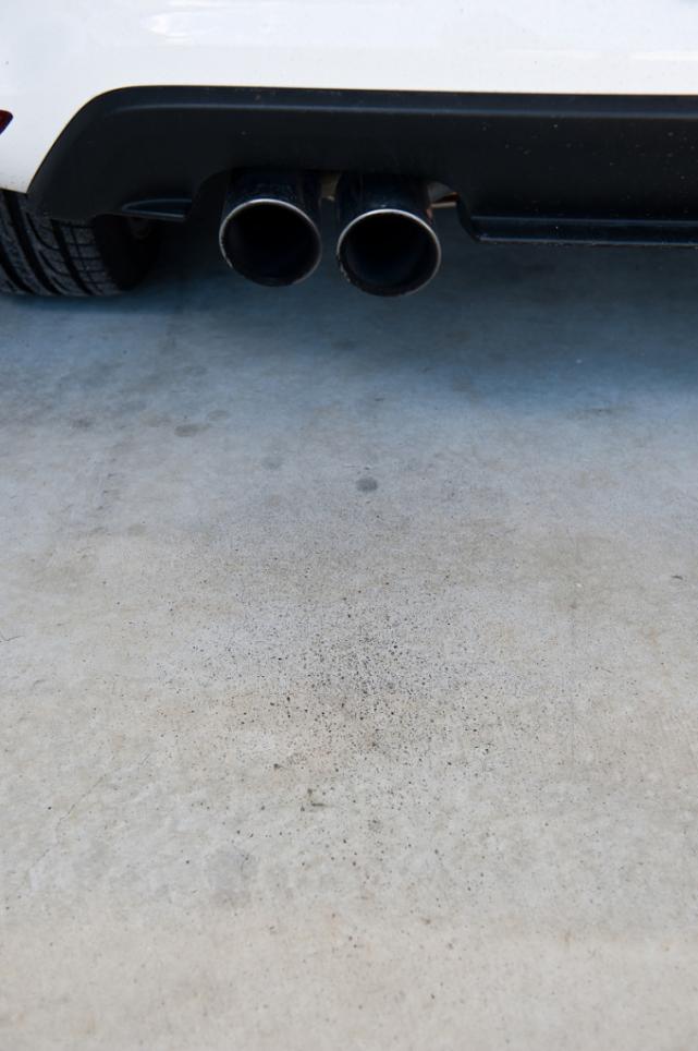

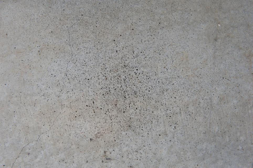

                  • Check this out:
                    This is also what gets sprayed all over the rear of the car.
                    • That last picture is just carbon...now the oil splatters are what are really bad.
                      • That's pretty nasty exhaust discharge, I agree with Acko in that I see it to be carbon (aka soot) but that amount is worrying. Shoot me a pm if you want a potential course of action that might help with fault finding...
                        • I'm not sure it's only carbon, if it's sprayed all over the back of the car it means that it is light as black oil sprayed that is able to be stuck to the bumper...
                          If you touch those little dots on the bumper they should be oily...

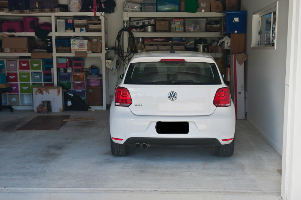

                          • So if this has only happened over the two months we've had the car then why isn't there a massive black patch behind the car that parks in the spot next to it, seen as it has been started every morning over a period of 3 years?
                            I don't know how it could be soot because I can wash the car spotless, go for a 30 min drive then already have wet little black spots covering the back of the car. When its freshly sprayed on the back of the car you can wipe it off with a finger and see it can't be anything else but oil?
