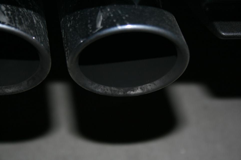

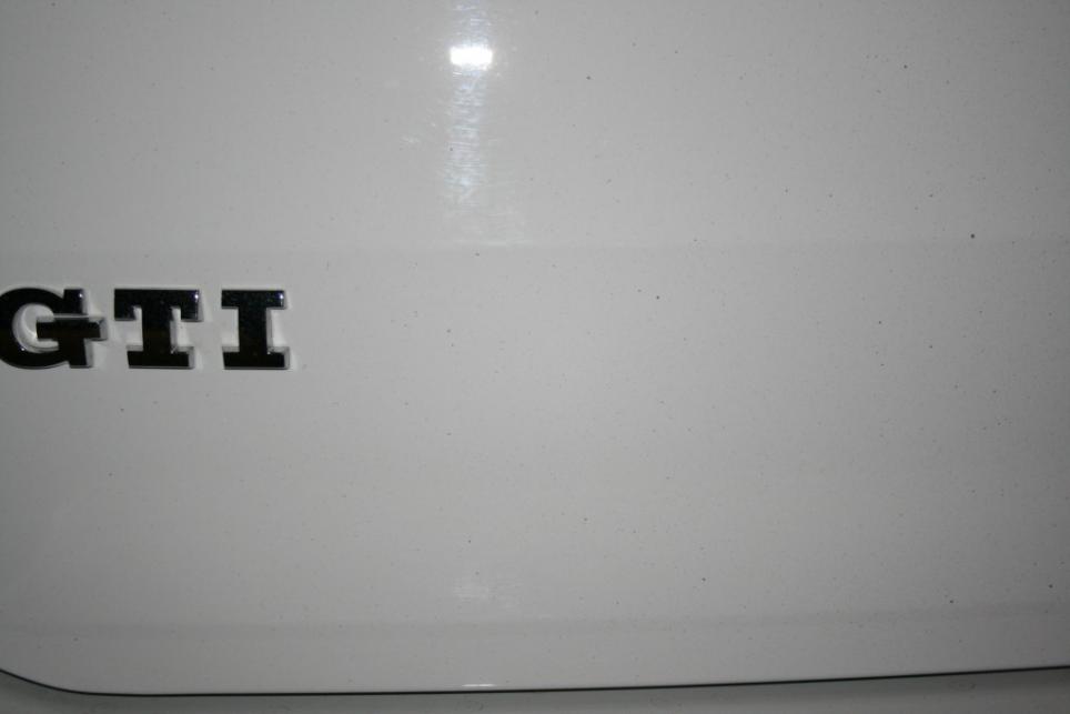

Originally posted by lunchboxGTI View PostMy GTI is a march build this year and has done just over 400km. i have been watching the dipstick like a hawk and it has not moved a mm.
But today i noticed soot around the exhaust tips and all over the back.
Thoughts

It's not normal ... mine only got worse and worse... running to rich? My dealer did mention it on the problem sheet so that's proof enough that its not normal to me. And yeah since new engine there not a single splatter on the back of the car.
It was suggested to me to get an emissions test if they didn't come to the party about it. I can't imagine with that output it would pass the test (mine was blowing plumes of burnt oil as well though).
I had the black soot on my exhaust as well.. but since I started to drive a bit more careful (waiting for the engine oil temp to hit >80C before revving above 4,000rpm) the soot appears to have gone away.
