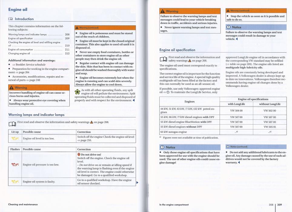

                      • Polo GTI High Oil Usage - Discussion Thread
                        Just scanned my owner's manual:

                        • Originally posted by alexaescht View Post
                          ^Thank you for that. Also is that the booklet that came with the car? Mine displays the same info but it's squashed into a A5 booklet
                          Now to the next point - Australia is classified as a "hot climate" which means we only run off the long life, fixed service scheme meaning its 504 or 507 only.
                          This is a good thread discussing this.
                          http://www.vwwatercooled.com/forums/f77/why-you-need-use-504-507-oils-fsi-tsi-tdi-engines-47140.html
                          "Longlife III
                          Oils with reduced SAPS designed for variable service intervals of between 15,000 km/1 year and 30,000 km/2 years. Supersedes all previous VAG oil standards, except for R5 and V10 TDI engines built prior to 06/2006. Subject to 504.00/507.00 approval and is only available in one grade: 5W-30.
                          You can still use Longlife oils even if you run on fixed service intervals. In fact VAG recommends that if the car's driven in harsh operating conditions you should ask the dealer to switch over to fixed service intervals (Australian delivered cars are on the fixed service intervals)."

                          • I can smell humble pie...
                            • Wow, i didnt expect i start a discuss like this.i thought just a simple confirmation. I just take a photo of my manual.mine is polo gti my14.

                              • In the manual,it also have a castrol edge ad card in it.so i think it is ok to use.just want to confirm and in the manual i think my cae is fixed distance/time. So 502 is ok?
