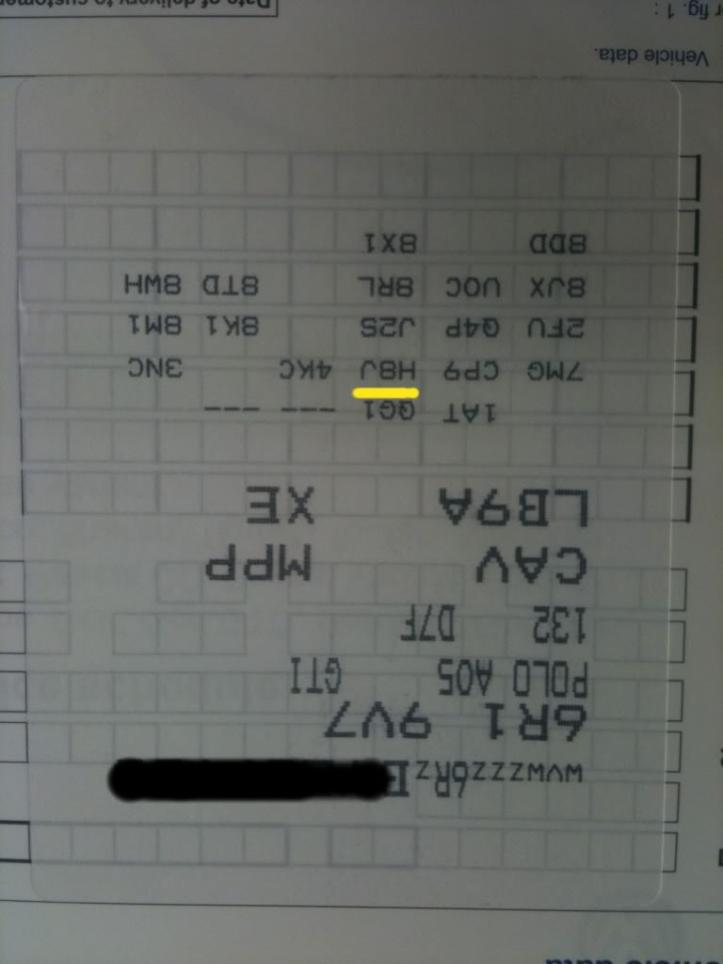

            I think that comment sums it all up TO confirm though, the GTi is a long-life service vehicle, as shown by the following 2 images out of the service schedule:
            Now, to be truthfull, i cannot confirm 100% because I do not have the mandatory confirmation cross in the box on page 3 because I haven't had my first service yet, though, based on having the specified code in the book, I'm lead to believe that this particular GTi is a long-life service vehicle. Not that it bothers me, because I for one will most likely be chosing my own oil anyway
            • Gavs
              Mine is the same. came as QG1 (or QG0 or 2 or whatever it was) and even had the service computer set to long life/730days/30,000km but we simply don't do Long Life in Australia. ie: there is no difference in the basic construction of a QG1 engine compared to the other engines. QG1 has a couple of sensors to monitor oil quality. I think one measures viscosity by measuring the pressure difference across a restrictor (could be wrong on that one) & the other measures the colour (soot, suspended solids, etc), plus the other stuff such as number of starts, etc.
