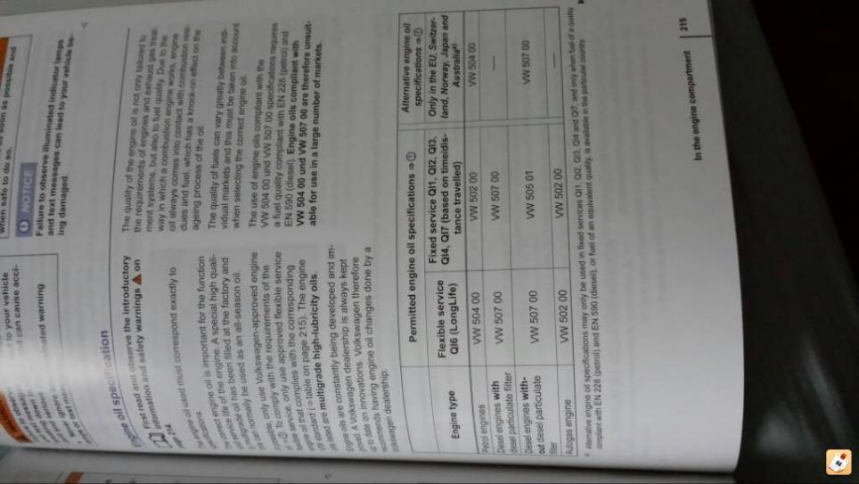

  • Better pic quality
    Sent from my GT-I9505 using Tapatalk

      ^Thank you for that. Also is that the booklet that came with the car? Mine displays the same info but it's squashed into a A5 booklet
      Now to the next point - Australia is classified as a "hot climate" which means we only run off the long life, fixed service scheme meaning its 504 or 507 only.
      This is a good thread discussing this.
      "Longlife III
      Oils with reduced SAPS designed for variable service intervals of between 15,000 km/1 year and 30,000 km/2 years. Supersedes all previous VAG oil standards, except for R5 and V10 TDI engines built prior to 06/2006. Subject to 504.00/507.00 approval and is only available in one grade: 5W-30.
      You can still use Longlife oils even if you run on fixed service intervals. In fact VAG recommends that if the car's driven in harsh operating conditions you should ask the dealer to switch over to fixed service intervals (Australian delivered cars are on the fixed service intervals)."
      Yes that's the booklet that came with the car, and yes it is A5.
      I won't comment on anything else as I was never part of this, I only provided evidence.

      • Originally posted by ATYPIC View Post
        I can smell humble pie...
        Nope, I'll stand on what I say.
        Look at it. Column 2 "without longlife" = 502.00 for all petrol engines.
        Tell me where it says in the manual or an addendum that AUS is classed as a hot climate that requires a higher grade of oil?
        Where does it say this:
        my 1.2tsi says it can ONLY use 504 oil. 502 can ONLY be used for topups and CANNOT be used as part of a service.
        It then goes on to say that the warrantee WILL be void if it is proven that 504 oil is not used. If I had a computer I would be more than happy to post the guide.
        Basically he's making stuff up as it says nothing like that in the manual.

          That card is for Castrol Edge Professional which is 504 & only sold to workshops.
          The Castrol Edge Sport is different & 502.00. It's fine to use. It says so in the 2nd column from the right.
          So are you going to believe what's written in your VW manual or take notice of all the Polly-annas?

                          • Judging from the replies in this thread, it would appear that the owners manual a bit tricky to interpret.
                            Vehicles on the Time & Distance service regime (applies to all Australian delivered passenger vehicles):
                            - Fixed service intervals of 15 000 km or 12 months (QI4 or QG0/QG2/QG3).
                            - Applies to all vehicles in all markets other than those on the LL service regime.
                            - Use of engine oils approved to VW standard 501.01, 502.00, 505.00 or 505.01 (as required) is mandatory.
                            - Vehicles may also use engine oils approved to VW standard 504.00 or 507.00 if desired, fuel quality permitting.
                            - Exception: TDI engines fitted with a diesel particulate filter (DPF) must use 507.00, irrespective of service regime.
                            Vehicles on the LongLife service regime (does not apply in Australia):
                            - Variable service intervals of between 15 000 km to 30 000 km or 12 months to 24 months (QI6 or QG1).
                            - Approved for certain markets only: to date, Europe (excluding some countries, such as Russia), UK and Japan.
                            - Use of engine oils approved to VW oil standard 504.00/507.00 (often marketed as "LongLife III" oils) is mandatory.
                            - If the engine is topped up with more than 500 mL using any other oil, vehicle is considered to have reverted to T&D service regime.
                            - Vehicles can be switched to the T&D service regime by the dealer at the owner's request.
                            Other notes:
                            - Volkswagen does not recommend a specific viscosity grade, which can be mixed without issue.
                            - Engine oils approved to different VW standards can be mixed without issue, noting the above limitations.
                            - Some markets, predominantly developing nations, have reduced service intervals of 10 000 km (QI3), 7 500 km (QI2) or 5 000 km (QI1).
                            - Vehicles sold in some markets (e.g. China) are not permitted to use 504/507 oil due to fuel quality concerns.
                            - Vehicles with TDI engines sold in markets without ultra low sulphur diesel (ULSD) are not fitted with a DPF (requires 505.01 instead).
