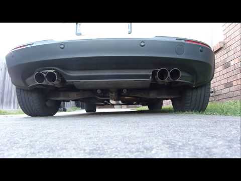

            Ok Guys I managed to get some pics and a video of the Tig exhaust. Hopefully I will update the thread with more detailed pics and a moving video.
            Tell me what you think

                I know you probably didn't like taking a hacksaw to your rear valance however it doesn't look that bad. Though an ABT rear bumper with dual exits will finish it off nicely.
                Some nice meaty pops on over-run. Will be interested to hear what it sounds like when moving - both WOT and 1/4 throttle.
                From the photos it looks like you've got a resonator as well as a rear muffler. I'm not sure what you had before but my experience with non-res was a bit of a disaster and that was with a 2.5" system and not 3" like yours.
                I'm still happy with my exhaust. It is slightly more noisy than I'd like at some RPM with lightish throttle but you have to live with that if you want to get a decent sound on WOT.
                I'm guessing you've got some decent DSG farts now

                  Thanks Guys!! I am really happy with the sound of the exhaust even though it is not very loud. My goal was to build an exhaust with minimal drone but free flowing and I think I have come close to achieving that goal. Drone or any exhaust sound on freeway cruising around 2000 RMP, is non existent and I can enjoy my sound system without any interruptions and when I get on with it, it makes some meatier pops and growls and let me know it is there.
                  This is what I had before for a short while which I got from Stiffy86,
                  It had all the right sounds, pops, crackles, bangs you name it and was also very loud. Some work mates loved it however after my manager said he could hear me 10 cars behind while I was moving in traffic I decided to pull it off..haha!
