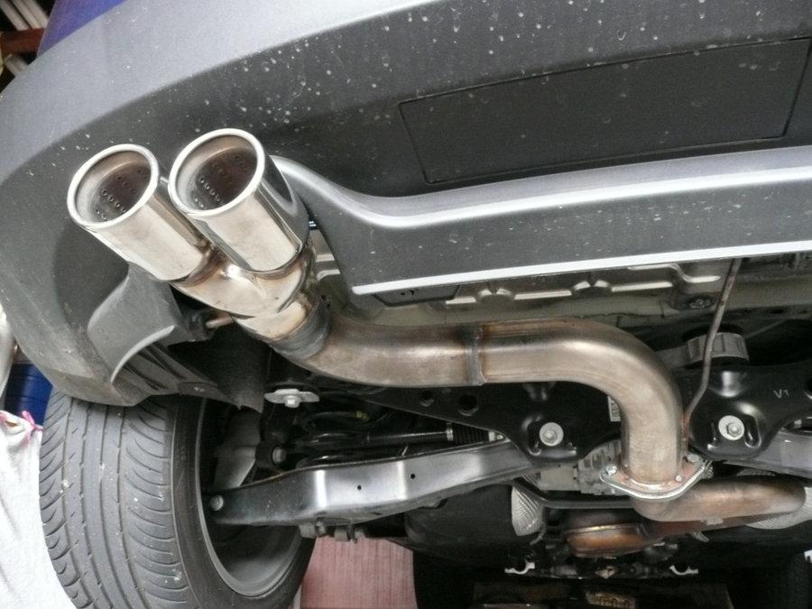

    Car is booked in for a noise upgrade on Wednesday.
    Will take some sound clips for you all
    Updates probably on Wednesday if i can stitch it all together.
    Mmmmm delicious sounds!
    Trying to stitch together a video of the sound clips for you guys.
    Well worth the upgrade if you want a bit more growl!
    Also the standard system from the axle back weighs in at a hefty 9kg.
      The upgards consists of a custom stainless steel mandrel bent 3" muffler delete pipe flowing through twin XR6 Turbo tips.
      All the work was done by BPS at Cleveland and i cannot speak highly enough of their work.
      Video can be found here:

            The retail cost is $438 but the cost is basically for labour.
            there is a very slight resonance in teh cabin at 1750 but it goes away at 1900RPM.
            Could just be my ears getting used to the exhaust note that i could never hear before though
            Should get a bit softer over time as the system gets coated in exhaust ash.
            Never got to weight hte new section but it is just some 3" stainless piping so it shouldnt' weigh much, i would say maybe half of the stock system.

                    Sound only.
                    If you want more power from the cat-back you need to remove the resonator but i was affraid this would produce an overly loud or warbly note.

                    On the upside, the system is completely reversible so i can just bolt the stock muffler back on if i want at any time, should only take 5-10 minutes.
                    There is a little resonance at 1750 and again at 3000 but it's only there for a short range and you don't really sit on those rpm bands often.
                    Bear in mind it will be a bit quieter if you have the stock downpipe since i have the apr 3" downpipe and high flow cat.
                    I should try sitting in the back and seeing how it sounds.
                      Drone at 1750rpm's has all but dissapeared as the system beds in and coats itself in exhaust ash.
                      It is only noticeable under load for now.
                      Resonance is still there at 3000rpm's but if you are drviing it regularly you can easily shift at 3k and miss this.
                      So you only get it for a short while under wide open throttle.
                        Just thought i should add in another point about the delete pipe.
                        If you push the car up to 4k or more RPM you get that nice exhaust pop (DSG fart) as the backpressure changes when you shift gears which is nice.
                        going to try to get a driveby video for you soon as well as some better pictures.
