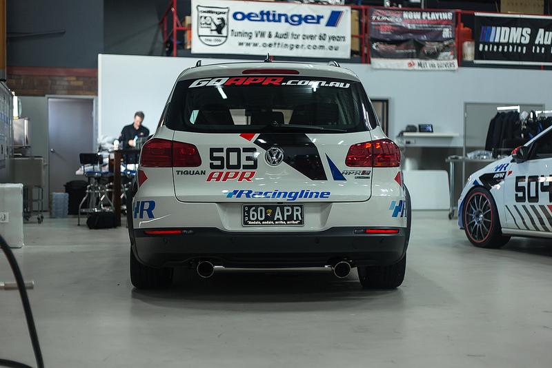

              There are a few other dual exit exhausts where people have just modified the stock rear diffuser with a hacksaw to get the right tips out. The APR Stage 3 Tiguan is a good example of this:
              I'm not sure on the details on this exhaust but I believe it may also be a custom set-up.
                We modified a Golf R front & mid section to work, the rear box is a modified Supersprint unit (who them selves modify a MK5 GTI system that was modified for twin outlets).
                The supersprint rear muffler is restrictive, it drops to 2.75" and we have done some testing with & without it. It costs us about 30nm of torque, but keeps us legal
                Hacksaw on the rear apron was the easy bit!
