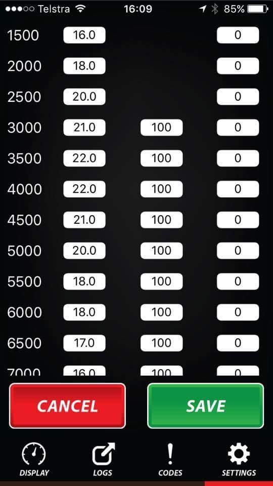

                    • So does anyone have any recommended JB4 Map 6 settings for a stock 162 Tiguan? Asking for a friend...

                        • Originally posted by Dan_3MPS View Post
                          Hey mate,
                          This seems to be the go to for most stock Skoda Octavia RS, same EA888 motor 162 kW /FWD.
                          You done the Airbox mod mate? Ie cut out the left hand side air intake of the Airbox?
                          Use at your own risk etc.... do a couple of logs, check trims and AFR
                          I was happy with the Map2, but the below is a bit of map1 and map2
                          This map showed 200kW at wheels on the Dyno

                          • Awesome info, thanks. Do any other settings need to be changed for that map? Fuelling to 50?
                            Sent from my SM-G955F using Tapatalk
                            • Start at 50 FOL, if your trims are high, ie over 40, make FOL 60. Rumor is anything more than 60 and you'll get fuel rail pressures codes.
                              Do a couple of 4th logs, key thing in AFR , trims and target vs real boost is with in a psi or 2, nothing more.
                              You can email George at BMS for tuning help.
