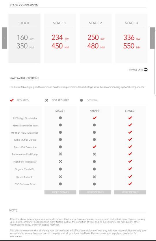

Originally posted by twyat1 View PostThis is a legitimate concern I have but I've been reassured that all Stage 2 OEM+ get around the claimed figures.
Sent from my SM-G965F using TapatalkTiguan Gen2 162TSI Etuners IS38 Stage 3 238.6 kw@4 wheels
Originally posted by twyat1 View PostYeah reference was more so towards the improvements over stage one. I'd be pretty disappointed to spend an extra $2k for 10kw and few nm.
