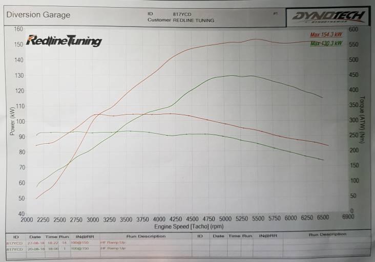

          • Yeah I don't mean to sound like I'm questioning or that I'm stupid. My tuner just asked about your 180kw. As I've got 155kw at the wheels on stage 2. I've done R600 Intake, Scorpion Downpipe IKH24 Plugs and DSG Tune. Have you done anything else like HPFP etc? He pushed for more but started to pick up knock so he said he didn't want to push it any further. Fiddle with timing, fuelling and boost but still pulled a bit of timing.

              • Originally posted by twyat1 View Post
                Sent from my SM-G965F using Tapatalk
                What did you get in terms of stock output on the same dyno?
                Different dynos will give very different results. It's best to compare before/after dynos and look at the % change.
                Otherwise you have to run back to back with another car on the same dyno / same day / same conditions to really be able to compare one run with another.

                    Did a few base runs, best was a 130.3kw. Very similar to Inasnt.
                        Hmm thats weird as my stage 1 was 165@4 wheels. The dyno i used is conservative, seen it read lower numbers than others on the same car..
                        Who turned your car? Got graphs of your a/f ratios, boost or anything else?

                        • Originally posted by INASNT View Post
                          This is all I have at the moment. I can ask for AFR and Boost Graphs. Redline Tuning, a local tuner up here in QLD.
                          • Have they tuned many VWs before GTI, R?
                            They are missing something in their tune. Another tig stage 2 got similar numbers to mine on same tune and dyno.
                            I want to see an APR stage 2 tig on the same dyno
                              Yeah there are plenty of them running their tune. I've been in a few of their customer's before deciding to get with them. Spent quite a bit of time on the dyno.
                              • Lambda at WOT is 0.82 and achieving ~12.3 AFR
