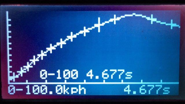

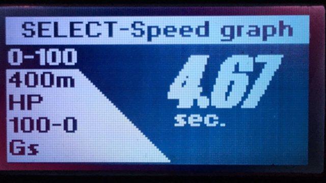

              • Tigger73's 162TSI Sportline
                Initial round of road tuning complete.
                Running a low boost (~23psi) file on Caltex 98 (behaves like 95 under boost).
                I’ll stick it on the dyno soon to tune a higher boost file and “proper” 98 (BP Ultimate).

                    • Coming along nicely.
                      • Damn those conditions.
