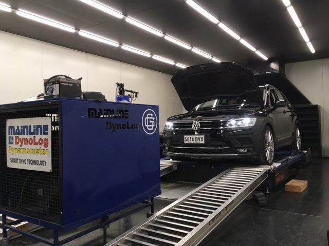

      Had the car on the dyno yesterday and was run up on the low boost file but ended up taking it off and doing another revision on the road as the shop was closing.
      It’s definitely quicker and pulls like a train. Just had issues with traction when launching as it was still a bit damp and spun all 4. Once it hooked up it was great.

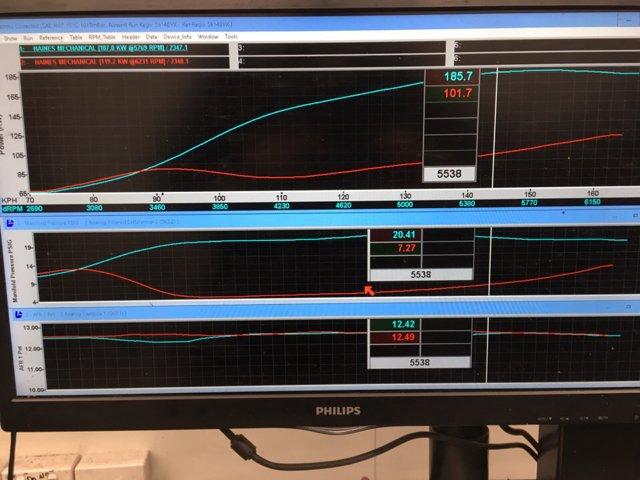

              Dyno results for the low boost file above (blue line). This is around 21psi and is 205-210kwaw on a “normal” dyno. This particular dyno reads about 20kwaw low.
              You can see that the turbo comes on boost and is able to hold it all the way through to redline.
              The red curve above shows the second file that was put in and the ECU protection cutting in just as it was ramping up. Unfortunately we ran into closing time for the dyno centre/workshop (Friday night) so ended up with a revised file and road logging only.
              New file is quicker than the low boost file but these a few more revisions required before we’ll call it “done”.

                • Originally posted by tigger73 View Post
                  The mainline dyno is a heart breaker dyno...
                  Not a bad result, but was expecting significantly more from the 475HP TTE and HPFP. Did the tuner say there was more in it ?

                    There's probably another 8psi in it if I wanted it which would be ~80kwaw give or take. I'm going to go slightly more conservative than that but we'll see what happens with timing retard as more boost is added.
                    I'll do another run when there's a window of opportunity with some dry road.
