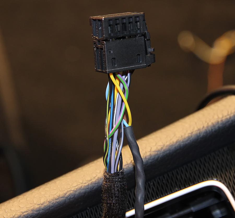

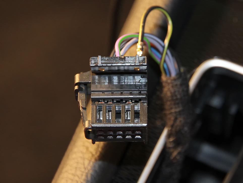

Installed my version of the Circuit today. For those following along I'm using a NE556 + Photomos Solid state relay.
I was able to get the connector apart and remove the pins so I could solder the wires directly onto the pins.
You still need to push a metal spring in first (you can see it in the picture on the pins still in place).
There's 2 small flaps either side that stop the pin from completely coming out after you've pushed the spring tag in.
Really nice connector , Swiss made, seems to make contact in 4 places at once, easy to pull apart for a change.
You can see it's nice and neat with the wires coming out of the connector and no wire splicing.
I made a pin header connector at the other end of the wiring loom so I could easily plug it into my PCB.
I'll heatshrink it all together when I make my PCB.

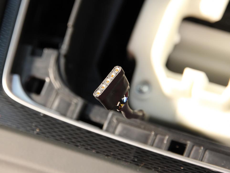

I plan on installing my test unit tomorrow. I was going to do what you did with the plug. Don was kind enough to also include a header plug for me so that'll make things easier. Good place to mount the unit too; mine should fit in the same spot. The ultimate solution would be to run the header outside of the console so that the S/S device could be removed without tearing the dash apart. There are a few spots that this could work but I'll look in more depth tomorrow.
So is there room inside the connector to actually run two wires to the one pin? Looks like there is from your photo so that's great.
Did you have any troubles getting your console apart?2016 GTI Performance | Pure White | JB1 | Dog Bone | Full Tint | Stop/Start Delete | Avatar by sandwg
The wire I used was reasonably small so I was able to fit it in the plug with the original wire - slightly thinner than the car wiring.
Console was pretty easy to get apart , this was my second time.
I think the hardest part is removing the rear "U" shape trim - just used a screw driver and went along one side to the other.
Also if you're soldering in the car I always cover everything in towels, having solder splats on the dash or leather isn't a good look.
Plus I always keep tools in the foot well so there's no chance sitting on some tweezers and having them go into your seat.MY21 Golf MK8 GTI | Kings Red Metallic | all options |

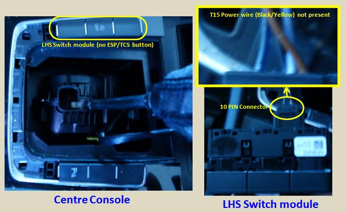

AJW and Matt: I guess the old adage about life being hard for the wicked is certainly true in my case!!
I just had a rummage around in the centre console on my car and I have to say that it's a little different to the pics that you have both put-up (thanks for doing this -by the way)
My car doesn't have the fancy fittings of your later models. On my MY13 car, there is only one switch on either side of the gear lever (i.e. the S/S disable switch on the LHS & the Park assist button on the RHS. As I feared in a previous post, my quick look this afternoon confirmed that there is no Black/Yellow wire to be seen anywhere in the switch loom, or in the cavity around the gear selector module - bummer!! (see pics below).
I can see the cables that head-off in the direction of the ciggy socket, but they are firmly attached to the bottom of the console assembly, so hooking the loom and raising it to the top of the console isn't practical.
Had a go at trying to get to the ciggy socket connector, but access looks problematic unless I dismantle the entire centre console. I suspect that a better solution might be to run a cable to the fuse panel behind the glove-box (VW call this the "C" fuse box). But it needs further thought.
Anyhow, I'm glad that the install will be easier for the "young blokes" - LOL
Cheers
Don
PS: AJW _ I agree that the hardest part of the process is removing the plastic "c" section - Like you I managed it with a small flat-sided screwdriver, a deft touch and a lot of patience!
