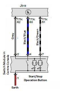

    A quick look at the wiring diagram for the S/S button on the centre console (see extract below) suggests that the factory method for the S/S disabling facility is very rudimentary..
    As is clearly evident from the wiring diagram, apart from the LED circuits for illuminating the S/S button (this illumination occurs both when S/S switch is pressed and when the dash lights are turned-on), the actual S/S disabling device appears to be a simple single-pole, single-throw, momentary switch. It can't be any simpler than that!.
    What appears to happen is that the S/S switch shorts to earth the signal from PIN# 60 on the C socket of the BCM (i.e. J519 in the diagram). The shorting mechanism is done through PIN#4 on the centre console switch module:

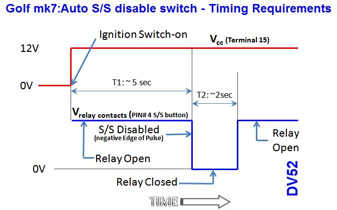

    Preliminary design - Timing considerations
    So, according to the wiring diagram above, all that needs to happen to automatically disable S/S every time that the ignition switch is turned-on is to design a circuit that automatically triggers when "terminal 15" is energised so that it momentarily shorts-to-earth PIN#4 on the centre console switch. Doesn't sound difficult- I hear you thinking (and you are correct in your thinking).
    But, I learned long ago that it pays to be conservative when designing circuits for applications about which little is known. There are (at least) two problem here related to the fact that I can find no information about the characteristics of PIN# 60 on socket C of the BCM:
    1. I'm not sure how quickly the signal from this pin appears after the ignition is turned-on.
    2. More importantly perhaps, I don't know the electrical characteristics of the circuit inside the BCM that produces the signal at PIN# 60, So I'm blind to the ability of this pin to either source, or to sink voltage traces from external switching sources.
    In respect of issue 2, I believe it prudent to provide compete electrical isolation between any external switching device and PIN# 60.
    With regard to issue 1, I believe that there needs to be a "delay period" after the ignition is turned-on before the S/S kill signal is sent to PIN#4 on the centre console switch. The objective of this period is to allow the car's circuits (including in particular, the BCM) to stabilise. For the sake of a number, I have chosen 5 seconds as this period (intuitive guess). I've also (intuitively) decided to make the duration of the S/S kill signal 2 seconds albeit I have noticed when I press the centre console button on my car that it's actually the downward press (i.e. negative edge of the switching pulse) that activates the disabling command.
    So, using a conservative design approach and based on my intuitive guesses, the Auto S/S disabling device needs to have a timing cycle similar that that shown in the diagram below

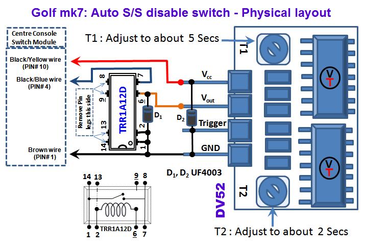

    Preliminary Design - Circuit configuration
    The overriding objective in designing an Auto S/S switch is a low component count. There doesn't appear to be much space in the cavity behind the centre console switches, so I'm keen to avoid the need to jam a heap of electronic components into this area. After a few initial designs, and a bit of research, I was able to locate a monostable oscillator that was available from a well known internet provider (the oscillator cost less than $15 AUD delivered). The oscillator can be self triggered at start-up and it has two variable resistors to provide the timing periods for the initial wait (T1) and for the period of the S/S kill signal (T2). All that was needed in addition to the oscillator was a DIL style relay to provide the electrical isolation that I mentioned earlier.
    Once the device is fitted (and assuming that it operates as designed), the driver is able to re-energise the S/S facility as early as 7 seconds after the ignition is turned-on, if desired. Else, the S/S facility will remained turned-off and it will be turned-off again at the next ignition cycle.

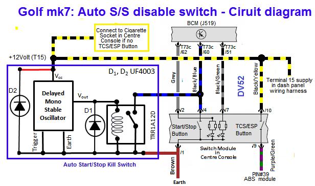

    The full circuit arrangement for the complete device is shown below.
    As can be seen, installation of the device requires the connection of just three wires. I've taken the Terminal 15 supply (i.e. switched +ve 12Volt) for the device from the neighbouring PIN# 10 on the same switch module that houses the VW S/S disable switch (read post #14 of this thread for a discussion on this matter). Hence the three "take-off' points are from the same switch module - making the task of installation and splicing the new connections easier (only access needed is to the switch model in the centre console). If the vehicle does not have a TCS/ESP button on the centre console, attach the +12Volt (T15) wire to the ciggy lighter power supply wire (which will be Back/Yellow as well)
    Please note that the wiring arrangement shown in the schematic above will NOT work if fuse# 40 has been altered to make power to the ciggy socket a permanent 12Volt supply (i.e. the auto S/S disable switch needs a Terminal 15, switched power source to trigger the monostable oscillator and fuse# 40 provides this supply to Pin# 10 on the centre console module).

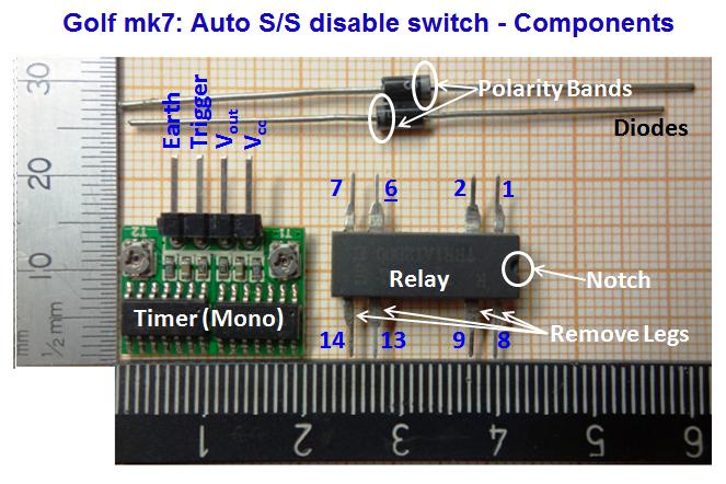

    Components
    The Auto S/S kill switch requires the four items shown in the picture below:
    Other than the Timer (Mono), the items should be readily available at any decent electronics store. The Mono can be sourced from a number of Hong Kong based suppliers as listed below:
    eBay
    Whilst the mono is designed to operate in a number of modes, it is used in this application as a simple delayed one-shot pulse generator with self triggering occurring at start-up. In this configuration, the mono is used as-is without any additional soldering links necessary to the device itself.

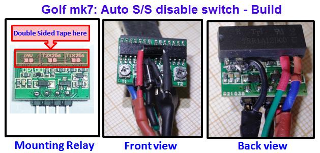

    Construction
    1. Start by completely cutting-off the 4 legs of the relay on pin numbers 9, 8, 13 & 14 as closely as possible up against the relay package (All the legs on this side of the relay are superfluous and they become a shorting hazard if they remain intact)
    2. Solder the diodes to the pins of the timer as per the circuit diagram. Make sure that the diodes are a snug fit against the Mono and it’s very important to ensure that the diode is correctly oriented so that the “silver band” on the diodes face the Vcc and V-out pins - connecting the diodes in the opposite direction will destroy the Mono!
    3. Solder a short wire across the Earth and Trigger pins of the Mono
    4. Place a piece of double sided tape to the rear of the Mono (see pic below) and mount the relay onto the tape so that it is oriented with the legs facing the Mono pins (notch to LHS as per "back view" pic below)
    5. Solder the Earth and V-out pins on the Mono to the relay and attach the three wires that will connect to the centre console switch
    6. Once the components are soldered together, place the switch on a test bench and adjust the potentiometers so that T1=5sec and T2=2 secs. Hook-up a multimeter (on ohms scale) to the relay out wire to "see" the pulse, or use an LED and 240 ohm series resistor connected to +12Volts.

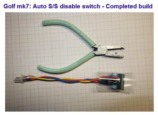

    7. Slip the soldered components into a sleeve of heat shrink tubing to protect the switch
    Way forward- Who can help?
    Having gone this far, and having constructed an initial functioning unit that works well on the test bench, I'm looking for someone who is willing to install and to trial the device on his/her car. The value proposition for anyone interested in helping-out is that I will provide the test unit for free which they can keep EDIT: Forum colleague Mattaus has kindly offered to help out - many thanks

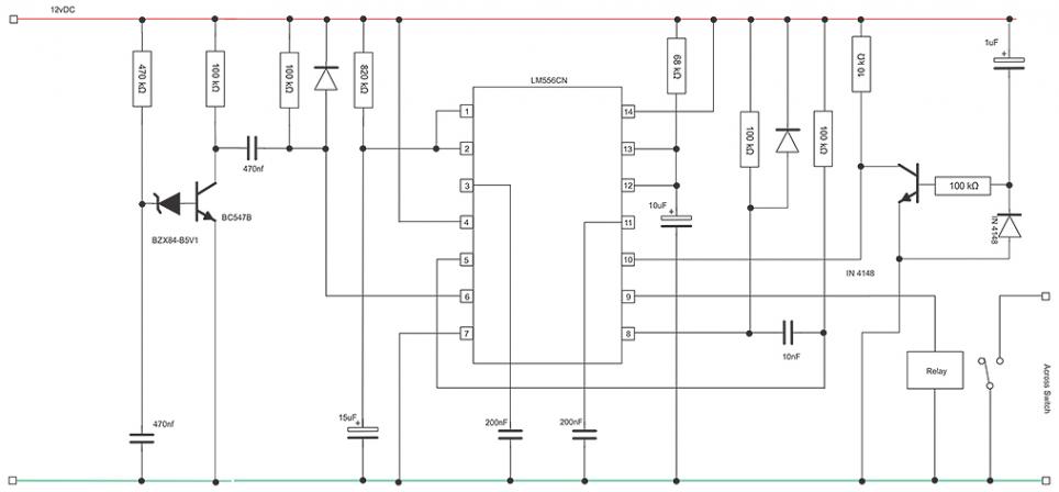

            Interesting Timing , pardon the pun.

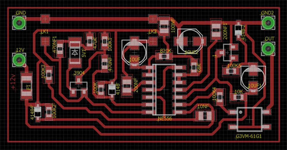

            I've been working on this also while I've been waiting for my car to arrive - hopefully should have the car next week.
            I have a prototype built using a NE556 and a PhotoMos relay (G3VM-61G1) + external timing bits.
            Also similar timing, I think mine is delayed for about 10secs + 1sec relay on pulse.
            Here's my current circuit:-
            I'm planning to do it all with SMD components and this is the PCB layout - single sided.
            It has the NE556, G3VM-61G1 solid state relay for isolation + smd fuse just in case.

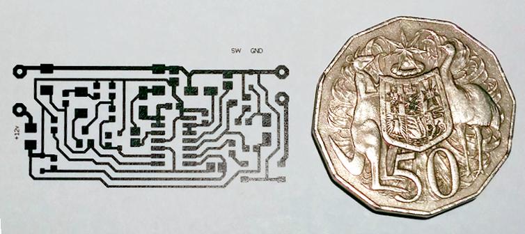

            This is a picture of how big the PCB will be when I get around to making it, it's about 45mm x 24mm x ~8mm.
            I haven't been able to do much more until I get the car.
            Like DV52 has said I'm unsure how quickly the switch is "active" and available when the car is unlocked.
            With my circuit I could delay the timing easily to 1 or 2 mins by a resistor change.
            I've also had to add a lot of external tidying-up circuitry to make sure it's reliable when powering up from a non-perfect power supply but I wont know until I try it in the car.
            At the moment I have it make up on a protoboard so I can see how it will work before committing to a PCB.
              AJW: Hello again. I'm reminded of the old adage "Great minds think alike" - but let's not contemplate the second part of the saying!!
              Sounds like you have done some further thinking since our last discussion and clearly you have much better access to bespoke construction facilities - whereas I've opted for an "off-the-shelf" approach. Just another way of doing the same thing!
              Anyhow its good to see that the Start Stop Kill movement is alive and well in NSW
              Cheers
              Don
                AJW - looks like you're using Eagle there. Any chance I can get my hands on your files and a BoM? I'd be happy to have a set of PCBs made using OPSHPark (cheap enough that making boards at home is just not worth it anymore) and to assemble a few test units (I have reflow gear).
                Actually I'll extend my offer to both you and DV52. Happy to self-build any prototypes you guys come up with.

                      Yes I'm using Eagle to make the PCB. No problems sending up the finished PCB design if you want to make one.
                      I did the circuit in a separate program so I've only got the PCB layout.
                      I'll wait until I get my car before I send up the file as I'm not 100% sure it will work yet and I may need to do some mods.
                      I've sourced all the bits from Element 14 - will give all the part numbers when I know it's working.

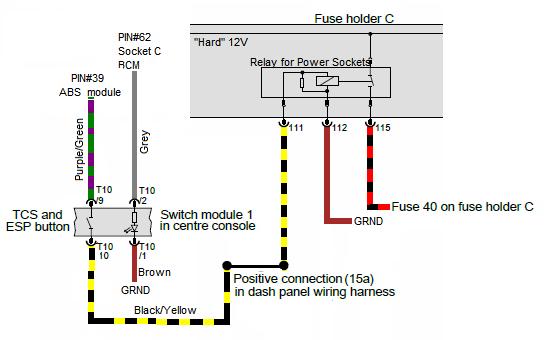

                            Matt/AJW: I've had a close look at VW's wiring diagrams for the centre console portion of the vehicle. After piecing together a number of pages, I believe that there could be a more convenient location (than the ciggy socket) as the source for the Terminal 15 supply.
                            Here's what I have put together from my research (please note that I have removed all other wires from the wiring diagram that I didn't consider relevant to your project):
                            As you can see the crucial new piece of information concerns the wire that begins life as a connection to what VW call the Relay for Power Sockets. These aren't the sockets that we call ciggy sockets, but rather this is the relay that supplies terminal 15 supply to a number of take-off points on the loom inside the cabin (for stuff like the internal mirror, air quality sensor and the ciggy sockets - notice the supply to the relay comes from fuse #40 which is the same fuse as in my thread on how to make the power ciggy socket a "hard" 12 volt supply)
                            Anyhow, the wire of interest terminates on PIN#10 of a 10PIN connector on Switch module 1 in the centre console. In an amazing coincidence, this is the same switch module as the one that contains the native S/S disable switch. How handy is that?
                            I'm not sure if the pin numbers are shown on the switch module but it doesn't matter because all you need to do is to look for the Black/Yellow wire. Even if your car doesn't have a TCS/ESP button, I'm hoping that the Black/yellow wire is present. In fact, there should be a bunch of other of places where the Black/Yellow wire takes Terminal 15 supply. If you find this wire anywhere in the area where you are working, it's likely to be a Terminal 15 supply.
                            To confirm the wiring diagram, you might want to check the voltage dynamic on this wire with the ignition switch on/off using a multimeter before you start splicing a new connection

                              Don. Brilliant! Certainly sounds a lot easier than what I had in mind. Hopefully the wire is where you say it should be
                              I was going to pull my console apart tonight to have a look in there, but to be honest I'd prefer to do it once and once only if I can help it. Thus, I will wait until I have a unit in my hands to test with. I think once I've seen the parts I will just wire it all up as small as possible; that way it will fit regardless, or not fit all. If that makes sense.
