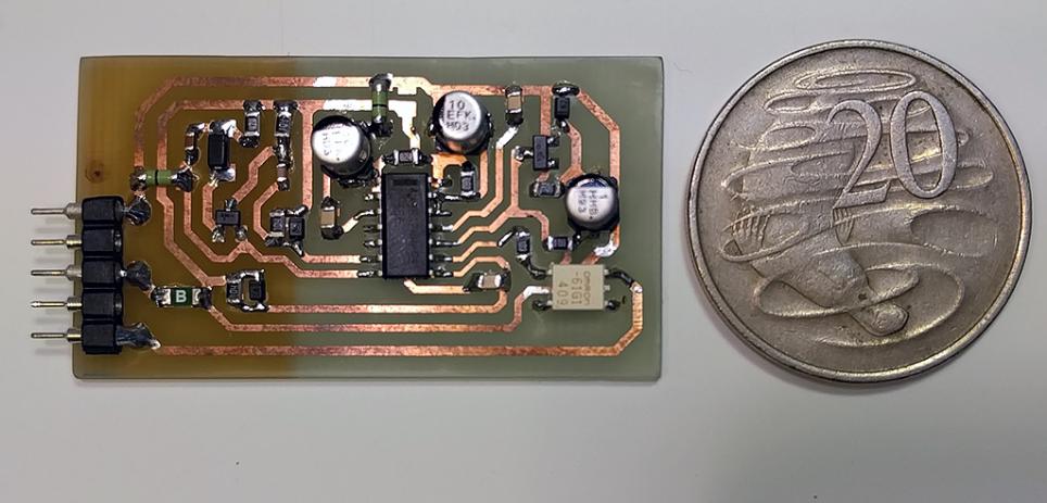

      Here's a picture of my finished PCB with components.
      You can see it's fairly small compared to the 20cent piece.
        Jebus that's tiny! Did you make that PCB yourself? If you used Eagle you could probably get the whole thing down to somewhere between a 10c and 20c piece...in all dimensions.
