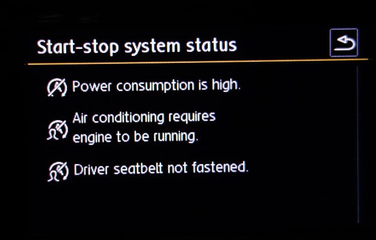

                        • Originally posted by Hole46 View Post
                          Haven’t heard of this before. No problems with my Tiguan.
                          Hole: The "temperature" and "voltage" methods work by fooling the control modules into thinking that either the ambient temperature is too high, or there is insufficient voltage in the battery to restart the car after it is turned off by SS. What happens if either of these tweaks are used is that an "A" with a slash appears on the MFD when the car comes to a stop (it's sometimes called the "SS tweak tell"). Have a look on your Tiggy for this symbol - I think that the "tell" appears over the gear number. This indicates that SS is active, but that it isn't able to engage because some aspect of the car prohibits the function. If you interrogate this "error", the MENU screen will display the first line in the picture below
                          Don
