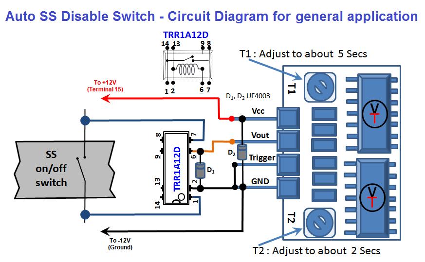

It's real easy to do this -with at most, only a minor alteration to the circuit. What I tried to do in the mk7 case was minimise the number of connection points between the device and the wiring loom in the car. I was able to use the fact that one side of the SS on/off switch on the centre console of a mk7 was earthed. This meant that could use the earth inside the device for the same purpose thus avoiding one connection point in the wiring loom - hope this makes sense.
In the case of the Audi S1 (a very nice car indeed), I'm not sure if the native SS on/off switch is similarly earthed on one side. Do you know if this is the case? If it is (you may need to refer to a wiring diagram), then the mk7 design should be OK. If the SS on/off switch is not earthed on one side, then the circuit below should work
Hopefully it's evident from the diagram above that that device simply connects in parallel with the SS on/off switch in the car. The only change from the mk7 case is that I have removed the internal earth in the contacts of the micro-relay (it's as easy as that).
With the modified design above, the contacts in the micro relay are entirely independent of (and completely insulated from) any other part of the car's electrical circuits. So the device should be able to be applied regardless of the wiring configuration of the native SS on/off switch in the car (as long as this is a momentary on/off switch). But alas, as with all things in life, this modification comes with a catch - an extra wire needs to be connected to the car's wiring loom (there are 4 x connections with this design- whereas the mk7 design had 3).
As to commercial production of these devices - this may be an option in the future! But since the circuit is so simple, why not make one yourself?

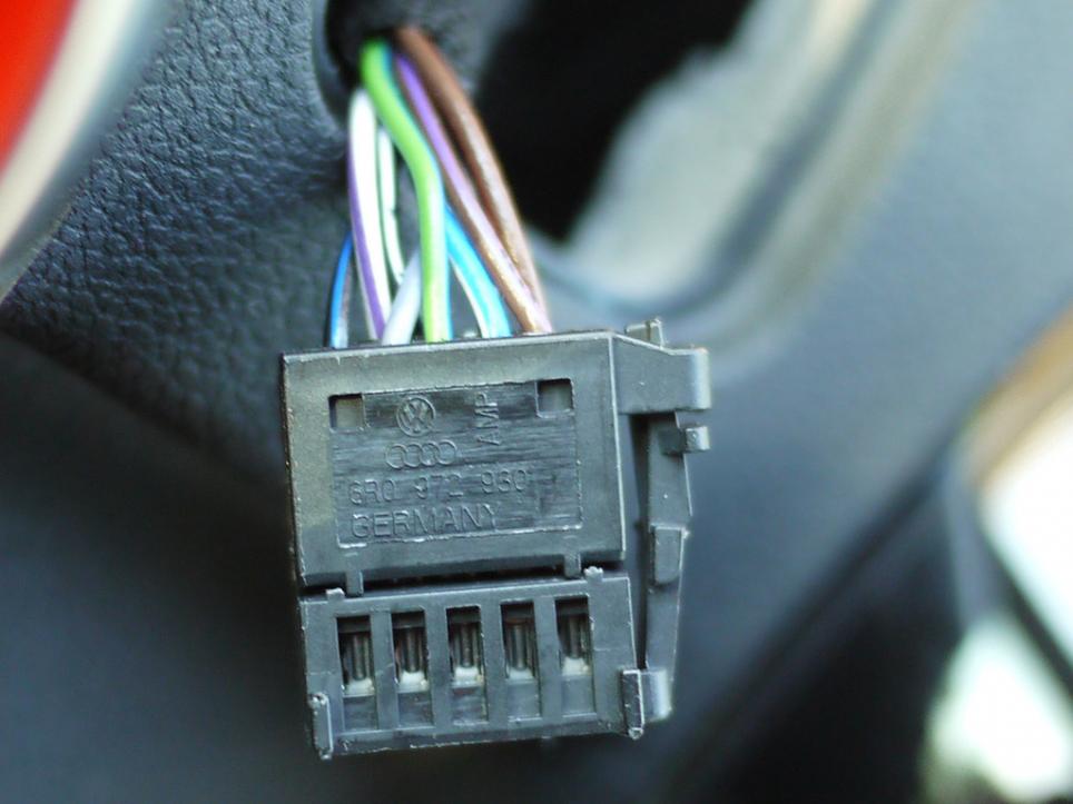

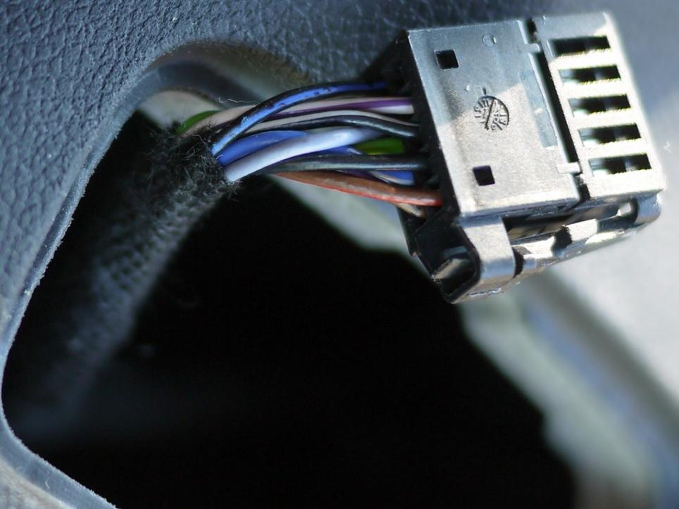

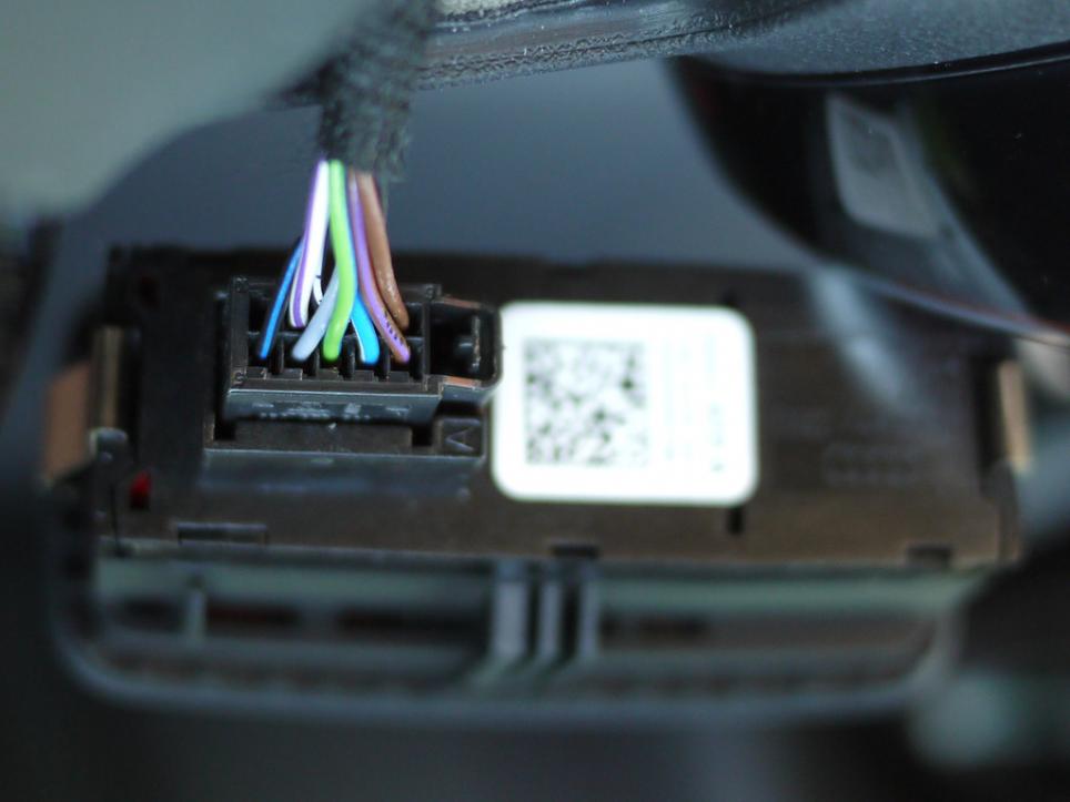

Hi Don, thanks for your informative replyI'm not skilled in electronics and I have only done basic things like strip wires and solder things together but never have I built a circuit from scratch. I did however pull the electrical connector from the switch panel and post some pictures and hopefully you can comment.
Originally posted by Volks View PostHi Don, thanks for your informative replyI'm not skilled in electronics and I have only done basic things like strip wires and solder things together but never have I built a circuit from scratch. I did however pull the electrical connector from the switch panel and post some pictures and hopefully you can comment.

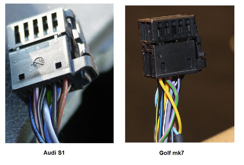

First impressions are that it looks promising! The connectors in the two cars look "not dissimilar" as the pic below suggests (the mk7 pic comes from post #57 on this thread by AJW:
Cleary the two vehicles use a similar set-up (both use 10 pin connectors which look identical) albeit the physical S1 wiring at the connector appears to be simpler (which is a good thing). But the "acid-test" is what the wiring diagram says! If you can get access to a wiring diagram for an S1 - I am willing to have a look and see if it's at all possible.
