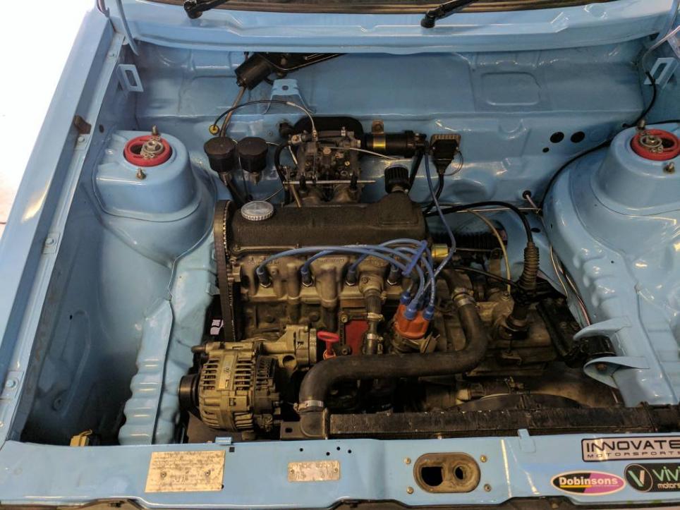

                      • An unexpected alternator failure has lead me to treat the mk1 to a mk3 alternator and starter motor, new water pump and thermostat. Looks, sounds, starts and generally is completely much better than before!!!

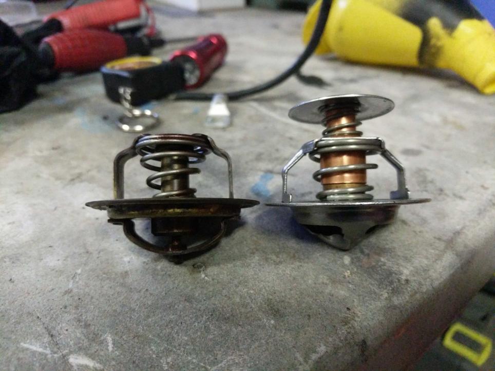

                        However I've encountered an issue with the thermostat. I purchased a Tridon tt2034-180. A high flow thermostat. But as I was bleeding the system and getting her to temp, the water gauge would reach 100° without the fans going off. Odd
                        I assumed the temp switch had failed so I gave it another shot with the fan plugged directly to 12v and the temp would still boil...
                        Here is where I realised the top rad hose would get super hot but the bottom rad hose would be only lukewarm. The radiator too would only get pretty warm but not hot, explaining the switch not kicking it. ****...
                        Pulled the thermostat back out and realised it is much deeper than the original, possibly fouling on the inside of the water pump housing and not opening completely???
                        Anyone else have had thermostat issues in the past???

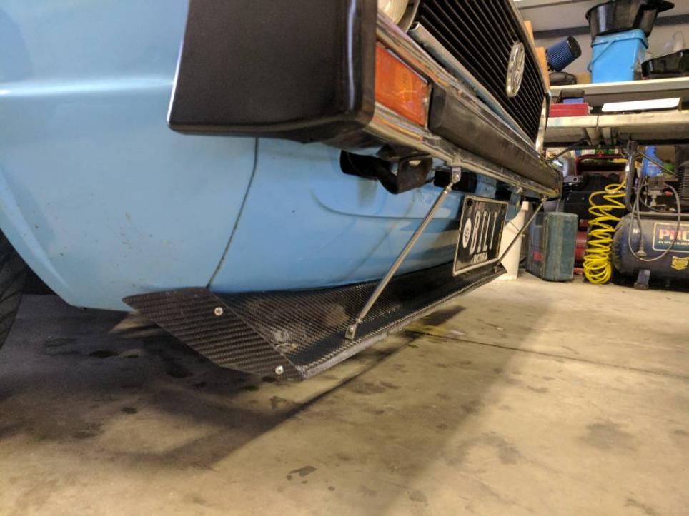

                          Also a close up of my carbon fiber lip I've been toying around with it's still in the works but I've have it fitted for a while nevertheless
