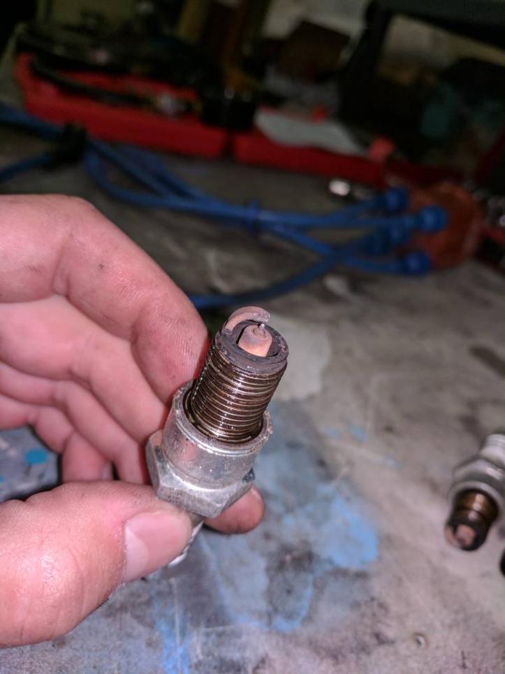

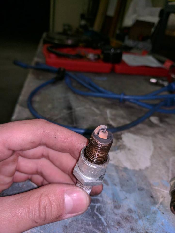

                • So did a little, check of the motor today that included a compression test and a timing light.
                  Cylinder 1: 140 cold / 135 hot
                  Cylinder 2: 136 cold / 125 hot
                  Cylinder 3: 143 cold / 135 hot
                  Cylinder 4: 145 cold / 132 hot

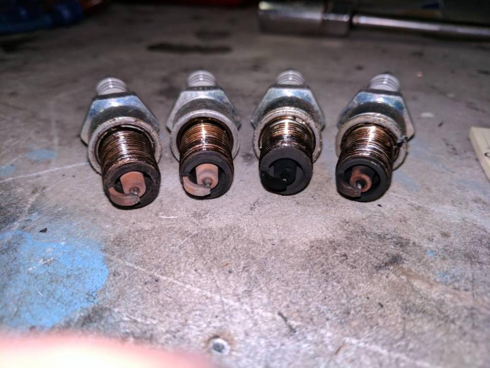

                  The plug colours seemed reasonable but plug 3 was much more black. In all honesty, I have no clue how to correctly ready a plug haha
                  Also had 10° of advance at 800rpm. I am not running vacuum advance due to the fact the canister on the dizzy is shot and it really runs fine without if. I'll be rectifying it in another way shortly anyway. How much more advance can we get out of the 1.8 8v's??
                  All in all, I'm happy the way she runs👌👌
                  Sent from my Pixel using Tapatalk
                  • Number 3 is getting too much fuel or not enough spark to burn the fuel. It's running rich while the others look ok.
                    For the timing, at idle advance the dizzy (turn anti-clockwise) until the engine starts to slow down a bit, then turn it back (clockwise) a few mm until it picks up revs again. Take it for a run. If it pings (rattling sound under load) it's advanced too far so turn the dizzy clockwise a few mm.
                    Trial and error until you've found that sweet spot.
                    Car is still looking awesome.
                    Cheers
                    Paul

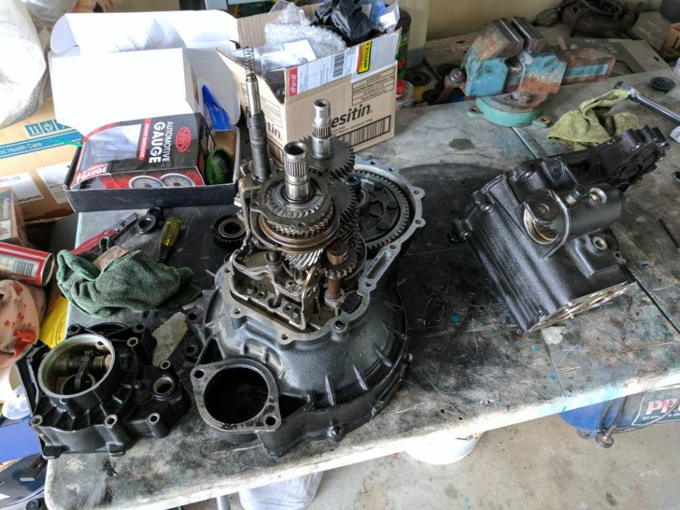

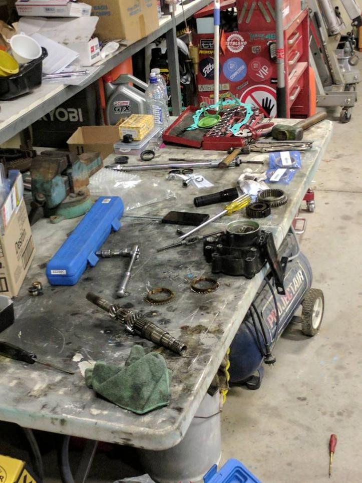

                    • Update on the ragtop

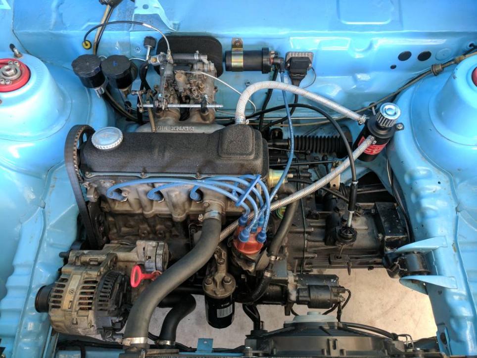

                      Catch can, new thermo switch (old one got stuck on..) and... Drumroll...
                      5 speed!!!
                      Massive thanks to Jordan for pretty much rebuilding it under my supervision and Bryce for letting me use his press for the diff bolts.

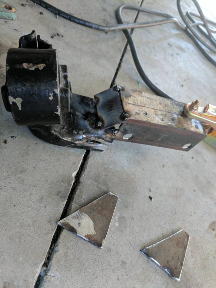

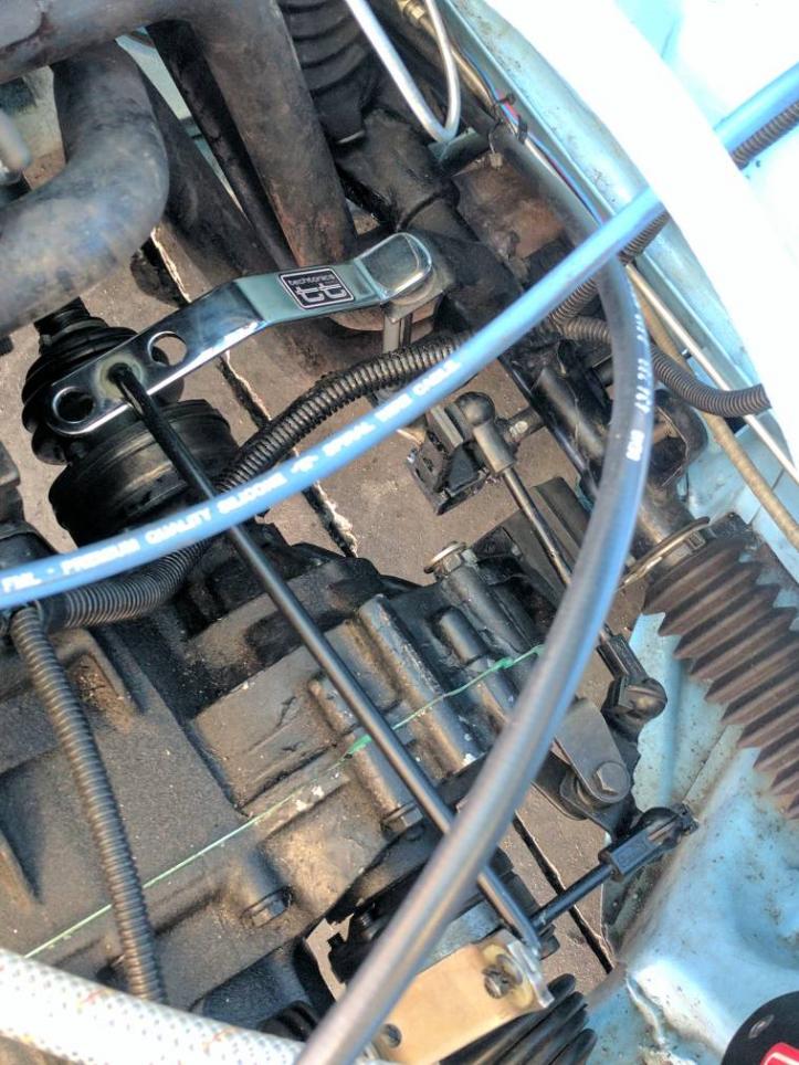

                      Specs? (Correct me if I'm wrong Jordan) it's a mk2 GTI box with new synchros, mk3 3rd/4th synch hub, diff bolts, new linkage bushes and a TT short shift lever. Modded the 4sp mount and linkages to work with the 5speed. Fair bit of fiddling around but hell yess!!!

                        • Very sweet work indeed man Mark and Jordan! You guys need to come to the west and give me motivation haha. What was the point of rebuilding the whole gearbox? Better ratios or? Surely you could have found another 5 speed g'box and mount? I have a 5 speed sitting in the backyard haha
                          - Brown U.S import 81 cabby
                          - 88 Honda crx b18cr
                          • Just for piece of mind. My 4sp was like a chocolates milkshake, only crunchy.. so just wanted to avoid that. I always intended on doing the diff bolt swap so might as well freshen up the box while I'm at it. I could've bought a mount, but where's the fun in that [emoji14]

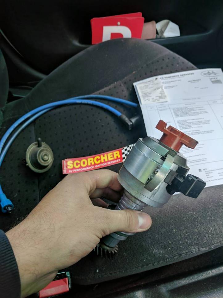

                              Visited Scorcher in nunawading and got my dizzy converted to full mechanical advance, vac canister delete, recurved, rebuilt and ready to go!! Not sure what to expect by hell yeah

                              • Before they touched the dizzy did they take measurements with the car running?
