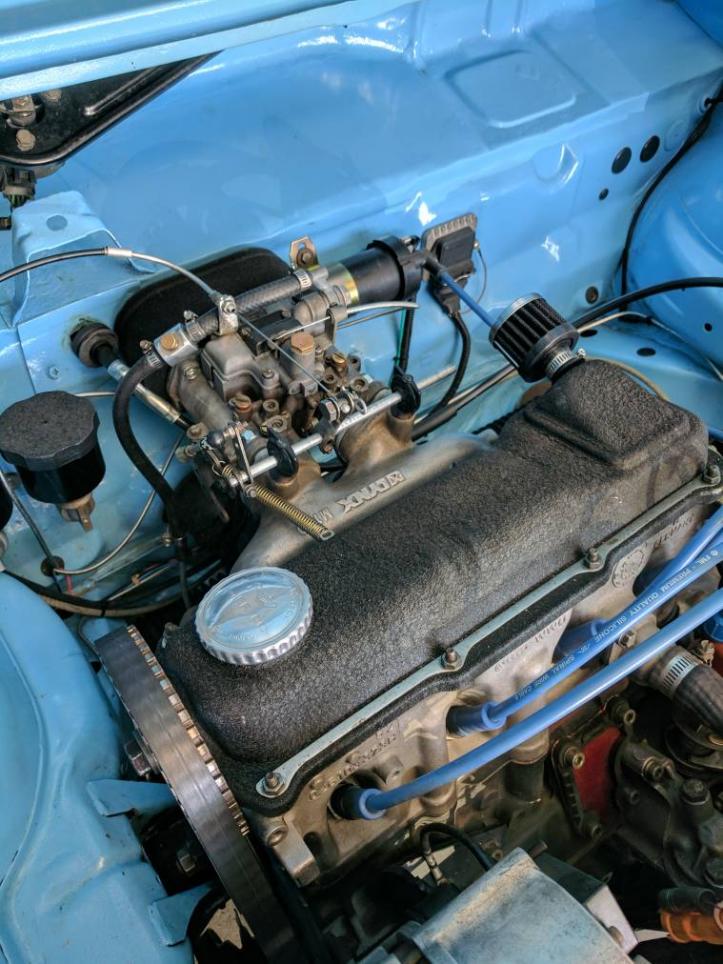

        Well, it's been a good run, but I have some very bad news for everyone.. the mk1 is dead... Almost as dead as the mk1 section or vww lately hahaha.
        On a side note, the ragtop is most definitely not dead yet, but more so alive than ever!

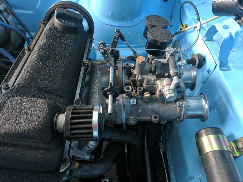

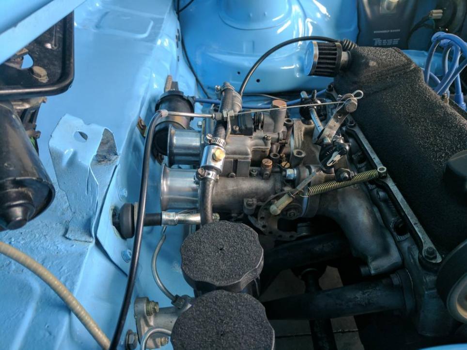

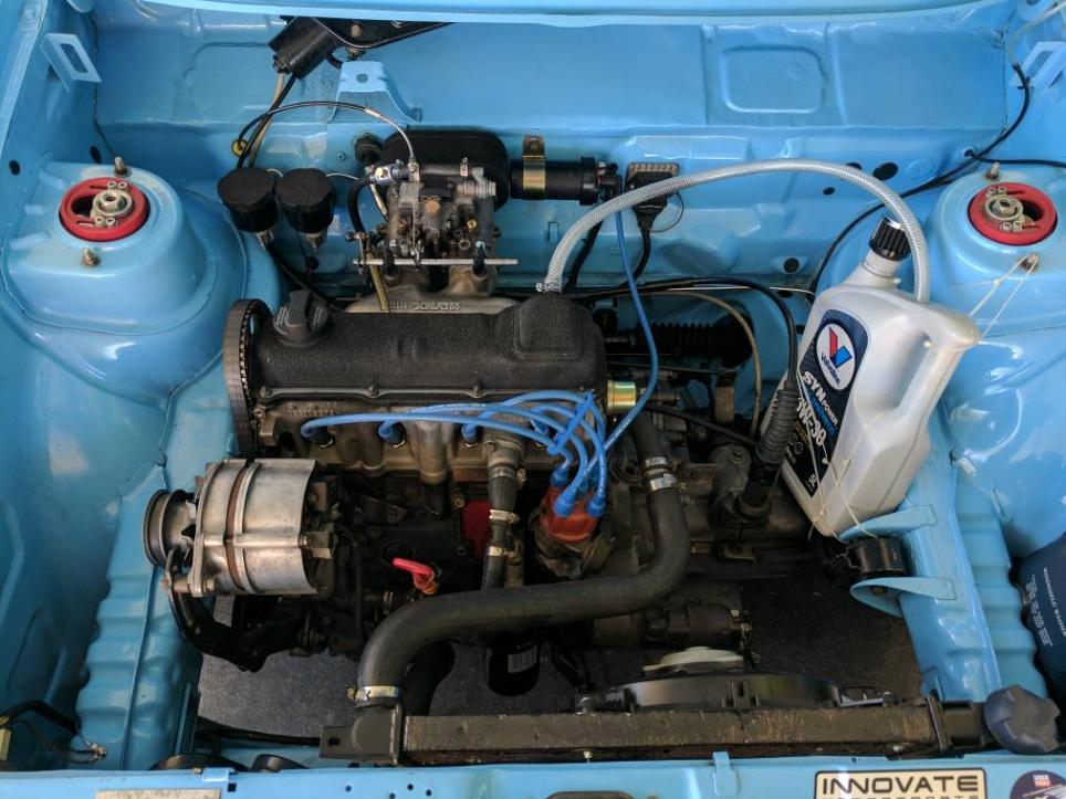

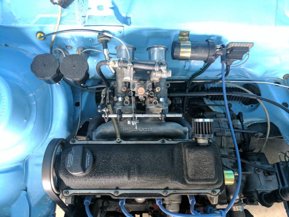

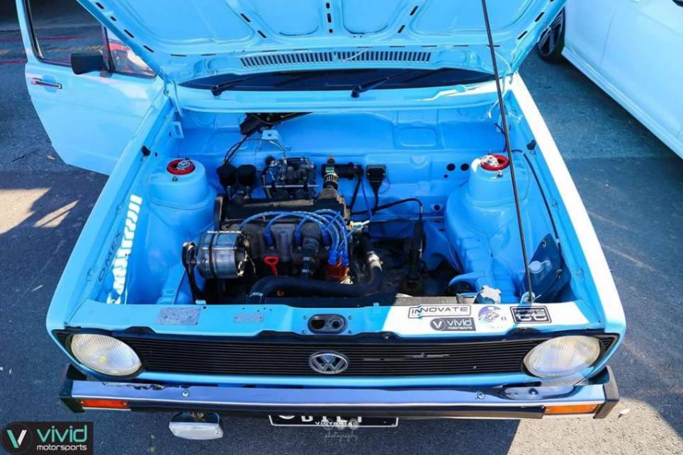

        I have done the most responsible thing by removing the 32/36 and finally biting the bullet and going dhla45!
        This poor carb was in a rather **** condition when I got my hands on it and took a bit of coin to get it all happy days.
        What can I say, the intake noise is quite lovely now )
        I'll let the pics do the talking

        • Looks good man, noise would be epic. Big improvement over 32/36 would you say?

              Personally, very big improvement. The 32/36 is faaaaaantastic, but my biggest issues with it was the lack of induction sound, but more so the transition from primary to secondary. It would hiccup and if you went from cruise to WOT.. or even as your powering out of a corner, it would hiccup once you went from 50% throttle to WOT. The dhla on the other hand has robbed me of a little bottom end power in return for a great pickup of rpm and a perfect scream on WOT. It's very not fine tuned yet but it seems promising

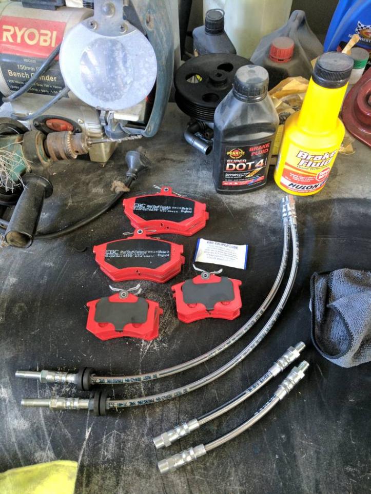

                        Few weak points of the car, however. The pads faded far too quick. The old perished rubber lines looked to be a bit of a worry.

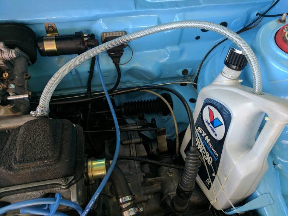

                        Also had to slap together a really ghetto catch can for the day haha

                        -Race pads, braided lines and new fuid

                        -A proper catch can

                              • EBC red stuff, check.
                                Braided lines, check.
                                New fluid, check!
