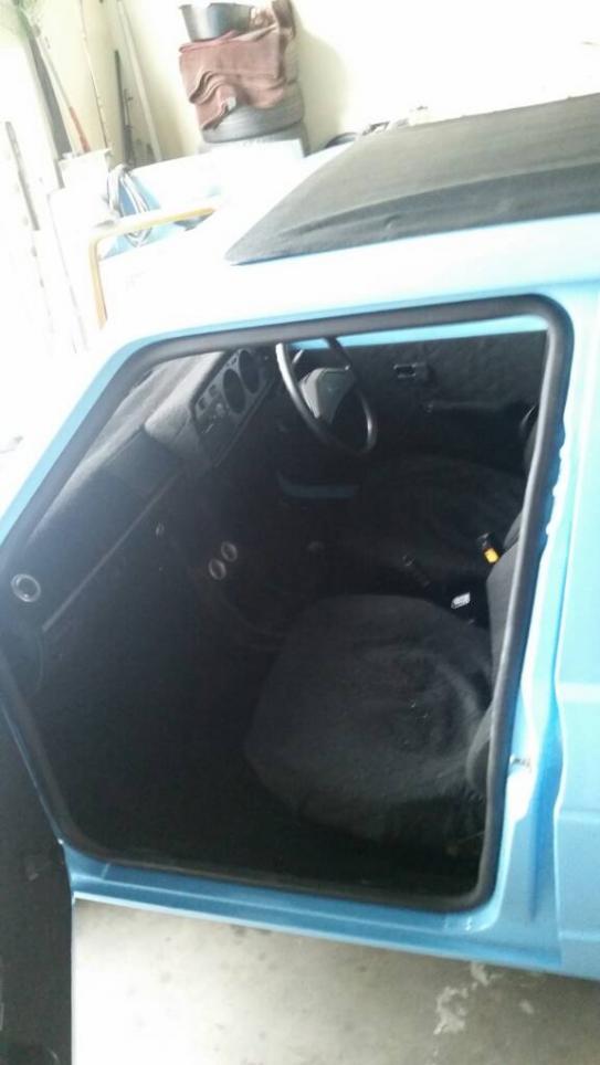

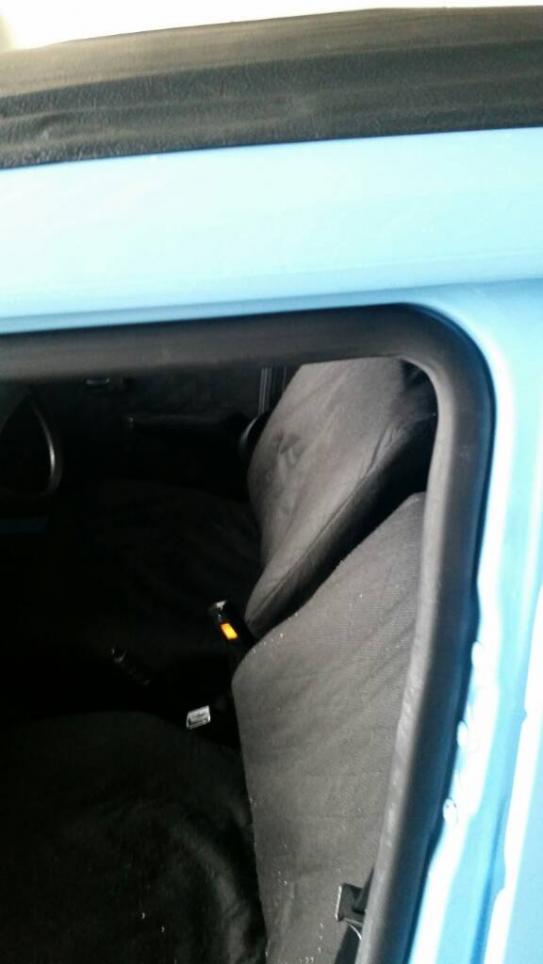

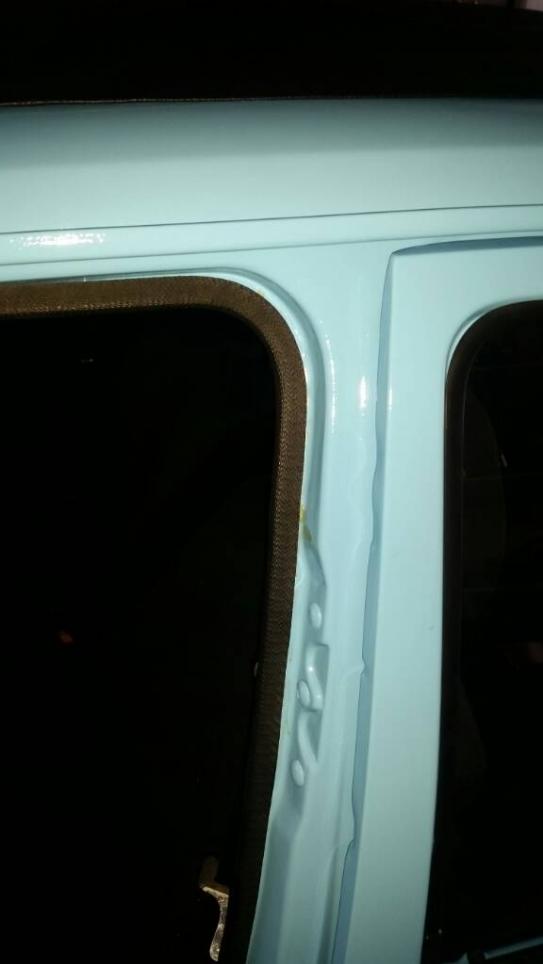

  • Funny thing is, mk3 and mk4 dont work haha. However, mk5 seal sit in the door frame and not on the door so instead of using the standard mk1 U-channel that sits in the mk1 door frame and the seal in the door, i removed the U channel seal and used the mk5 one on its place so no need to use a seal on the door. Just works in reverse
    • so you took the pinch weld off and put one with a seal glued to it? Sound like a good idea!!
      But does it seal property where the A pillar is? And are you running scuf trims at the bottom? Sorry mark hahah I'm a little puzzled as to how the entire door is sealed🤔
      • Ill post a pic tonight, but yes, the entire door seals. I have removed the scuff trims as that's the door gap was biggest (car had a part accident and the skirts are a tad off)
        • Oh and something special for the mk1
          • Ohhhhhhh, so you did the seal on the body and not the door itself, gotcha. Oh and lovely looking seats!

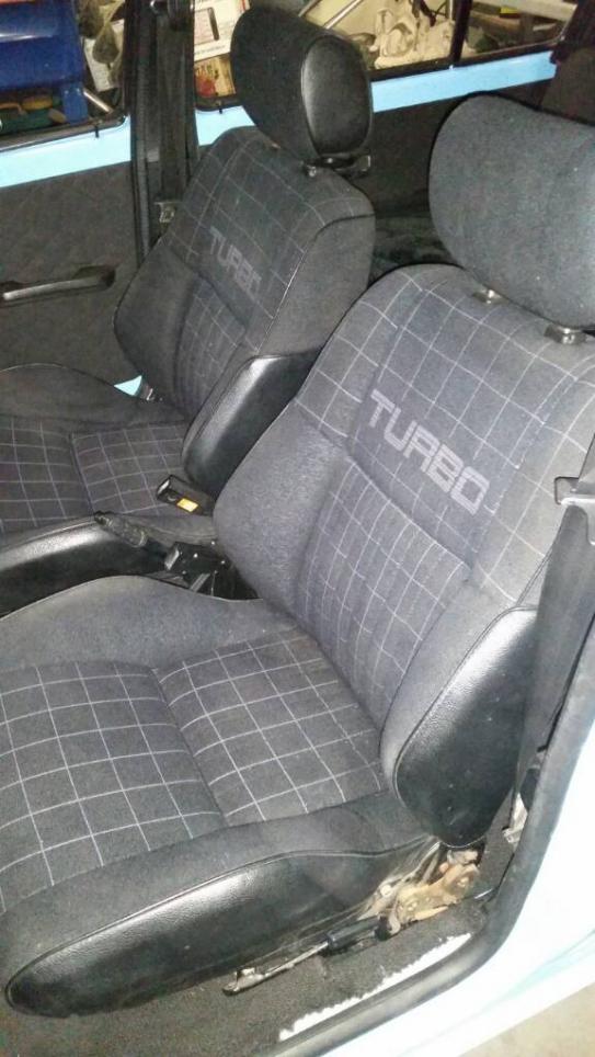

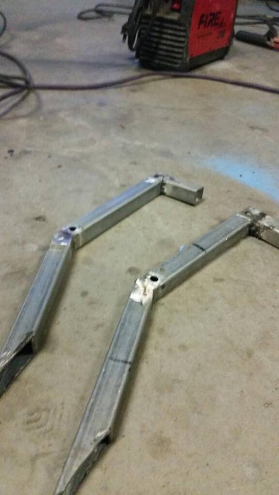

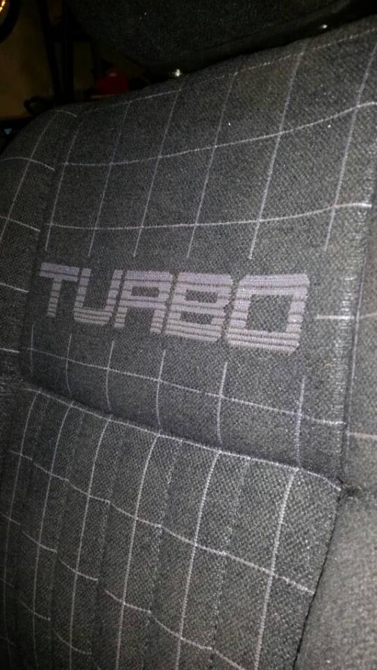

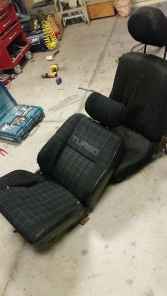

            • So yeah, i was sick of having seats with the lumbar support of a park bench, so this happened, all for under 100$
              • What are those seats out of Mark?
                Also, want to be my weld friend and weld me some **** so i can do that!
                So awesome!

                • Originally posted by mitch750 View Post
                  So awesome!
                  A nissan exa turbo they are amazing seats! I feel so much more secure in them.
                  No stress bro, swing past and we'll weld you up some sick rails haha

                        • Any more pics on the rails you've made?
                          Also.... she's looking lovely man. Perfect height!

                            • Originally posted by GeorgeMK1 View Post
                              Thanks man! I dont have any more photos but i will take a few when i take them out again. They arent perfectly straight so my ocd is screaming "what the heck???"
