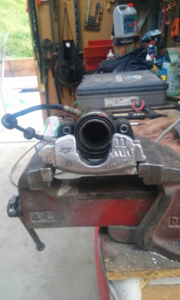

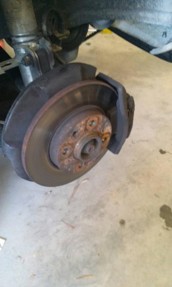

    Oh really?? Can anyone confirm that? I was aware that the vented mk1 brakes used the kelsey-hayes caliper, also called the mk2 type caliper
    • #77
      The calipers are different. The GTI ones are bigger both in surface area and width to fit over the much thicker GTI disks. They use the same mounting points so an upgrade consists of disk and calipers. Standard MK1 calipers won't fit over MK1 GTI disks.
      They make a big difference to the stopping power over standard disks.
      Cheers
      Paul
      • #78
        These calipers will not work
        These will.
        Known as vwii calipers
        Oh and beware, they use different carriers. Which are impossible to get new
        77 Mk1 GLS 2 door - That sinking feeling
        76 Mk1 Swallowtail 2 door - Replace that BMW & 76 Sweetheart
