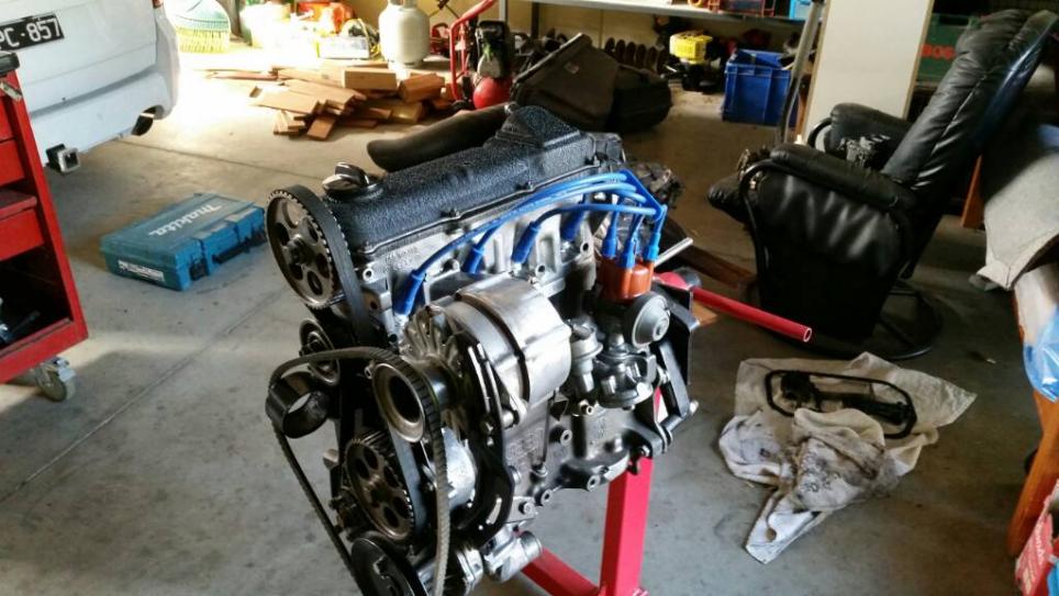

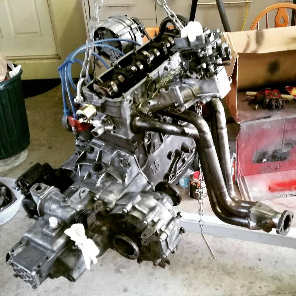

    Ive been focusing my spare time (barely anything ) on the engine. Replacing every gasket, checking every clearance.. to insure as much reliability as possible

        Why are you working on a 1.6 when a 1.8 perks up a Golf really well and they are cheap?
        • #64
          Low kms and Mechanically in good nick. Gives me a chance to enjoy driving the car around until i get a proper engine ready for her

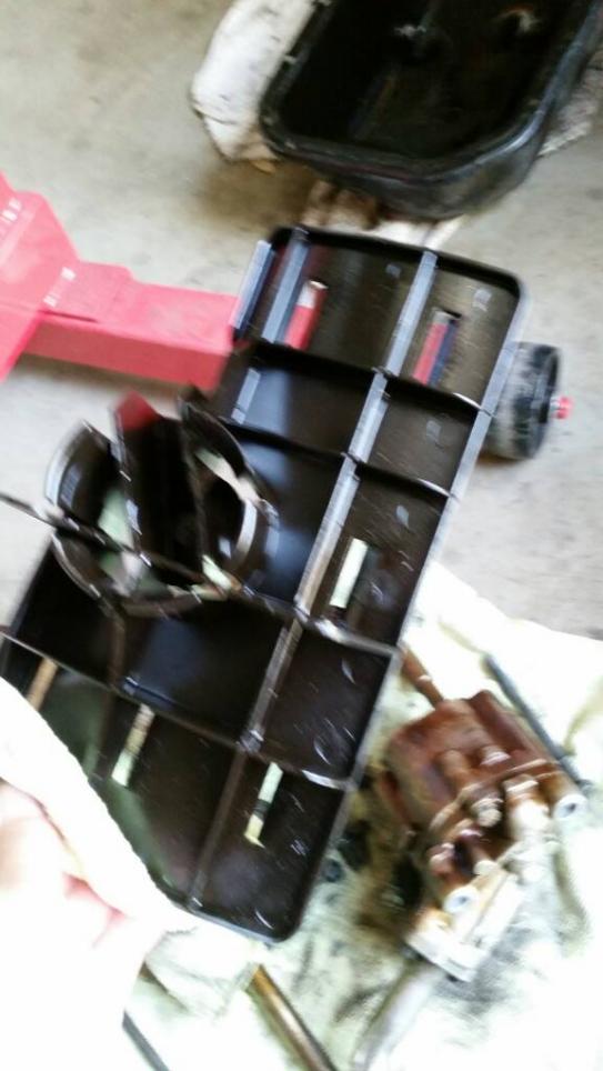

              So this is the shround that sits on mk3 oil pickups. What is it here for and is it worth keeping??
              • #67
                You definitely want to keep that - its a baffle so that your oil doesn't slosh away from your pickup during cornering. Also helps prevent windage

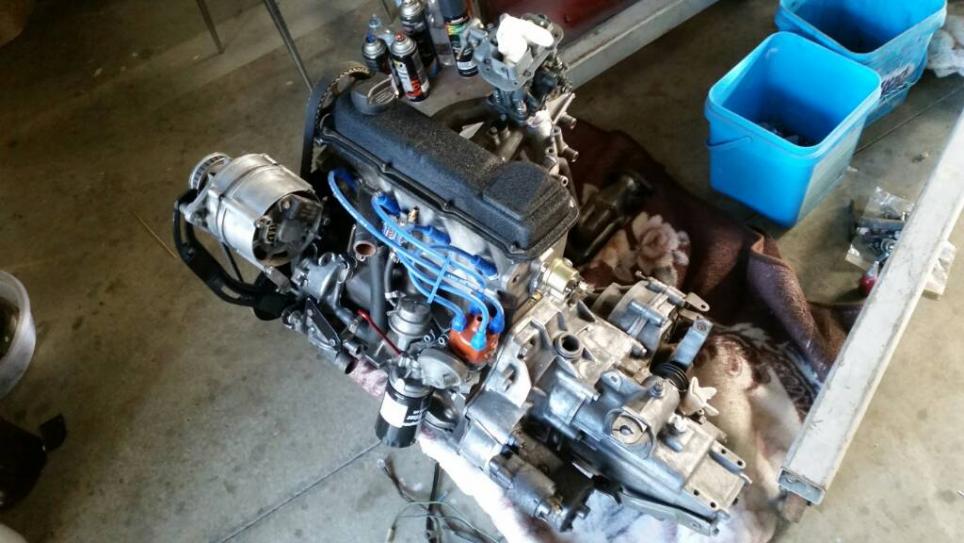

                  Slow progression!
                  Wanting to starr her up once the sump gasket gets here

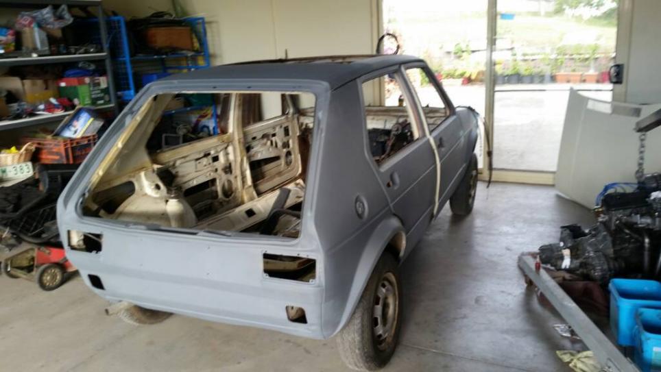

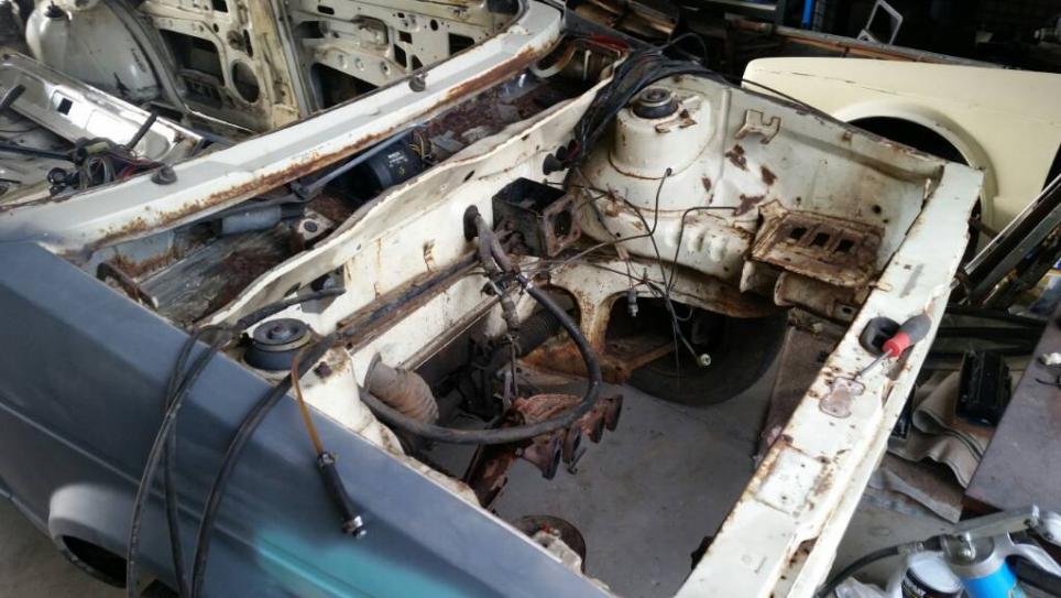

                  • #69
                    A tad more progression. Trying to sort out the wires and tucking them all

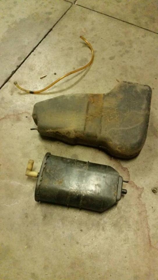

                            So ive come across these 2 canisters. One ive identified as a porsche 914 oem evaporative canister and the other as a vacuum canister in the front right guard. What are their purpose and can i delete them?? Cant find anything in my haynes manual about them
                            • #74
                              They are part of the anti-pollution gear originally fitted to the car. Very old and antiquated system, best to leave it off.
