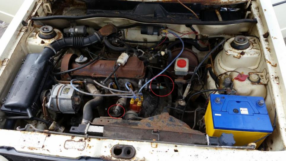

The 2 water hoses go to the heater (under the dash) and back. It's common for a heater to fail on a 35 year old car so some people just block off the rubber pipes. What they should be doing is joining them together so water flows out one and into the other to reduce hot spots in the engine.1978 MK1 2.0 16v http://www.vwwatercooled.com.au/foru...-46488-70.html
