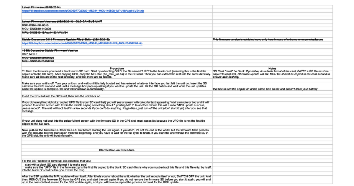

Thanks for all the answers guys. I would love to wait for the DNS to be fully ready before making up my mind, but it seems it could be 2 weeks like 6 months until then so...
Another thing about the low BT streaming quality reported in the spreadsheet, do you guys all have this issue or is this hardware related and only appears on some units?
I've had it on both units (Preproduction and Production).
I feel like its a software issue though, as if it's not being correctly compressed/decompressed/decoded or something, I can't imagine it's a hardware thing since it should use the same BT module as all the other units. My Eonon unit in my Prado, for example, is crystal clear.MY10 Golf Mk6 103TDI DSG Candy White | Revo Stage 1 ECU Tune | 18" Talladegas | GTI Front/Rear/Exhaust | R LED Taillights | GTI Steering Wheel | VW Discover Media | Focal IFVW Front Speakers | Mk7 Climatronic Panel |

DNS is working pretty well for me now, with Sygic, bugs list is dwindling, only a few things left to deal with (chiefly BT Playback/MFD stuff, I couldn't care less about the CD issues though lol). Still yet to see their media library thing, who knows.
Andy's unit, i've long suspected, like kwalsh's, is probably defective, he's had issues that I've never seen *shrugs*MY10 Golf Mk6 103TDI DSG Candy White | Revo Stage 1 ECU Tune | 18" Talladegas | GTI Front/Rear/Exhaust | R LED Taillights | GTI Steering Wheel | VW Discover Media | Focal IFVW Front Speakers | Mk7 Climatronic Panel |
