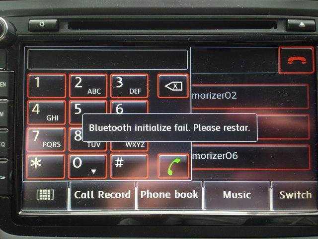

I am also getting the Bluetooth initialize error as above, iPod is no better, and still no GPS , it just keeps saying set path and it won't let me set the path, anyone else having the set Gps path problem, I played with this for over an hour and still no GPS

I'd say try flashing to the May firmware (still linked on the first page), I found that much more stable, to be honest.Originally posted by fashionimage View PostI am also getting the Bluetooth initialize error as above, iPod is no better, and still no GPS , it just keeps saying set path and it won't let me set the path, anyone else having the set Gps path problem, I played with this for over an hour and still no GPS

anyway Ill try and flash back to the may firmware, this bluetooth connection thing is very annoying.
Heres the link to the video
Flashed back to the May firmware and everything works again (ie BT and MFD work as normal). Yay.
