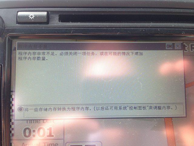

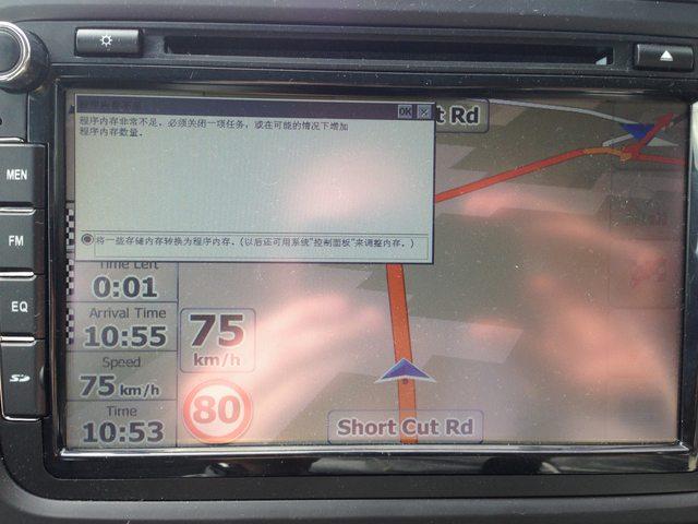

                              • So, had this interesting error today, no idea what it means:
                                Playing music via SD (FLAC, ~1hour long single track album ~500mb or so) with Nav ontop. Unit locked up, had to soft reboot it. Before it, SD playback was working fine, pretty quick, and after the crash its now all slow. Ugh.
                                Edit: oh, and before you ask, I had stopped at my destination when I took those photos, the unit had just frozen :p (inb4 why are you taking photos with 2 hands at 75kmph :p)
                                Also, bluetooth is completely ****ed. No ****ing idea why, because it worked perfectly in the May software. Grrr.
                                Phone connected via iPod connection and playing that way (also happens with SD, and with Nav running), connected to BT, phone will ring, unit will pause music and then start playing it again straight away, doesnt show BT screen like it should, then if you answer via the phone (due to the way iphones work) audio is routed to the phone instead of the unit, or if you go to the units BT menu while the phone is ringing, and answer via that, audio is routed to BT on the phone side, but music continues to play on the headunit instead of the phone. Dafuq?
                                So the only way to get it to work properly is, before you get a call, go into the BT menu, which pauses the music, and then initiate a phone call. Which is retarded.
                                What used to happen was if you got a call, the unit would pause music, switch to BT screen (would switch to BT screen even if you had Nav running), then when you hung up, it would play music from where it paused, and if you had Nav running, would switch back to that screen.
                                Hopefully its just a software bug, but it basically makes the BT function useless. Very irritating.
