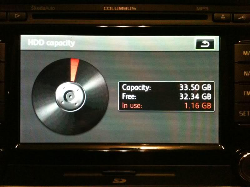

                  i thought i had a 30gb hdd with my columbus (rns510) - but after installing the custom 402x firmware, which i believe is 5/5/95 in terms of partition ratios, it shows i have a capacity of 33.50gb.
                  does it mean i have a 40gb?
                  but then again, 95% of 40gb is 38gb - so that can't b right?!??!
                  i've installed my maps (v5) already. still in the process of copying my music back.
                  prior to the firmware upgrade, i had 20gb capacity.

                    Yep it's a 40gb drive. Take into account file system overheads etc 38gb useable is about right.
                    Mine was a 40gb drive before I replaced it with a 64gb ssd.
