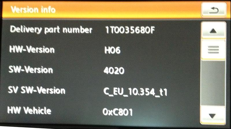

How do I find out what revision of hardware my RNS510 is?
There are two methods (well three):
1. Interrogate the unit with VCDS
2. Use the 'secret menu' on the RNS510 to have it tell you itself
3. Take the unit out and look at the sticker on the outside.
Refer to Accessing the Setup Menu on RNS 510 head units with firmware version 2660 / 2662 / 2664 / 2666 / 2668 | my-gti.com for how to enable the secret menu if it doesn't work by just holding down the setup button for 20 seconds.
See the following link for a list of known part numbers:
RNS510 Part numbers

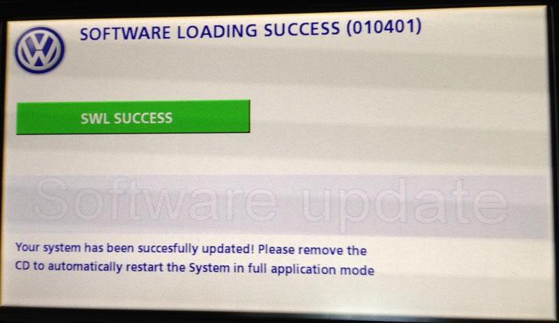

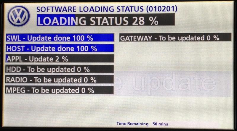

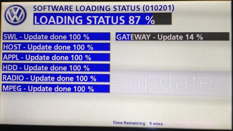

Installation instructions:
1. Firstly, have your VW map DVD on hand ready to install. You will need this to reload the mapping data onto the RNS510 hard drive.
2. Download the .iso file from the links above. Burn to a CD at the SLOWEST possible speed using a program such as imgburn. The RNS510 units are notorious for being very picky about cd media. If your firmware load fails, its more likely than not that it just can't read the CD. Try again with a different brand of CD, try a different burner, or use a DVDR. NOTE: I have had good success with burning using xpcdburner onto TDK CDR media using Track At Once recording method.
3. Unlock the car. DO NOT put the keys in the ignition. Turn on the RNS510 and let it start up. Insert your firmware CD and follow the instructions on the screen. The unit will reboot a few times. The whole process can take an hour.
