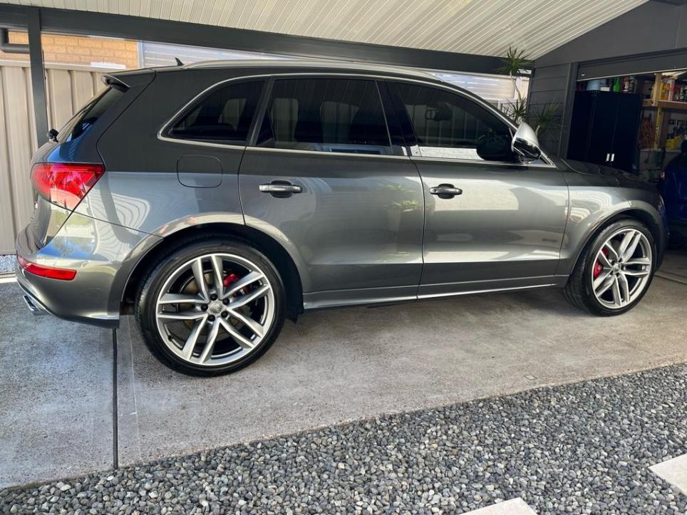

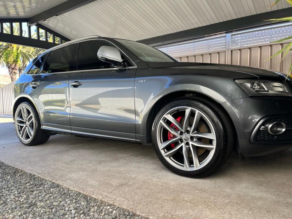

      So the SQ5 finally rolled over 100,000km at the start of July. It will be getting a 'birthday' service in the next few months in the way of a gearbox and differential(s) service, but I have wanted to freshen up the wheels for a number of years, because the original wheels had a few marks on them (the biggest one being my fault doing a late night hurried u-turn and misjudged a gutter) and the clear coat was starting to fail on them in a few spots. They looked fine from a metre or two back, but im very fussy and they were annoying me.
      I got a verbal quote from a highly regarded wheel refurb place on the Central Coast for $450 per rim to fix marks, re-machine the face and paint + clear coat each wheel. I decided that id rather get some new OEM+ rims and then sell my original rims.
      So I found some brand new rims from a Audi Q7 SLine which are 21x9.5 ET31, so 1 inch wider than the SQ5 rims and 2mm different offset (factory SQ5 rims are 21x8.5 ET31). They are a very similar design but slightly different which gives the car a bit of a fresh look and also makes it look a bit different to all the other SQ5's.

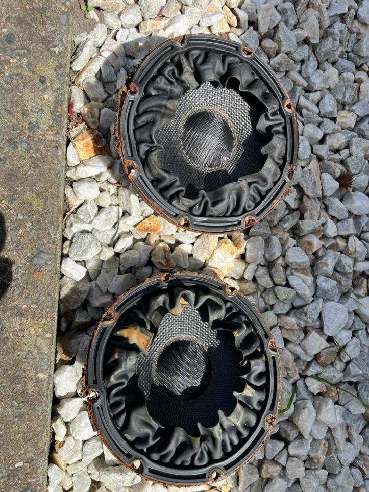

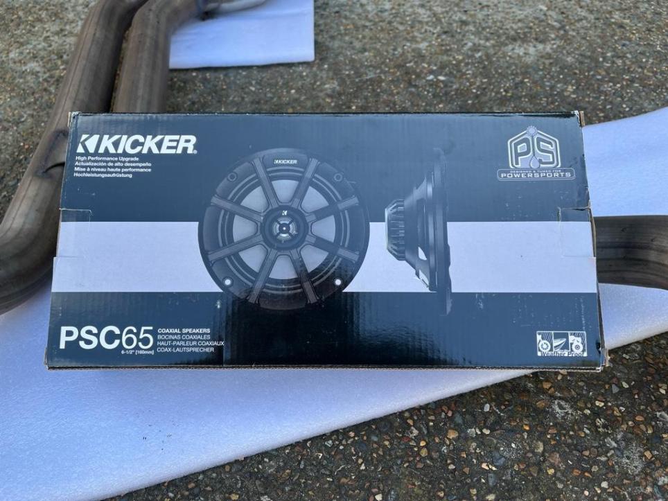

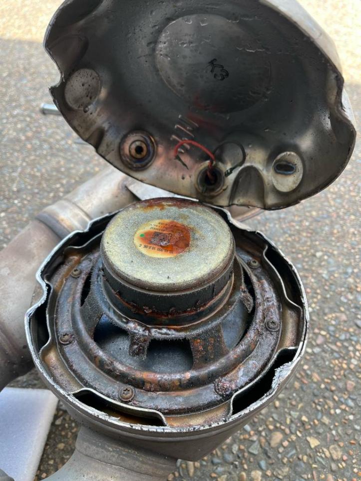

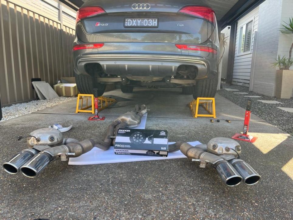

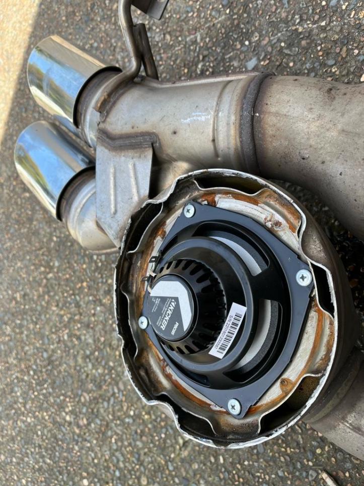

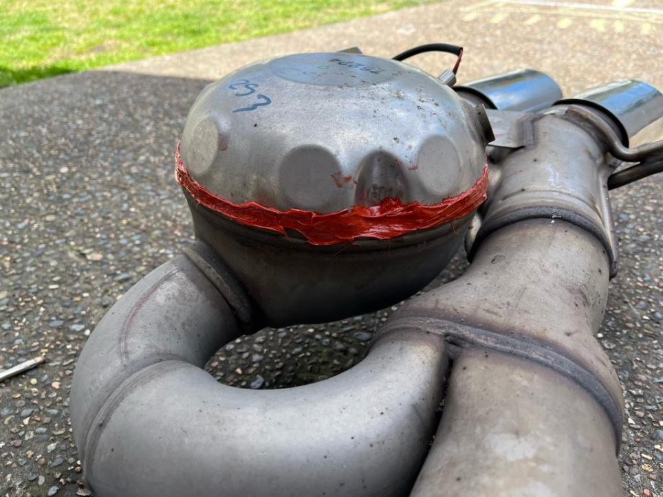

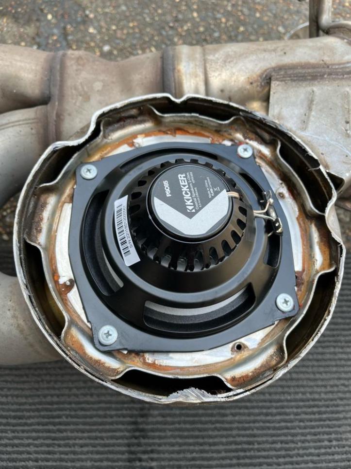

          Something ive had on my 'to-do' list for a few years now - albeit a low priority, was to repair the blown exhaust speakers on the SQ5. Exhaust speakers you say.......yep, something the diesel SQ5 as well as various other 'performance' diesel vehicles have fitted to the exhaust to artifically enhance the sound of the vehicle.
          In the case of the SQ5 the exhaust speakers are very common to fail - less so on other Audi models (eg Audi A6 or A7 with the same engine), presumably due to the exhaust design perhaps more water can enter the chamber where the speakers are located and then it causes rust?!?! Anyway, the speakers completely rust into oblivion and the speakers themselves 'melt' for lack of a better word. I do not understand how the speakers melt because these chambers do not get hot like the rest of the exhaust, and have very little gas flowing through them - I can only think of 2 reasons:
          1) Steam from water that has pooled in the bottom of the enclosure that cannot get out causes moisture and the rust issue.
          2) When the car is doing a DPF regen and the exhaust gets much hotter than usual and the car is pottering around town at a low speed, the steam in the speaker enclosure gets super heated and contributes to melting the speaker over time.
          To try and prevent this issue reoccuring, I have drilled a small 5mm hole at the lowest point in the speaker enclosures so that any water can drain out with gravity and the small amount of gas that flows through the enclosure will help push any moisture out. And while I cannot speak for the original owner of the car, in my ownership I make sure that regens are performeed when the car is moving at a good speed (motorway/highway) whenever possible to ensure good airflow over the exhaust to keep temperatures down as much as possible.
          Process: Jack up car, disconnect exhaust clamps just behind the DPF, remove rubber exhaust hangers and remove exhaust from car. Using an angle grinder, cut open the speaker enclosures to reveal what used to be a functioning speaker. Drill out the rusted bolts securing the speaker and and replace it with a 2ohm 6.5" marine grade speaker. Fix up the wiring which has also rusted, and then re-attach the speaker enclosure with hi temp silicone sealant and then paint black to look neat and uniform. Repeat for the other side.

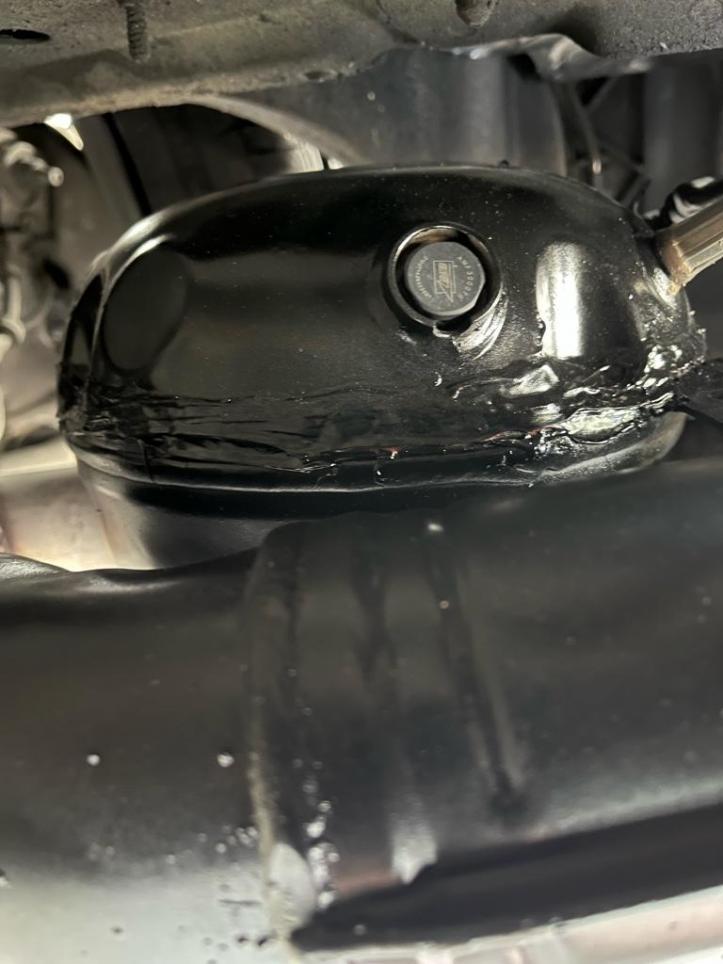

            Time has come to start servicing the transmission and driveline on this car, as its now done 100,000km. I was going to get my independent VAG specialist mechanic to do it, but I think id prefer to do it myself and then I know its actually been done (yes I have trust issues when it comes to paying people to do work on my car...) and I know what oils etc have been used.
            Usually I would buy all the oils locally through VAGParts or RunAutoParts, but these oils are stupidly expensive (centre diff oil is $280 for 1L to buy in Aust!!!) so have bought all of the oils from ECS Tuning and saved a few hundred dollars.
            For the transmission id rather pay for the genuine ZF Lifeguard oil because you can never flush all the old oil out, so at least the new oil being introduced is the same formula as the existing oil.
            - ZF 8 Lifeguard oil for the gearbox (Part # 83 22 2 289 720)
            - ZF 8 filter and gasket kit (Part # HX189KIT)
            - oil for front and rear differentials (Part #G052145S2)
            - oil for centre torsen differential (Part #G055145A2)
            Rear diff serviced as all other oils on order still.

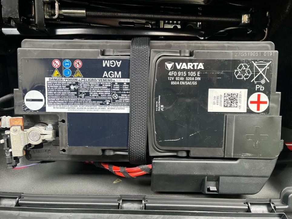

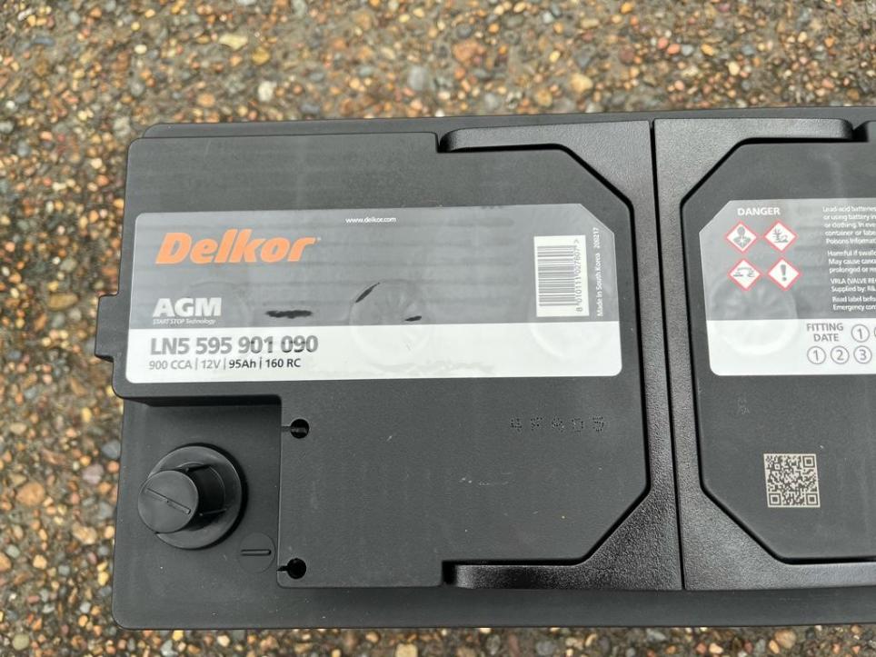

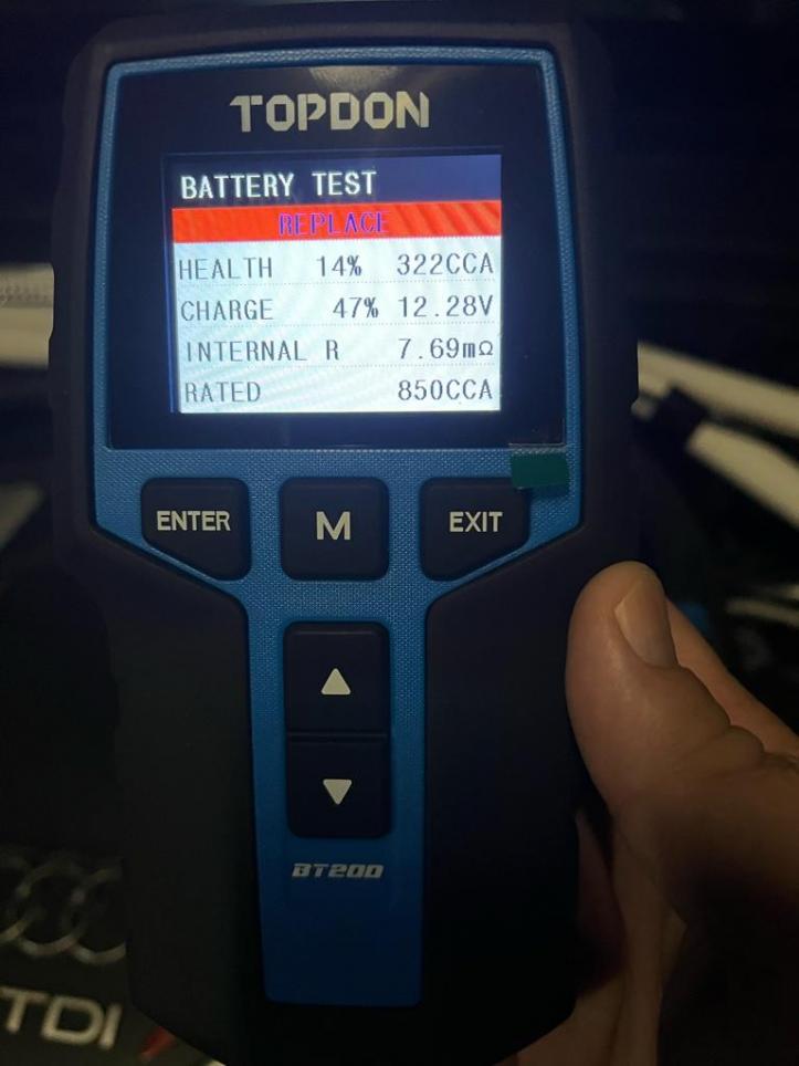

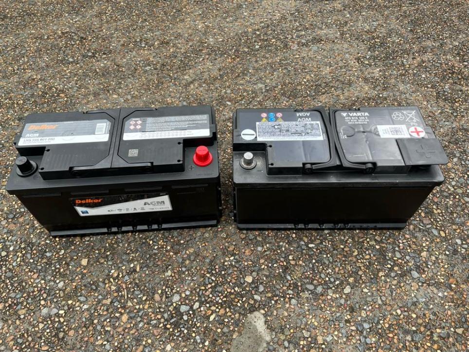

                            Well after 10 years the original battery in the SQ5 was starting to die. Having noticed various symptoms over the past month or so such as being lazy to cold start and the mirrors not always folding in/out when unlocking/locking the car, I hooked the battery up to a tester which revealed the original battery was on its way out. (battery health 14% and only showing 322CCA when it should be 850CCA)
                            New Delkor AGM battery was sourced and fitted this week. New battery is healthy and showing 92% health and 863CCA. The car is much more eager to start now - something you dont really notice getting worse as the original battery was slowly dying.
                            I do regularly hook both my cars up to a Ctek battery maintainer, but the battery was always going to die one day. Best to change it now before it leaves me stranded in the dark one day soon.
