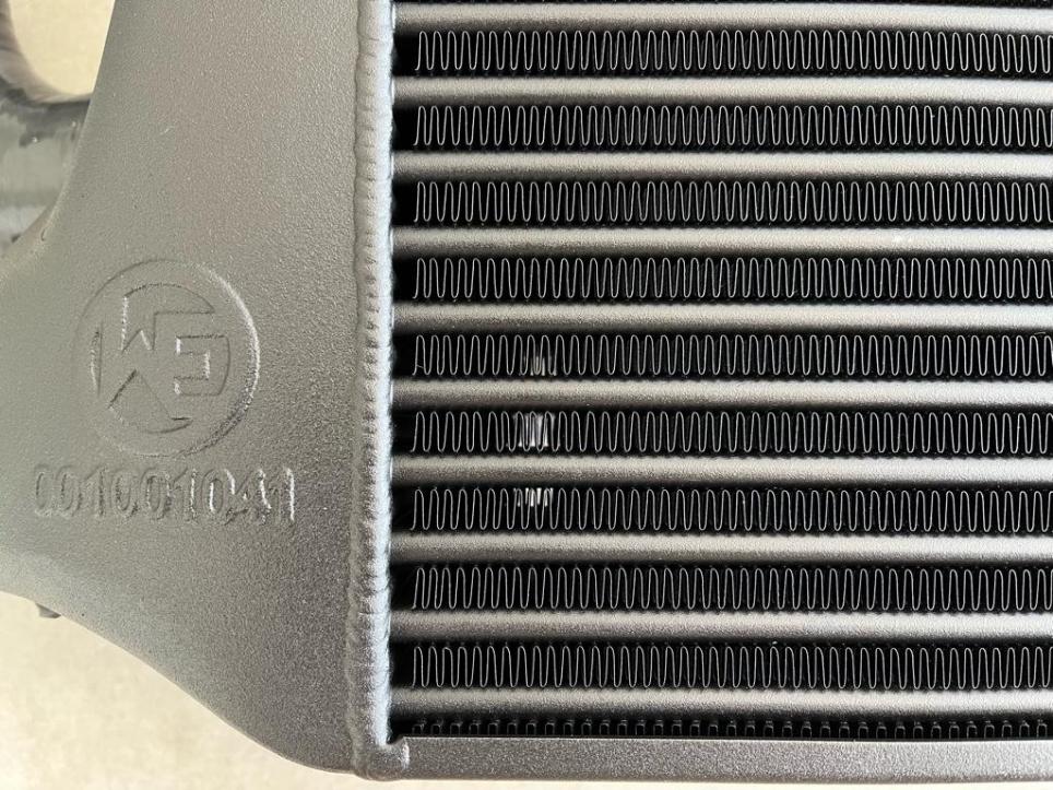

Next mod which i have wanted to do for a while. While the intercooler fitted to the SQ5 is a decent quality all alloy unit with a pretty good quality core for an OEM intercooler, there is still room for improvement.
Most people go straight for the Wagner drop-in replacement, and I certainly considered this heavily, but they are stupid expensive ($2.2k locally, but about $1.7k if you order from the UK). There are a few other brands lurking around (AIRTEC and HF Series) too which I considered. The AIRTEC is actually made for the Audi A6 with the same engine, and while it "should" fit, AIRTEC could not guarantee it would fit the SQ5 without modifications. And the HF Series looks very much the same as the Wagner, but I could not find a shop that would send to Australia.
The other option is the budget intercooler from Darkside Developments. My brother quickly talked me out of this one after pointing out that its just a poor quality $100 ebay intercooler from China with mounting hardware and pipes welded on to suit the SQ5.
Wagner: Wagner Tuning Audi Q5 SQ5 Competition Intercooler Kit 3.0 TDI - 200001 – Performance Brands
AIRTEC: AIRTEC Intercooler Upgrade for Audi A6 3.0 TDi Bi-Turbo - AIRTEC Motorsport
HS Series: HF-Series Intercooler For Audi Q5 Incl. SQ5 3.0 (Bi-)TDI - AKA Performance
Darkside budget: Darkside Front Mount Intercooler (FMIC) for 3.0 BiTDI Audi SQ5
My brother runs a small automotive metal fabrication business (see link below to his business) and has an account with Garrett, so has access to Garrett's high quality intercooler cores - so I spoke to him and we decided to make a custom intercooler upgrade for the SQ5 with custom end tanks. The goal is to have a locally made kit for the SQ5 that he can offer for sale on his website.
Personally I would have liked a bigger (taller) core, but Garret's bigger core is 600mm wide x 300mm tall and there is no use having a 300mm tall core on the SQ5 because the crash bar would cover the extra 10cm and it would get no airflow so would be next to useless. So we have kept the core below the crash bar for best airflow through the core.
So the new intercooler is ready for a test fit before we finalise pipework and mounting hardware etc. The new intercooler is only slightly larger in overall volume/capacity (just over 12% more volume to be exact) to the stock one, but has a much better quality core. The core is rated for around 500hp at this size so it will be more than enough for a 350hp stage 1 SQ5.
The new core is about 10cm narrower as Garrett only make 600mm wide cores (factory core is about 75cm wide), but its about 3cm taller and 2.5cm thicker.

That's a nice looking piece of kit Lucas, looks very well put together - be interested to see how you find it operates in practice!
As you say, a 12% increase in overall volume is relatively modest, but I'm not familiar with the relative impact of core quality?

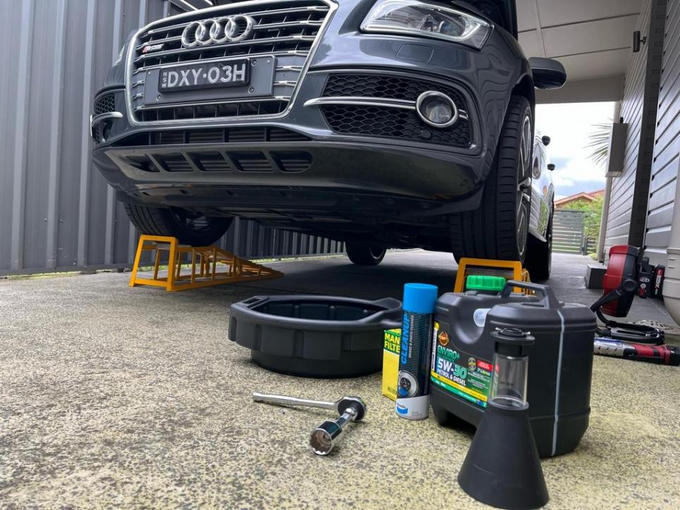

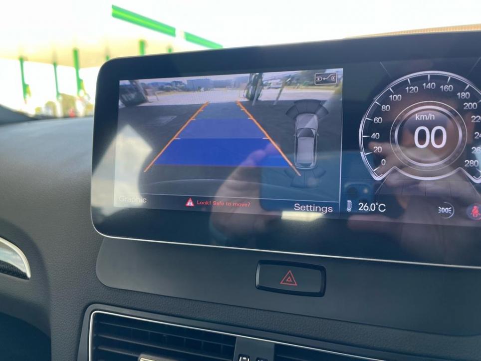

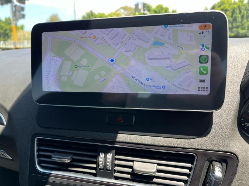

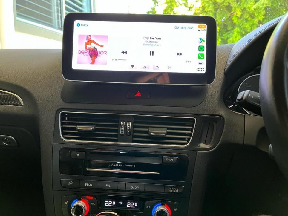

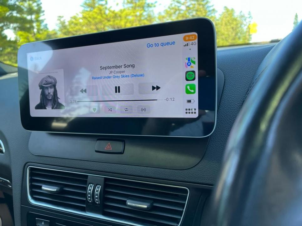

Another 6 monthly oil change for the SQ5 this past weekend @ 72,000km, as well as another recent addition in the form of a 10.25" touchscreen with Apple Carplay sourced via The Fitting Bay.
Also had the slimline number plates restyled in the black and silver colouring which ive been meaning to do for ages - looks much better.
The infotainment in the SQ5 is really outdated as the B8/B8.5 platform was released in 2008/09 so most of the technology is from this era and its just slow and outdated. The new screen is much larger, brighter, and is also a touchscreen so more user friendly to operate. All of the factory functions still work on the new screen (reverse camera, radio, car settings etc) but the wireless Carplay really brings the interior up to date, not to mention having access to the latest Google maps.
The new screen is an Android based unit, so it has the capability to download apps off the Google Play store (YouTube/Netflix etc). I might try downloading the VAG DPF app so I can use the screen instead of my phone.
Installed the new screen and hardware myself in the garage - its about a 2 hour job.

The Android head unit is mostly good. You just have to keep in mind its not an OEM unit so its a bit fiddly. It takes a little while to boot up, then you have to select which phone to connect to even if you are the only person in the car, then open the app on the screen that connects to Carplay. So it doesnt just turn on and go straight to Carplay like an OEM unit would - you have to select a few things and wait. Ive actually been meaning to speak to The Fitting Bay to ask if there is anyway to optimise the boot up process to reduce some of these steps. But once its on and running its great. All in all its an improvement over the heavily outdated and small Audi screen though. The place I got it from (The Fitting Bay) has a few videos on YouTube showing how it works and looks etc as well as an install video - but he does rush a bit in those videos.

That's a bit crap for Carplay, perhaps a wireless thing. I've got Android, which must be plugged in, but the system picks it up automatically and launches Android Auto. I find boot time acceptable, but I do tend to click on the "Phonelink" icon to manually launch Android Auto as usually I can get to the button before the system background launches the app and auto-launches it.Originally posted by Lucas_R View PostIt takes a little while to boot up, then you have to select which phone to connect to even if you are the only person in the car, then open the app on the screen that connects to Carplay. So it doesnt just turn on and go straight to Carplay like an OEM unit would - you have to select a few things and wait.
Just confirming, the velcro is on the "top" surface of the rails not in the grooves? I think that's what I see but want to confirm. Suffering the same issue, so be good to perform a fix for it!
Thanks for the help and advice as always..
Im still learning how to use it. It would be nice to not have to go through the process of selecting which phone to connect to.Originally posted by Daniel_M View PostThat's a bit crap for Carplay, perhaps a wireless thing. I've got Android, which must be plugged in, but the system picks it up automatically and launches Android Auto. I find boot time acceptable, but I do tend to click on the "Phonelink" icon to manually launch Android Auto as usually I can get to the button before the system background launches the app and auto-launches it.

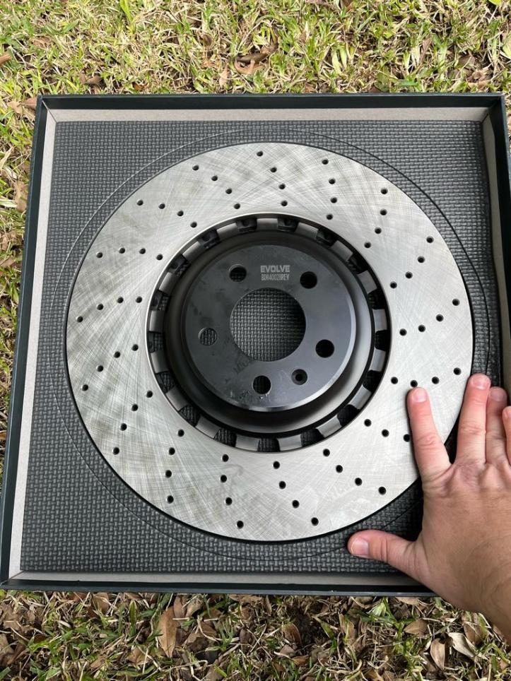

But I did replace the brake disks on the SQ5 a few months ago. They weren't too bad, but the 40,000km or so they had done with the original brake pads before I replaced them with less aggressive pads had worn a good amount of the usable disk surface away. I got the Bremtec cross drilled disks for the front and Bosch disks for the rear. Shame that Bremtec dont make a matching rear disk but oh well.

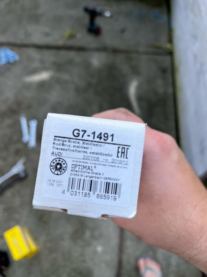

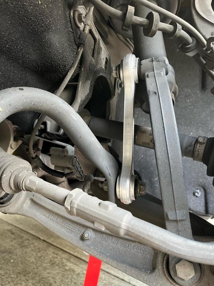

Took a gamble on some alloy sway bar end links simply to replace the factory plastic ones and they were a perfect match. Run Auto Parts sell these.

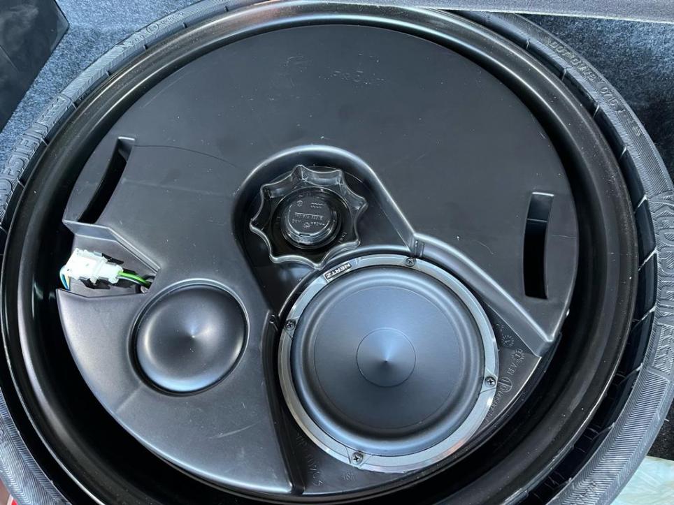

Also decided (just for an experiment) to replace the tiny 6.5" subwoofer which is part of the optional Bang & Olufsen stereo upgrade on these cars. The original "sub" was of pretty poor quality which was not a huge surprise, so I grabbed a $120 Hertz sub (theres not very many options in 6.5") and fitted that. Not much difference and definitely not worth the $120 or so it cost but it's done.

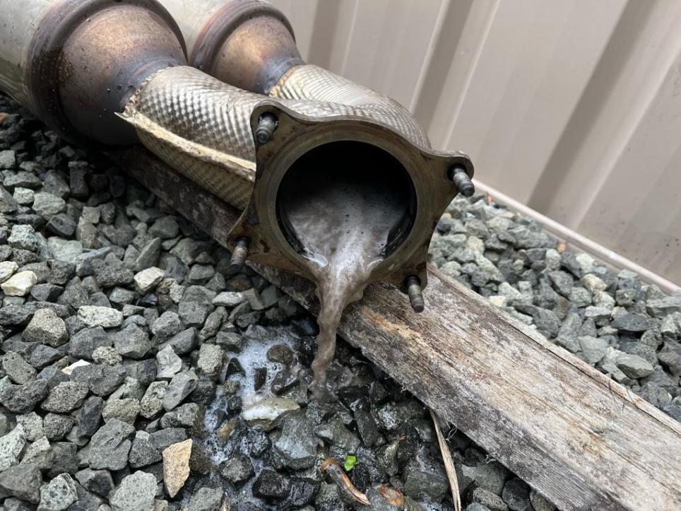

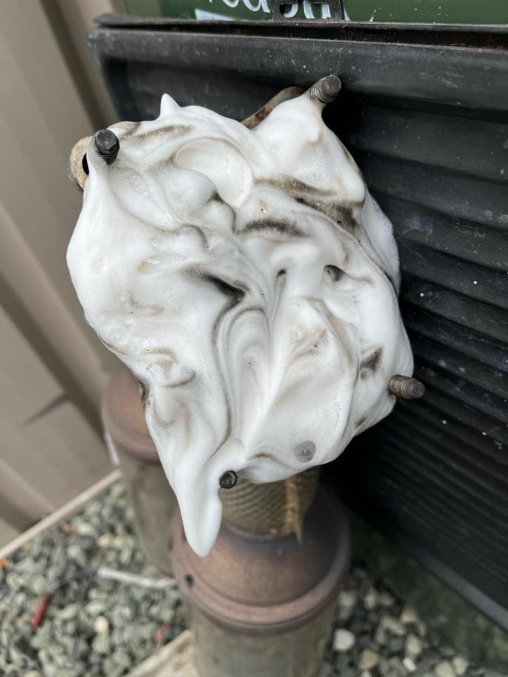

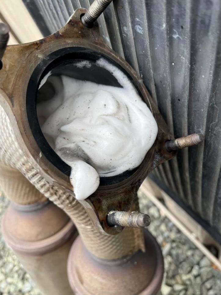

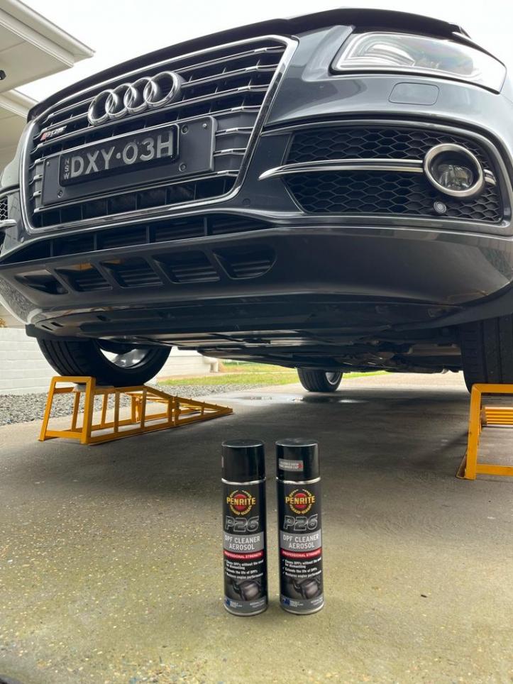

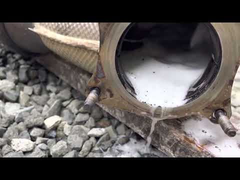

With a bit of time off over Christmas I decided to remove the 2x DPF's, inspect them and give them a clean seeing its been a few years since I last looked at it. I was looking at some of the DPF cleaning sprays (which actually do not require the DPF to be removed, but seeing its very quick and easy to do, plus I wanted to see the before vs after I removed the DPF) and decided to try the Penrite P26 DPF cleaner out simply because they were in stock (and on sale) and my local SuperCheap Auto and saved me having to buy another brand and have it shipped from Sydney or Melbourne.
Penrite DPF Cleaner P26 400mL | Supercheap Auto
Before I removed and cleaned the DPF, I took the car for a drive and performed a regen. So soot level was low at 6.73 grams which is about normal after doing a regen (anywhere between about 6-8 grams).
The DPF catalyst looked visually clean after the regen so I was curious to see what (if anything) the cleaner was going to achieve. This process was more of a curiosity or experiment than anything else as I do not have any DPF issues and the car does regens every 500km or so. The spray comes out of the can in a thick foam, and then slowly shrinks/liquifies/evaporates. I used both cans but in hindsight, I think 1x can would have been enough. After leaving the product to soak into the catalyst for about 20-30 mins, I then flushed it out with the garden hose. I tried to capture the dirt that was coming out after the clean which I was able to capture in a short video.
DPF was left to drip dry for a few hours and then re-fitted to the car. No issues or error codes. Car has been driven about 1000km since.

Nice, did the soot level go down after the cleaning?

It actually went up about a gram or two (I was expecting it to go down a bit) but no doubt there was still some moisture and some of the product still in there that was making the pressure sensors think it was fuller than it actually was. I took it for a spin after putting everything back together just to be sure the car wasn't going to trigger a CEL or have a hissy fit of some kind and was checking the soot level with VAGDPF and Carista.Originally posted by MIG View PostNice, did the soot level go down after the cleaning?
I need to do this on my mum's Touareg, it just clogged its Intake Manifold Flap too :\
Its done a regen since the clean and everything worked as normal so its fine.

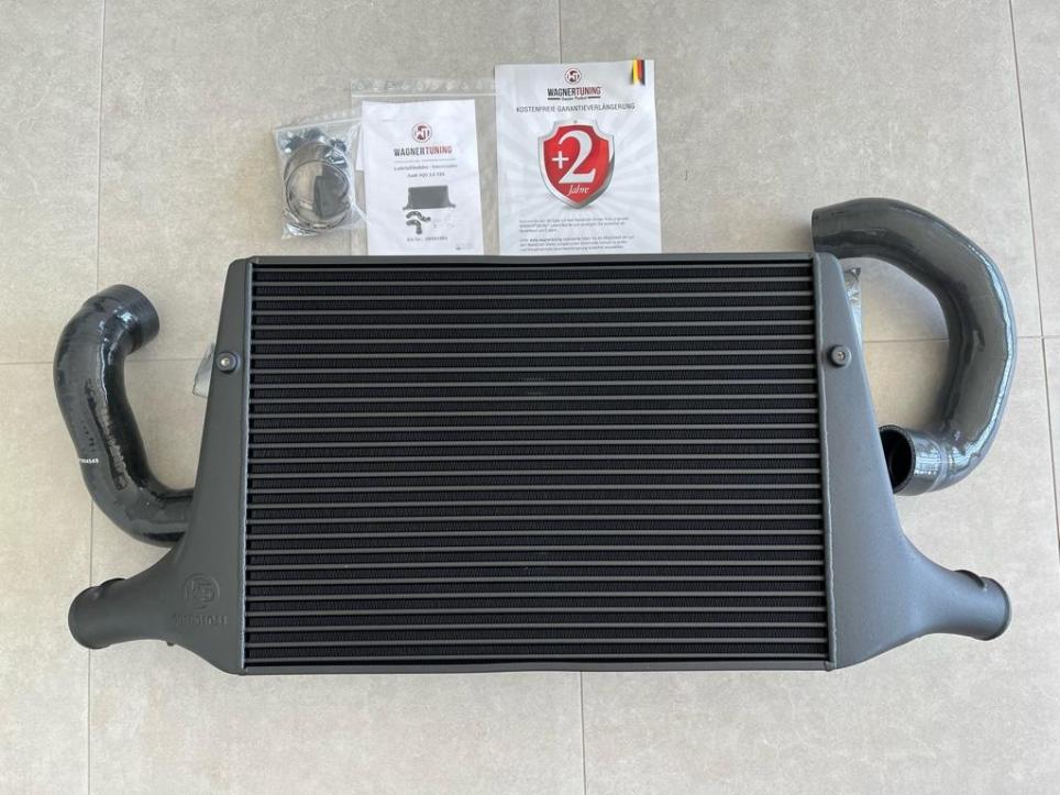

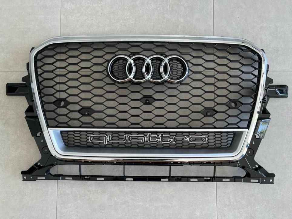

- Wagner intercooler and RS front grill - ready to be installed at the same time while front bumper is off

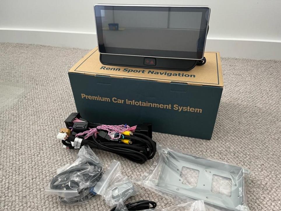

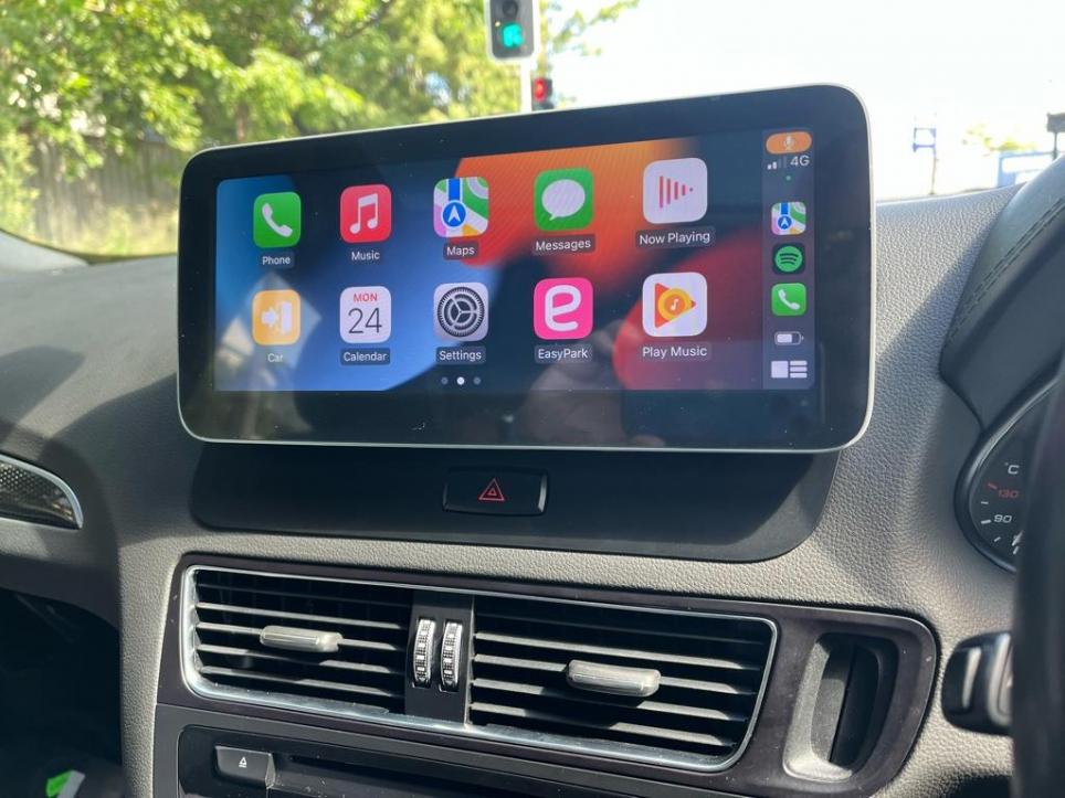

- RSNav Version 4 screen upgrade (10.25") with Carplay - ready to be installed this weekend. Currently have another Carplay screen fitted which is fine, but the RSNav is supposed to be better - we will see.

Unfortunately the custom Garrett intercooler that my brother was making for me has been put on hold indefinitely, as he passed away unexpectedly late last year. Hence why I have decided to buy the Wagner.
