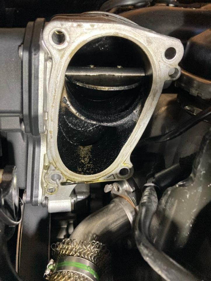

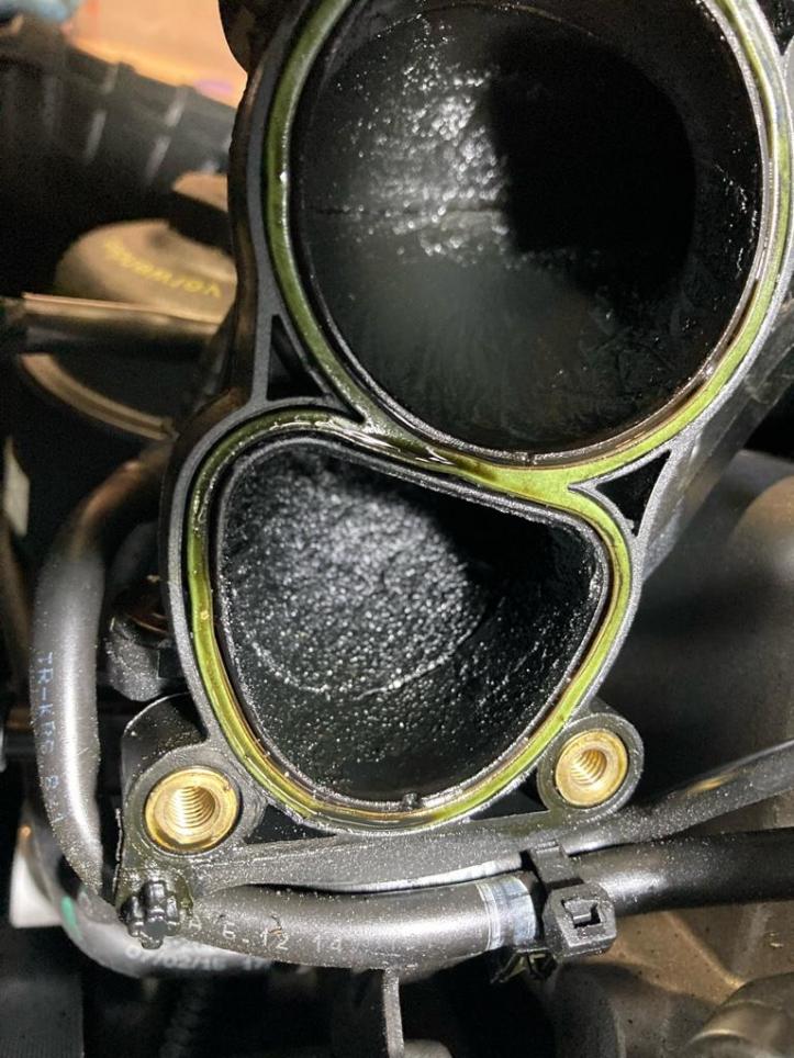

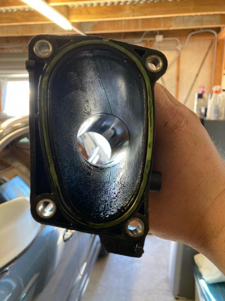

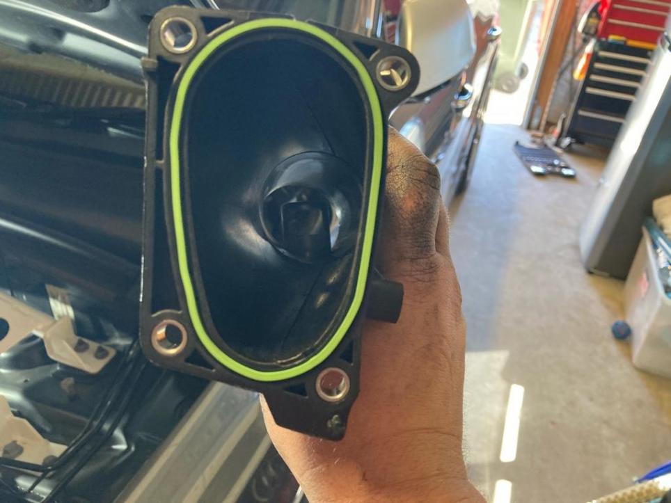

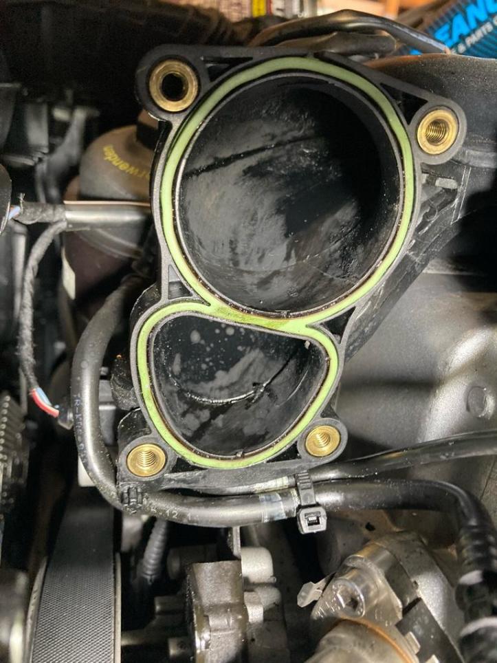

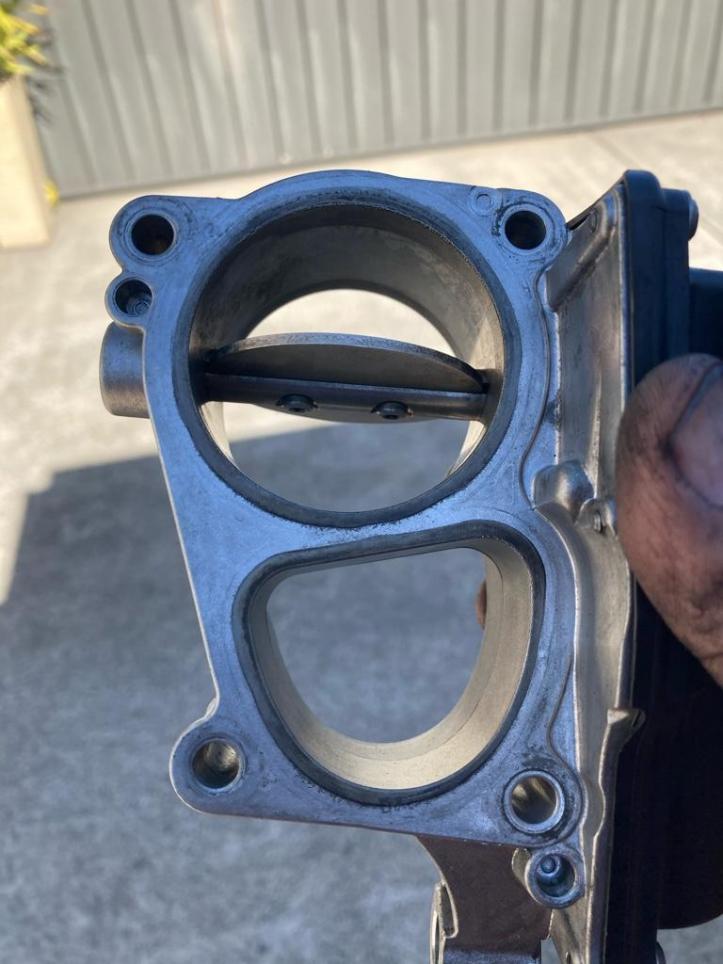

                  • #69
                    Playing with an Audi SQ5 TDI
                    I cleaned out the inlet again a few weeks ago. Its been about 32,000km since I first cleaned it and about 30,000km since I fitted a catch can. Car is currently on 67,000km.
                    As you can see, far less carbon/EGR gunk buildup this time around, despite almost identical time and amount of km’s since the first time I cleaned it. (first cleaned at 3yrs and 35,000km, now 6 years and 67,000km)
                    In addition to there being far less gunk, it was much easier to clean because it was more oily/wet rather than gooey and baked on.
                    I would still like to physically remove the entire intake manifold and have that cleaned properly (ultrasonic bath) but in the meantime, this is certainly better than doing nothing.
                    Normal Nulon carby cleaner works really well to clean up the gunk.
                    Before:
                    After:
