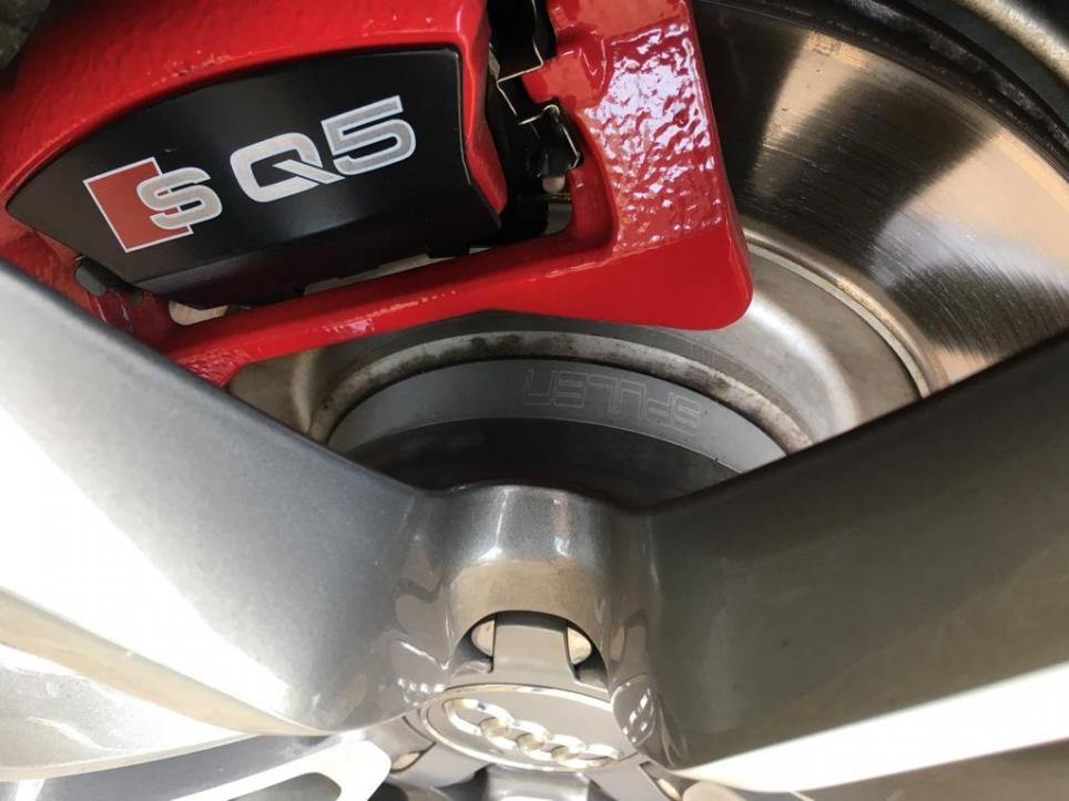

      Some photos of the Spulen wheel spacers from USP Motorsports (15mm on the front and 20mm on the rear). Very good quality kit which includes the hub centric spacers and new longer bolts. SPULEN Audi Q5/SQ5 Flush Kit - WSKT-Q5F - 6928
      Excuse the dirty car, we'd had a heap of rain - it got a nice bath later that day.
      Bath time later that day....

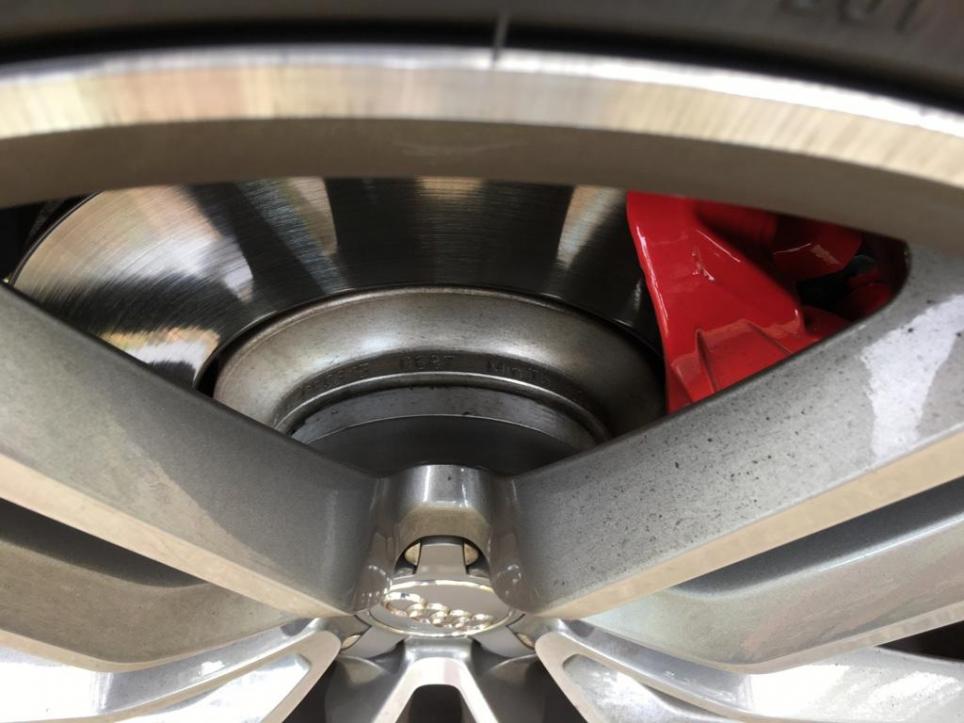

        Akebono Euro Ceramic brake pads ordered and fitted. I ordered the rear pads first just to test them out and see if they were worth it. The answer is yes - especially if you are like me and enjoying having a clean car and also enjoy your car staying clean for as long as possible.
        Huge difference in brake dust compared to the original pads as well as the Bremtec Euro Ceramic pads I fitted not long after buying the car. The Bremtec pads were better (less dust) than the original pads, but still very dusty and the dust was black so it was very obvious on the wheel. Turns out I should not have wasted my money on the Bremtec pads because they were not much different to the original pads.
        The new Akebono Euro Ceramic pads are fantastic. Not only is there far less dust but the dust is a light grey/silver colour so its much less visible on the wheel. The Akebono pads are made in USA so the only way to get them here is to buy from someone like ECS Tuning or Amazon - I got mine from Amazon because the freight cost was cheaper than ECS Tuning.
        I also considered the ATE Ceramic pads which also get good feedback, but for some reason ATE only make the rear pad for the SQ5. I wanted the same brand pad front and rear so when I saw Akebono made them my mind was made up.
        An added bonus is that both the original pads and the Bremtec pads fitted previously made a harsh noise when cold and coming to a complete stop, whereas the Akebono pads no longer do this.

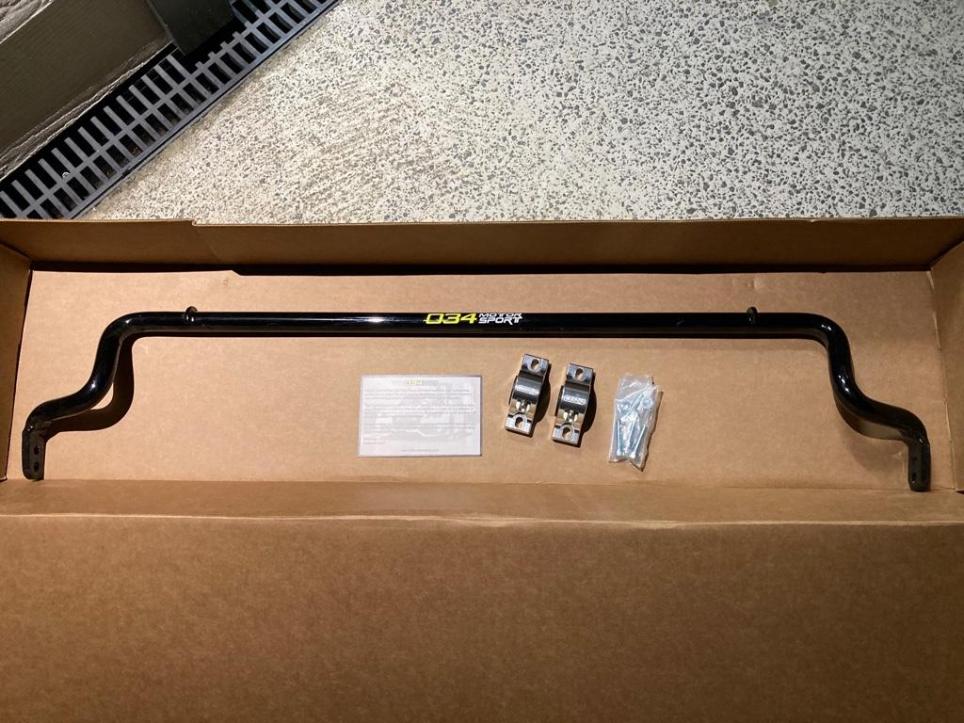

          Parts incoming.......ordered a 034Motorsports rear swaybar and end links. End links are on backorder, so will just be installing the swaybar for now and end links at a later stage.
          In other news, the speakers in the exhaust (yes there are speakers in the exhaust) which make the car sound much tougher than a TDI normally would have busted (pretty common on the SQ5) so will be doing a DIY repair as i don't fancy paying $2.5k for a new exhaust from Audi. The DIY repair will cost me around $150 and only a few hours work.

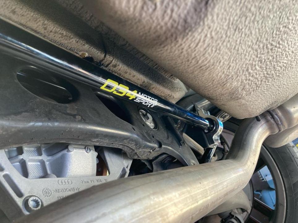

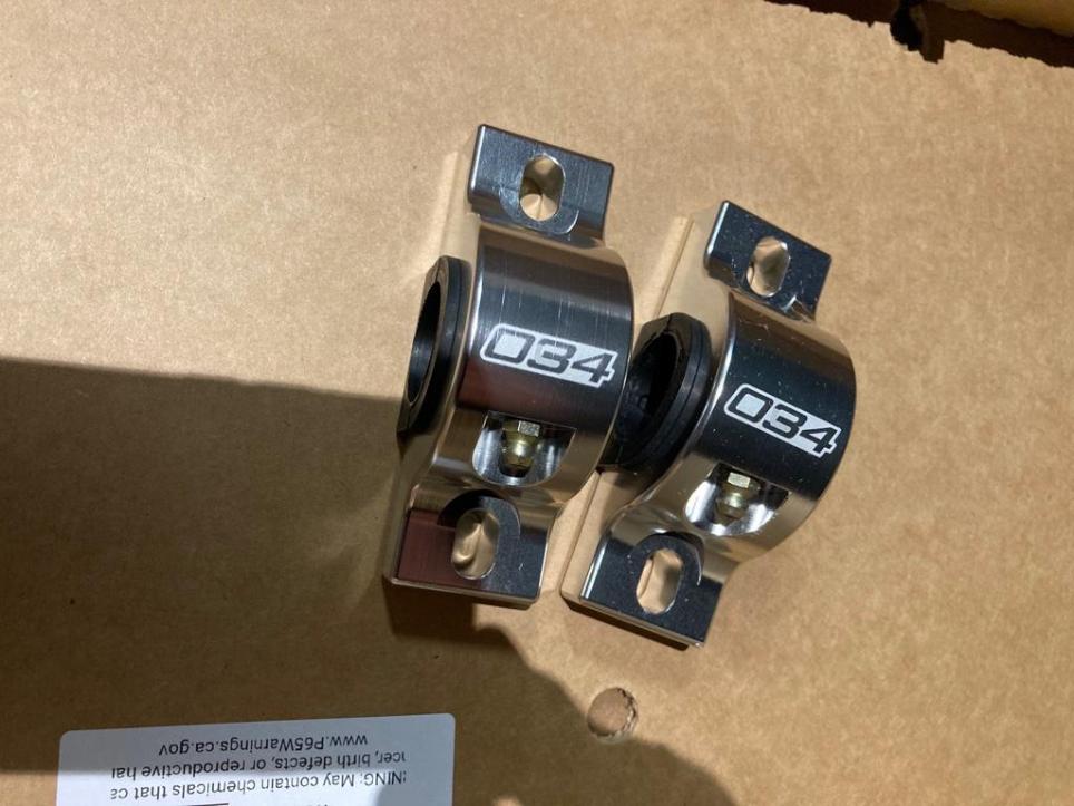

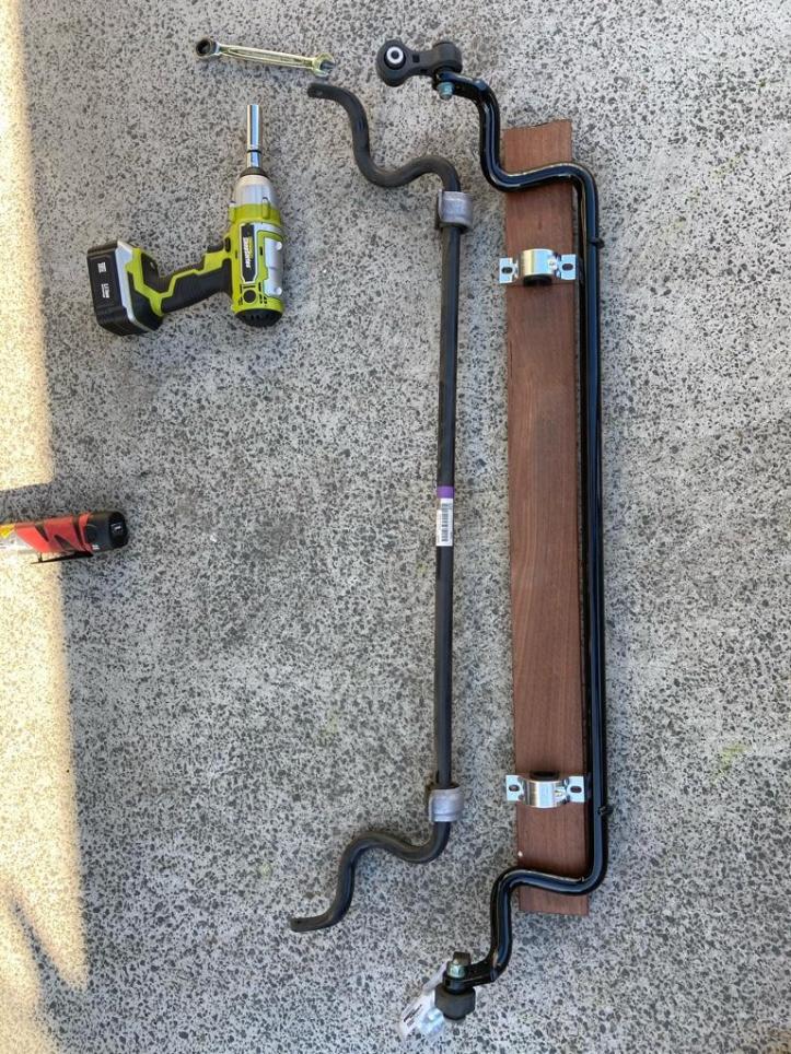

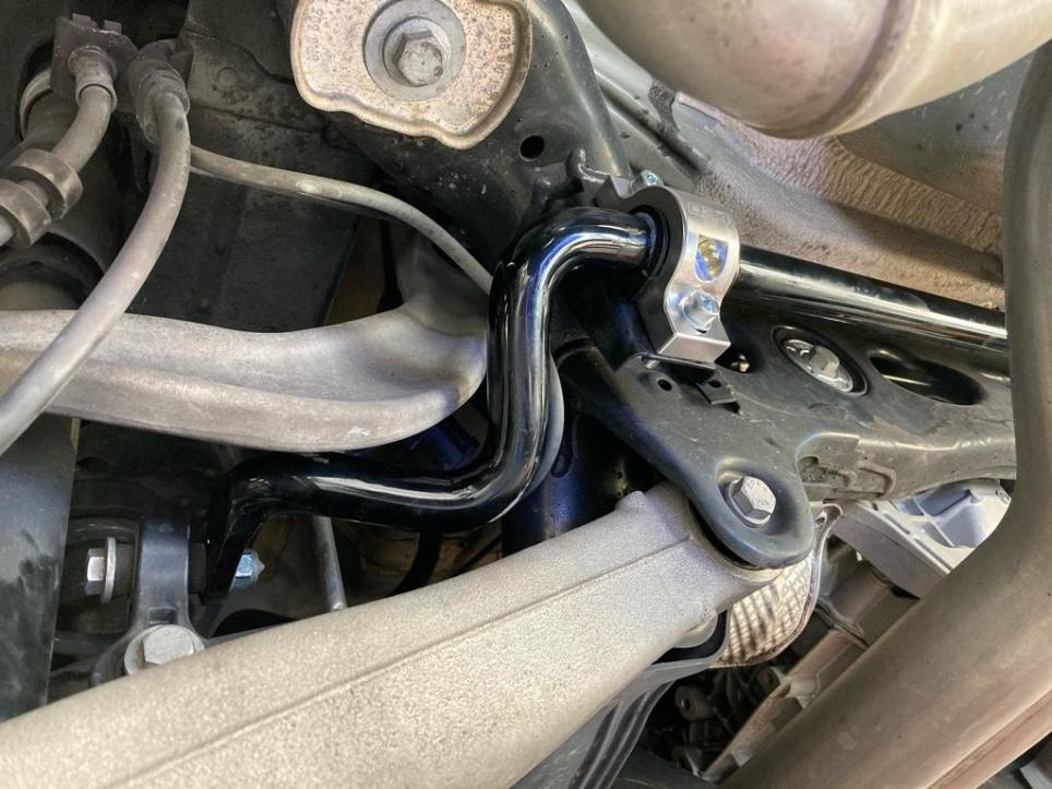

              New swaybar fitted yesterday. Those billet brackets are automotive porn and add some underbody bling (although no doubt totally unnecessary). Not a fan of the allen head bolts used to secure the brackets so will pay a visit to my local nut and bolt shop to find something else to replace them with.
              Only taken the car for a short drive (in between the all the rain) but the car is sharper to react to steering inputs and the rear end rotates better now. Feels like less of a 2 tonne heffa now. Happy camper.
              Stock sway bar is 23mm and hollow, 034 Motorsports swaybar is 25.4mm and solid (and much heavier).
              Still waiting for new endlinks to arrive, so just fitted up the swaybar to the stock endlinks for now.

                Hi Lucas, nice car and I like your outline (+pics) of the changes you have made.
                I'm looking at fitting an upgraded rear sway bar to my Superb 206 4x4. Can you tell me is it advised/required to have wheel/axle alignment after fitting a rear sway bar w/wo end links?
                • #23
                  Hi - no not necessary to do a wheel alignment when fitting a swaybar. Only if you are playing around with actual suspension geometry like springs/control arms etc.
                  In saying that, I normally get an alignment done once a year and the car is nearly due for it.

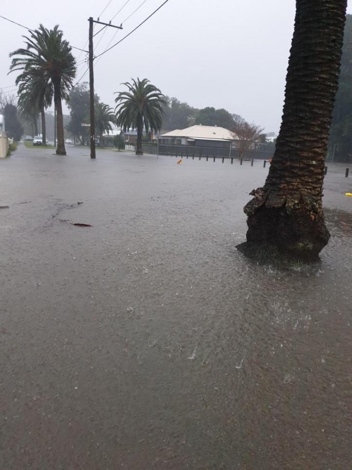

                    Nearly lost the SQ5 in the floods in Newcastle a few weeks ago. Lucky I came outside when I did, as was checking every 30 mins or so and the water rose out of nowhere. Was thankfully able to move the SQ5 out of the driveway and onto higher ground before the water damaged it, but unfortunately could not save my Subaru which was in the garage and it has been written off.
                    The water rose so fast (and went away just as quickly not long after).
                    Thankfully didnt make it into the house (although came very close) so damage was limited to the garage and back shed.
