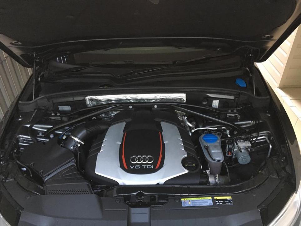

    In August 2018 I purchased a 2015 model Audi SQ5 for the wife to drive around and to be our primary family car. Needed something with some boot space and practical so we can fit our young child as well as large-ish dog etc. But apart from practicality, both the wife and I are car enthusiasts and love having powerful cars.
    This is the 230kw / 650nm model with the 3.0TDI V6 biturbo and 8 speed ZF auto. My brother who worked at the local Lexus dealership at the time sourced it for us, it has just turned 3 yrs old, 1 owner and had done 29,000km (I assume it was a lease car) and came from Melbourne.
    The car was very well spec'd, with only the black grill/window trim being the only desirable option not on the car - but it had the much more attractive quilted leather seats, 21" rims, Bang & Olufsen stereo (which pumps), carbon interior trim, heated seats, radar cruise and panoramic sunroof. The RRP on this car new with the options fitted would have been approx $113k.
    The car was due for its 3rd service, so was swiftly booked into Pete @ Newcastle VW Centre for the service.
    Shortly after the service, we got a recall letter from Audi to replace the heater coil unit, so that was done too.

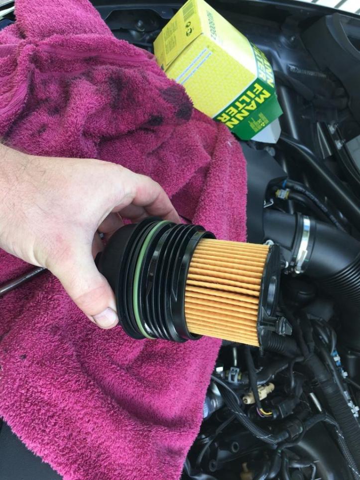

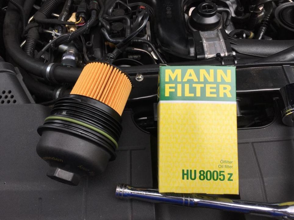

    Gave the old girl an oil change. It was serviced about 7 months ago/8,000kms ago (by Pete @ Newcastle VW Centre) but I always like doing 6 month oil changes so I figure ill do one myself in between each "log book" service.
    I enjoy doing the oil changes myself, and it gives me a chance to study the engine/driveline and inspect for any issues/leaks/worn items. The sump, swaybar, subframe and undertray were a bit grotty (presumably from previous sloppy oil changes as there are no leaks) so I gave everything a good degrease and clean while I was in there.
    The cabin filter was dirty and had been starting to smell a bit the past month or two so in went a new one.
    It was the first time I had done an oil change on this car so I was pleasantly surprised to see that its an easy car to work on which was both welcomed and surprising.

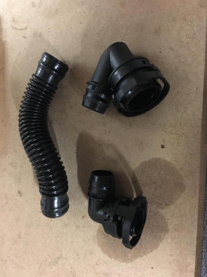

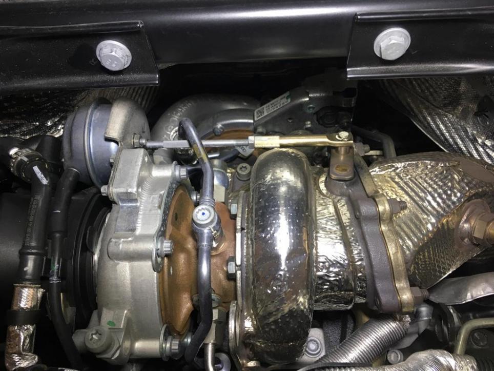

      Bought a Catch Can for the old girl recently. I went straight into looking at the Provent due to its popularity but its quite large (lengthwise) and i couldnt find a suitable area in the busy engine bay to be able to fit it. Ended up finding the Catch Can Pro which is also German made with similar specs to the Provent, but a little smaller in overall size and i have made a mounting bracket to secure it behind the passenger side headlight.
      Catch Can Pro - Genuine Flashlube
      The RRP is around the $280-300 mark but I got it via a special order from Supercheap Auto when they had a sale recently for just over $200. Its German made, nicely designed and has the 19mm inlet and outlet same as the Provent.
      There are no kits (i have Googled extensively) to suit the 3.0TDI bi-turbo which I found weird considering this engine is quite popular and used in various Audi/Porsche models, so I have purchased some 19mm oil hose and various fittings etc to be able to mount it onto the car. Only one of the cam covers has the breather/PCV mechanism with that accordion hose feeds back into the intake just before the primary turbo - so this is where i will be tapping in and letting the catch can clean the air.
      Who doesnt like a OEM billet compressor wheel? You can see the spot where the PCV plumbs back in just before the turbo.
      1st turbo up top, 2nd turbo hiding down below.
      Tapping into the factory PCV accordion hose that goes between the valve cover and the turbo inlet pipe. I used the fittings but cut the hard plastic hose off.
      Catch can location (had to make a custom bracket to mount it securely).
      End result. I need to get half a dozen hose clamps which i will get this weekend but for now every connection has a zip tie holding everything together.

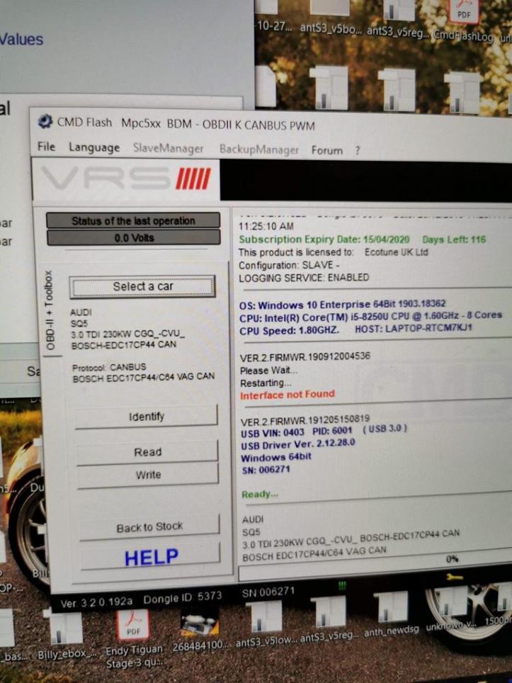

        It wasn't long before I was looking at remap's for the SQ5 (not that it really needed any more power, but why not). After considering the options below and speaking to all of the companies, I decided to go with Underground Performance because i know Alex (the owner) and also the remote tune option was attractive to me. He also agreed to try and turn off the EGR for me (which didn't work in the end).
        The tunes all all quite similar in that they quote approx+25-30kw and +90-100nm.
        All in all - a car that was already fairly quick is now quicker. My best 0-100kph before the tune was 5.6 seconds and after the tune i can get between 5.0 and 5.1 for the 0-100kph dash.

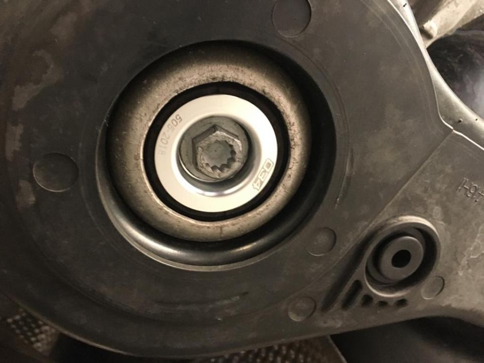

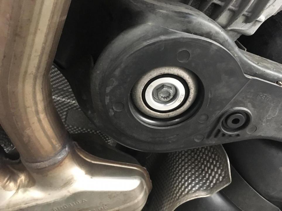

          I have been looking into tightening up the "driveline slop" this car has, in particular the rough gear change from 1st to 2nd which I believe is caused by soft transmission and rear diff mounts which are full of voids that allow a lot of movement. There is also some feedback movement from the driveline on deceleration from 3rd to 2nd. All the SQ5's we test drove did a similar thing so it's not a problem with our car as such, just the way they are designed.
          I purchased a 034 Motorsports transmission mount and rear diff carrier mounts. I believe it will be the rear diff carrier mounts that will make the biggest difference, but will report back once the parts arrive and i can install them and test the difference.
          034Motorsports rear differential cradle inserts were installed and they have made a considerable difference in reducing the drive line "slop" that these cars have from factory. Very happy with this little mod, and best of all it was a super easy and quick install and totally reversible. Anyone with a B8 series A4/S4/A5/S5//Q5/SQ5 etc should install these.
          Also recently purchased and installed some Spulen (15mm front and 20mm rear) wheel spacers and new bolts from USP Motorsports which give the car a much nicer stance on the road and push the wheels out. SPULEN Audi Q5/SQ5 Flush Kit - WSKT-Q5F - 6928

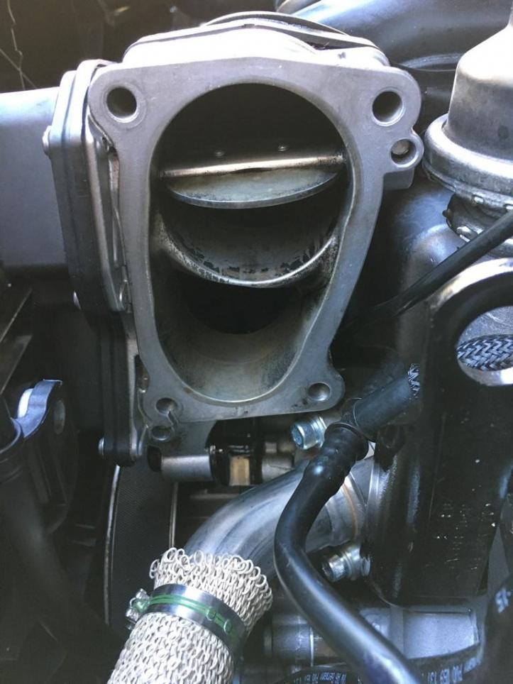

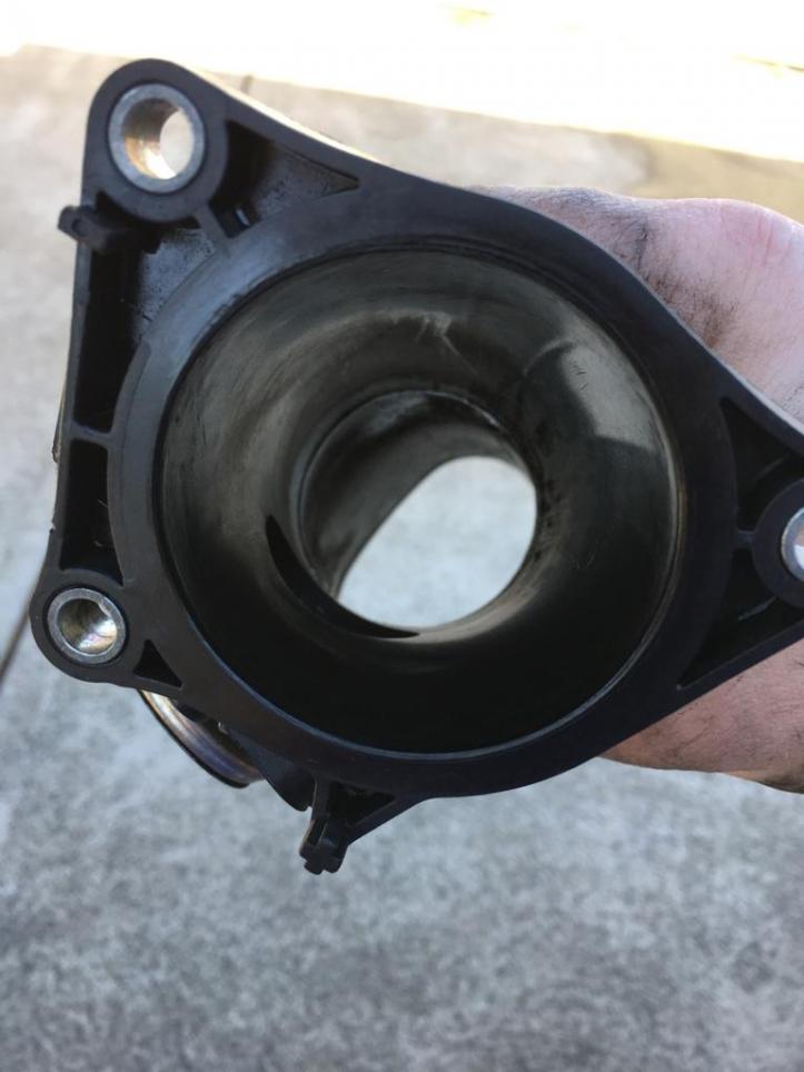

            P2006 Intake manifold runner control stuck closed bank 1.
            Upon Googling, i can see this type of error is pretty common on the single turbo 3.0T V6 TDI engine in the normal Q5/A6 etc, but have not been able to find any information relating to the bi-turbo engine used in the SQ5 (and several other Audi models such as the A6). The inlet manifold design is also different on these 2 engines.
            I cleared the error code to see if it was a one-off or if it would come back again, and it came back again the following day.

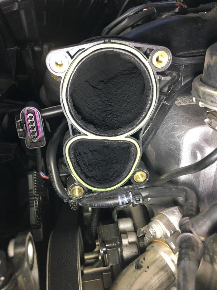

            So I decided to pull off some intake bits and see what i was dealing with - to my surprise the intake pipe, throttle plate assembly and intake manifold (all located after where the EGR is plumbed into the intake) had a thick layer of soot/carbon junk on them....no wonder I was getting the error!!!
            I knew this was an issue with modern diesel engines and emissions targets but wasn't aware it would be this bad with only 35,000km.
            Anyway, with a combination of petrol, degreaser spray and a soft wire brush these parts are looking much cleaner and the error has not re-appeared.....yet.
            I have since purchased a can of Liqui-Moly diesel intake cleaner which i will run through the engine sometime this week. I am also going to look into the possibility of an EGR delete (either physical or ECU coded delete) to stop this from happening again.
            UPDATE Jan 2024: After doing this intake clean several more times over the past few years, the best product I have found is regular carby cleaner like this Pro-Strength Throttle Body & Carby Cleaner (CARB400) All the other products (petrol/degreaser/Liqui Moly intake decarb etc) do basically nothing to break down the carbon. The carby cleaner is quite effective though.
            Before:
            After (not perfect but much better). I also cleaned the plastic pipe leading to the inlet manifold and scrapped out the inlet manifold as best i could but didn't take pics as my hands were pretty grotty by then:

              Also took the opportunity to install the 034Motorsports diff mount insert which i purchased recently to complete the drivetrain stiffening - now having the gearbox mount insert, diff carriers inserts, and now the diff mount insert. The SQ5 had quite a lot of drivetrain slop from the factory, so these inserts have helped to reduce this.

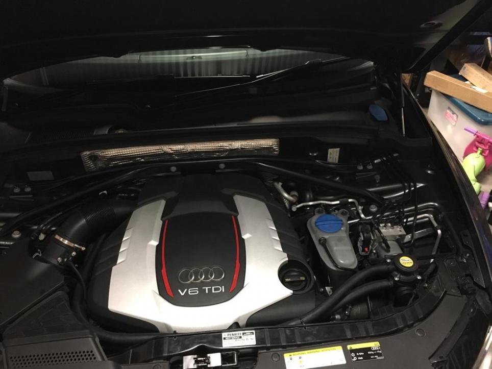

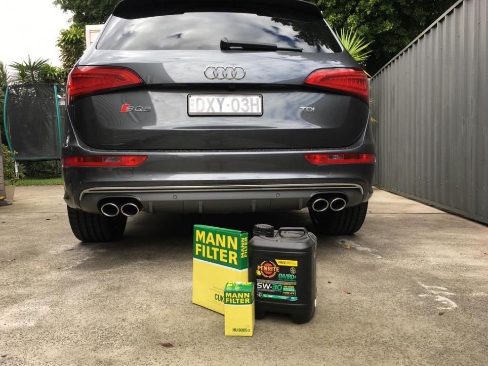

                        Bringing this story up to the present day, I gave the SQ5 a basic DIY service on Saturday which is something I like to do in between it’s scheduled yearly mechanic “logbook” services. It gives me peace of mind to know that the oil in the engine is fresh and it is a low cost exercise anyway. Plus with all of the isolation rules regarding this Corona virus, it gave me something to do on Saturday morning (and I had already purchased all of the items I needed several weeks ago already).
                        - Starting with a Liqui-Moly intake decarb (removed intercooler hose where it joins the intake manifold and sprayed in there)
                        - About 7L of Penrite Enviro+ 5w-30 oil (VW504/507 approved)
                        - Mann oil filter
                        - Rear brake pads
                        - Drained the catch can
                        During the week I had received my new Akebono Euro ceramic brake pads which I have been very interested to try and see how much they will reduce the brake dust. I only purchased the rear pads at this stage and will see how they compare over the next few weeks before I make the decision on buying the front pads. I used my Carista dongle and iPhone app to release the parking brake mechanism so that I could change the pads.
                        Part # EUR1018 (rear pads) Link: Audi Disc Brake Pad Set - Akebono EUR1018A | FCP Euro

                            Well i used to use Liqui-Moly but that became more and more expensive and harder to get, so started using the Penrite several years ago and now I use that - I like to keep the same brand of oil in the engine (call me OCD). It's a good quality synthetic oil, meets the relevant VW specs, is readily available at Supercheap/Repco etc and regularly on sale which makes it a no-brainer for me.
                            Taking photos of the process is more just proof that I have actually done the service for when we move this car on to a new owner in a few years time.
                              I’m a castrol man my self but for filters with Audi, I always stick to oem or Mahle filters. Bosch is ok for an all rounder. For some reason VAG diesel filters a UFI that are not really known for there quality.
                              Air filters you can’t go wrong with a K&N
