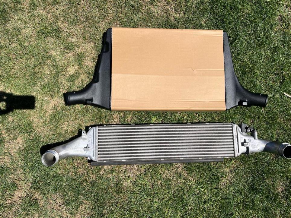

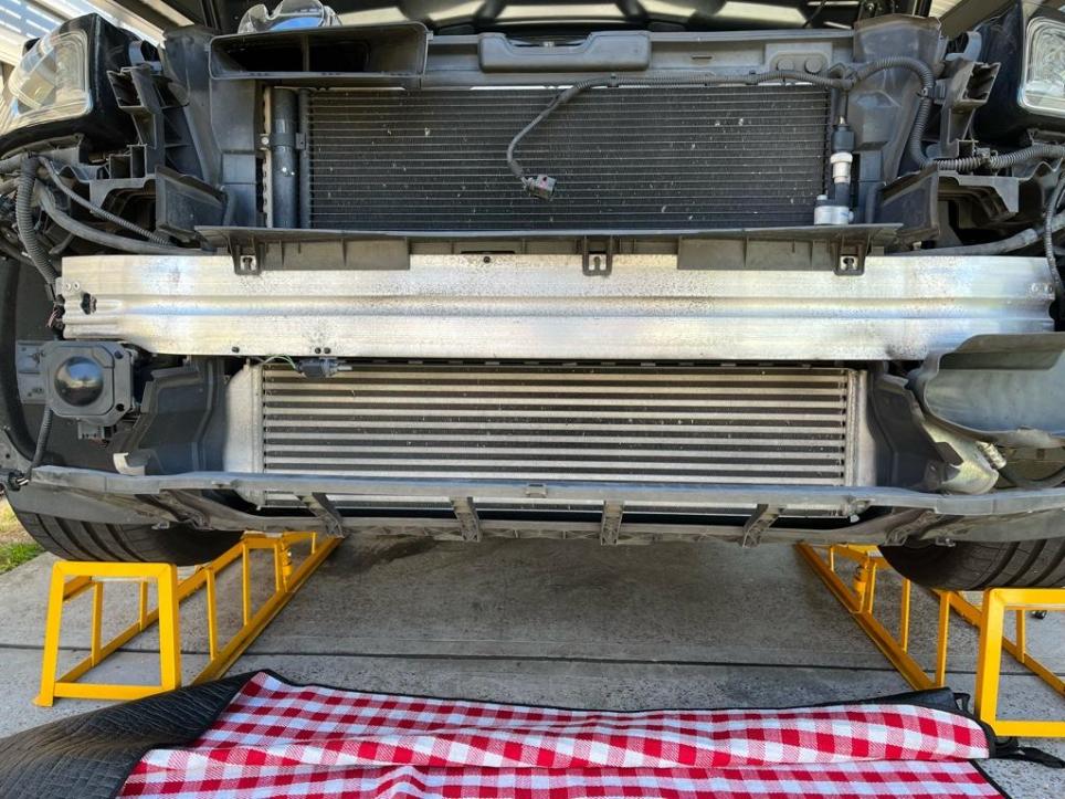

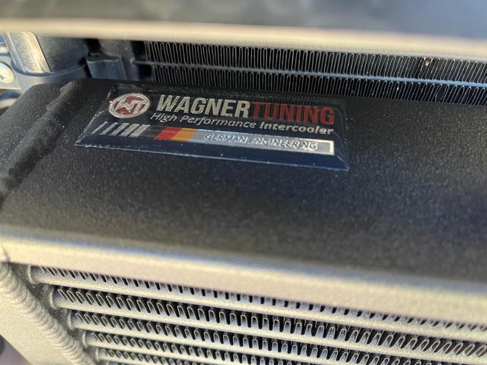

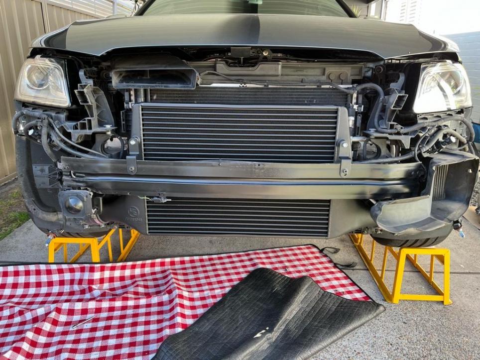

                    Big day on the SQ5 on Sunday. Decided to finally do the intercooler and RS front grill installation.
                    Front bumper comes off easily (compared to several Golfs ive removed bumpers on) and fitting the new intercooler was straight forward enough. As you can see, the new intercooler is about 2x times larger (its not as thick or quite as wide, but much taller). A very nice quality intercooler as you would expect for the price paid.
                    RS grill was a pain in the butt. Everyone says these are fiddly and requires trimming to get it to fit. I actually ran out of time and had to abandon the RS grill install because it was just taking too long - very fiddly and time consuming.

                      • Hi Lucas, I see that the intercooler upgrade is pretty popular amongst BiTDI owners but I was just wondering what the benefits of the larger intercooler is? Do you notice any difference in driving?
                        • Intercooler looks great. Looking forward to hearing about differences also!

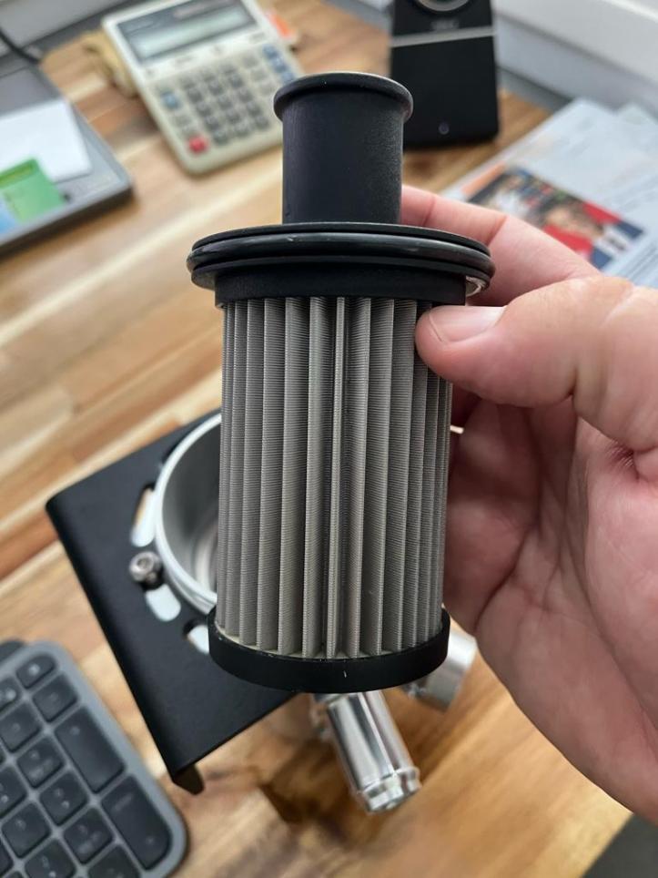

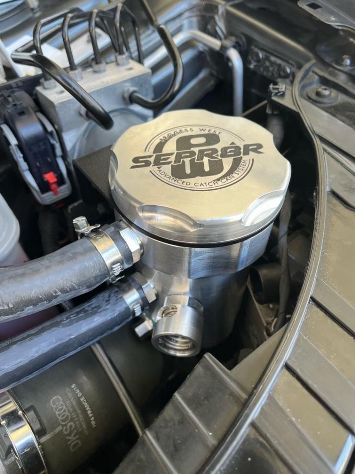

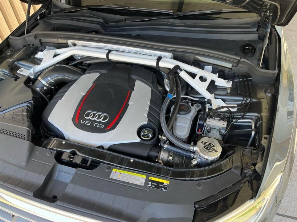

                            Another 6 monthly oil change on the SQ5 this past weekend @ 98,000km. Used my oil extractor to suck out the old oil which is super handy and speeds things up as the underbelly pan on this car has about 40 bolts holding it on - you just need to make sure the oil is hot before you try to use the oil extractor. This engine holds approx 6.4L and my oil extractor is 6.5L and it was absolutely chock-a-block full. I did however notice that one of my injector seals is starting to leak so ill order a full injector seal kit and replace all 6 over the next month or two. Later this year the car is going to get a transmission service for the ZF8 speed as well as the diff oils changed etc.

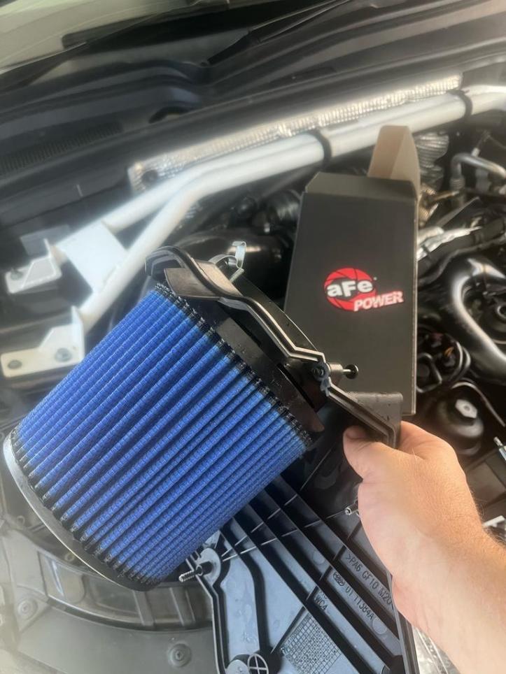

                            I also recently replaced my catch can as my trusty Flashlube Catch Can Pro has been leaking for the past 12 months or so and I was sick of cleaning it every few weeks. After some research and the fact that I do not have much room in the engine bay, I decided to replace it with the Process West SEPR8R catch can which is made from aluminium and should be more durable than the plastic catch cans. Apparently the filter media in the Flashlube/Mann catch cans are better quality, but the mesh filter in the Process West unit it very fine and looks to be of good quality, and its also washable and reusable so that will save on having to buy a $80-100 filter every few years.
                            Also fitted my new AFE air filter.
