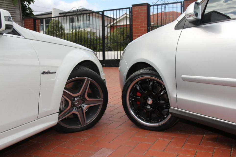

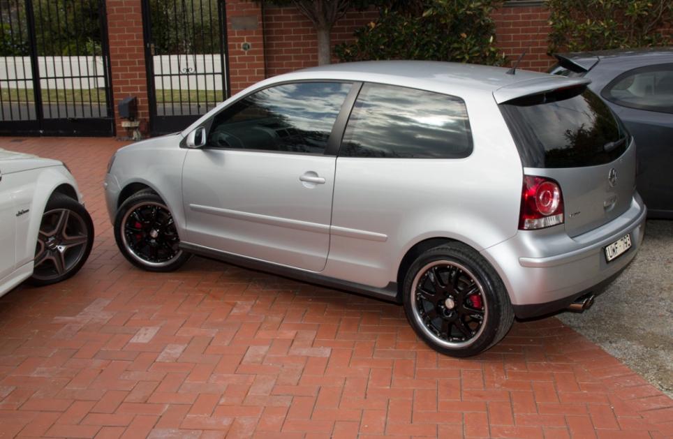

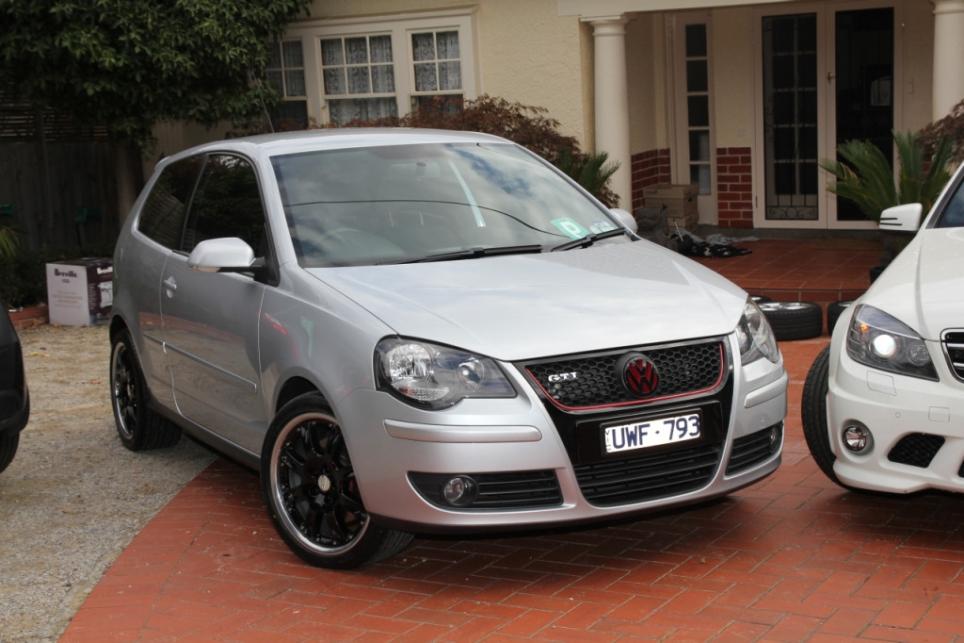

                            • Fitted my new wheels. Dad (GRP on here) bought them off of Stuwey about a month ago, but he had painted them just didn't suit me, so i painted them black.
                              I'm really happy with how they look on the car.
                              2007 9N3 Polo GTI - BBS RC 324
                              • Nice.
                                Does he let you play in the 63? Always wanted a go in one...
                                The unfortuate thing is that the nicer wheels highlights the wheel-arch gap. You know whats next...
