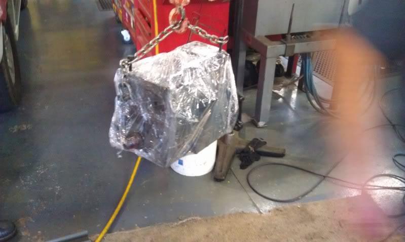

  • The bottom end is now away for balancing and assembly.

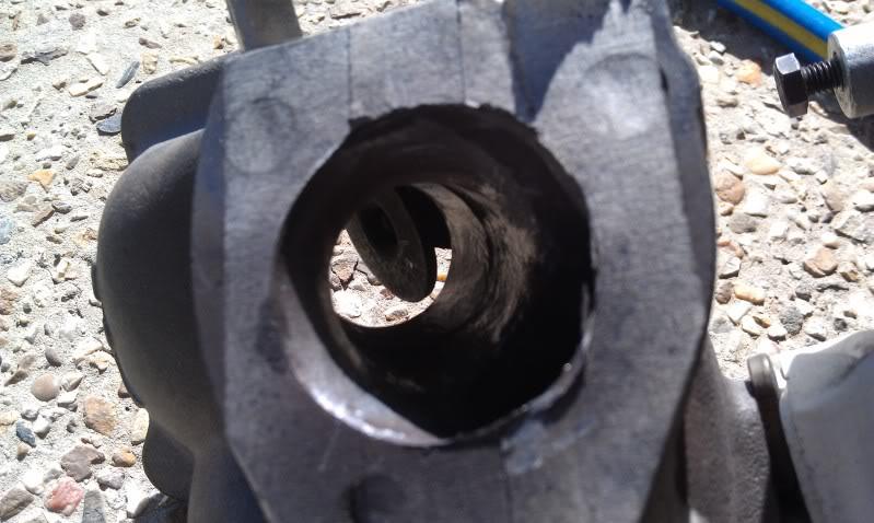

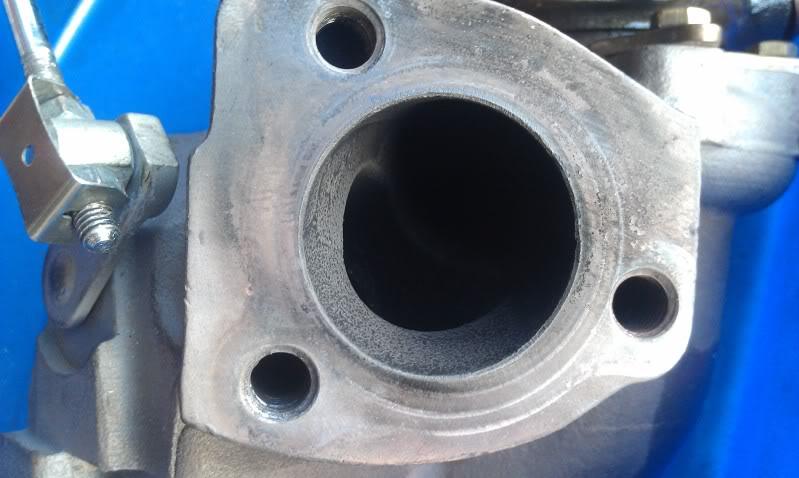

    I ported the FT wastegate and yesterday found that the sleeve the Wastegate pivot runs through wasn't secure in the exhaust housing. I am wondering if the actuator might have been jamming the wastgate and causing some funny boost spike that I was seeing?
    I'll be getting that welded into place shortly, so it doesn't do it again.

                    And while I'm thinking about it... By all means try and weld it, but after the effort you're putting into the porting I'd suggest rebuilding the stupid actuator arm. Ideal kinematics aside the FT arm is a piece of ****. Personally I'd ask Doug to volunteer the housing alloy type and pick a metal with similar thermal expansion rate. Over bore the hole, sleeve and adjustable ream to suit the shaft aiming for perfect fit at operating temperature. New arm with better kinematics, better bush and rotating 'foot'?? design. And flapper too... It sounds involved but really not. Makes me angry that the turbo is functioning so well on shoddy parts, grrrr! Gav, you should test the forge for stroke, work out the dimensions and design a new arm to suit the forge but open the waste gate more. An actuator bracket that allows the turbo to be removed without pulling the turbo might be nice too! The housing casting is crap but so is the OEM...
                    Goddamit I just can't turn off, I need to drink more.
                    • Originally posted by Bullet Fast View Post
                      Gonna just get the chuffing thing welded Pete. It's not going back on the car anyway, as I will just sit back and wait on the BB turbo.
                      It would be nice to work on all that stuff, I'll send it down to you, if you have too much time on your hands

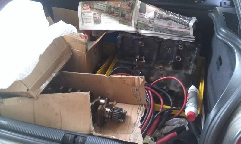

                            • Trip to the Torque Team.
                              4 days later.
                              .... Built bottom end, balanced crank, rods, pistons, clutch. Maybe it'll negate some of the buzz from the poly dog bone?? Or not
