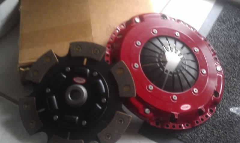

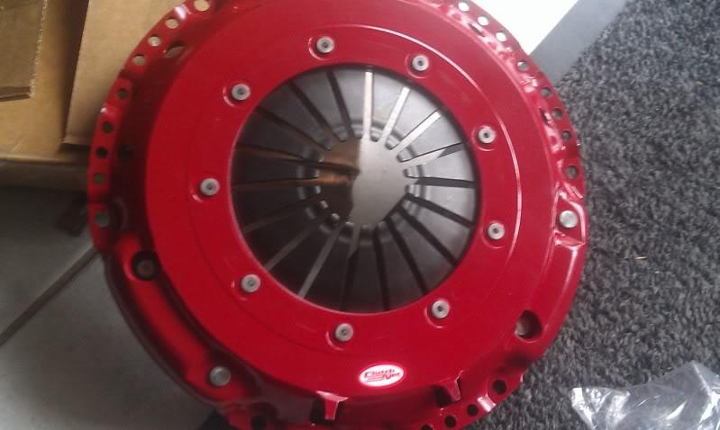

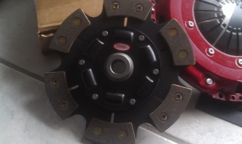

It's been ages, very little has happened really, watching the cash flow. I have had a few shipments arrive, engine crane and stand. New clutch. Stage 3 from fourseasonstuning in Calif. Going onto the LWFW I got with the stage 1 clutch kit from ECS

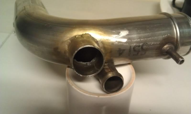

Modified 30mm outlet pipe, to run straight into the Mad Max diverter valve, I got just before the death rattle.

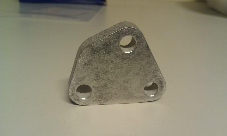

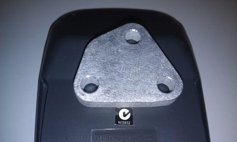

SAI block off plate, not as posh as others but made to reuse the original gasket and bolts, so no new hardware to buy. "Made in Sydney" by Bullet Fast. Somewhat cheaper than the 3D printed airbox lid.

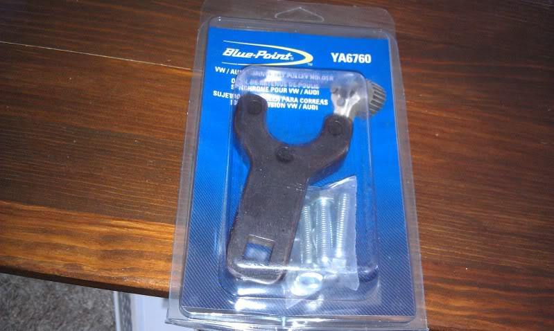

Would be happy now that we could do yours up mate. Maybe even slacken and torque again. $120 delivered from Snap on. Ebay sellers too hard to get a shipping price out of......

Yeah that would be sweet, I check it every week or so and it hasn't budged but would like to do it for peice of mind. Might get my crank dowled at the same time
Make my own then. Are you waiting on something else? I have a memory like a colander. Hey out of curiosity, the MAP sensor is turned 90deg on your intercooler pipe, no problems?
