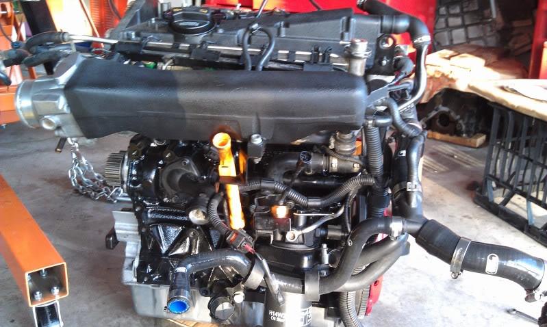

  • Just a few pics I took in the last week or so.

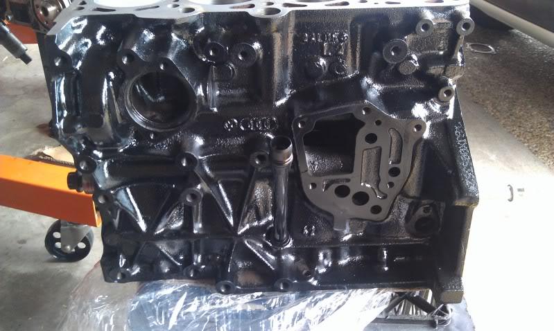

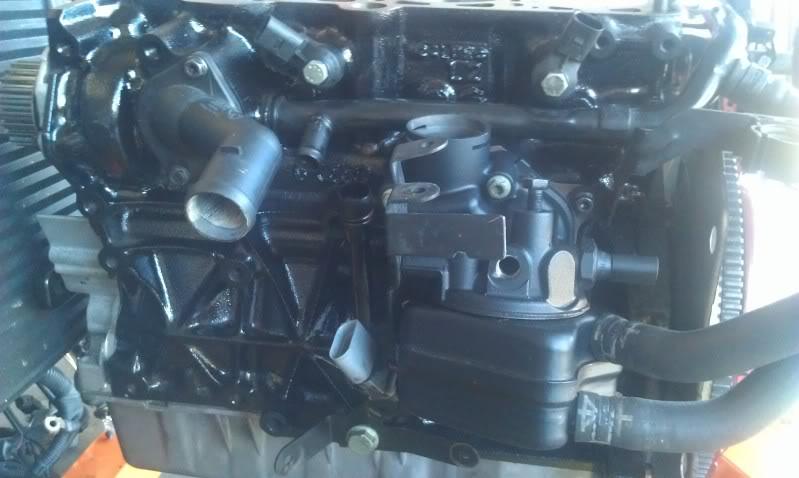

    A bit of paint work on the filter mount. Some reassembly, just sat on a std sump for the moment but I have a wrinkle painted black one to go on after it has gone back into the car.
    I gave the box a good clean off and a hit with the matt black too.

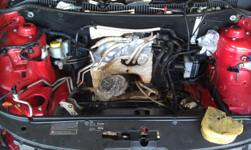

    • Gave the under bonnet a swill off, blasted under the arches with the jet wash too. I replaced the inner CV boots too. One was spitting grease already and at $37 for the pair it made sense to do both.

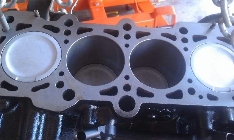

      Head goes on.

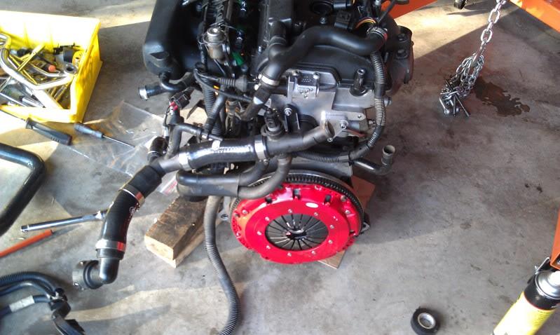

      A few Samco water pipes and the clutch and flywheel bolted up.
      [URL=http://s40.photobucket.com/user/h100vw/media/polo%20gti/IMAG1634_zps2fb87a90.jpg.html][/URL

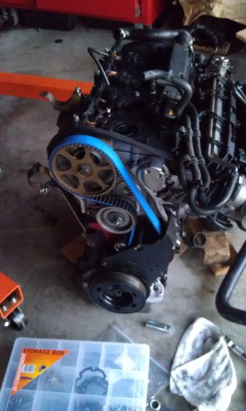

      New Gates Racing belt and IE manual tensioner back on and timing set.
        So close
        • Yeah, could have been running except I don't want to pull the Frankenturbo off it a week later. Especially when I am enjoying the S3 so much after the tweaking I did the other week.

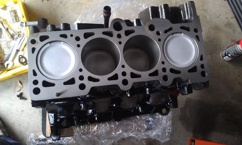

                Gav - can I ask what happened to your head locator/dowel closest to the front of the motor (#1)? It's not there in the first pic, but is in the second albeit 'wonky.' The machinist didn't smack down against the deck trying to punch it out, did they?
                Also, did they tell you how much they took off the deck after re-surfacing? Same done to the head?

                  • Mike, The dowel was a bitch to get out and bust the block at the same time. The guy at the engine shop said it's about 50/50 for getting them out in one piece. No dramas once the head is on and bolts in. I was really mindful of moving the gasket as I put the head on.
                    Not sure how much they took off, I can ask if it's good info for you? The head was skimmed when they did it earlier in the year.

                          I'm not overly worried about how much they took off, moreso that they surfaced it for you according to the RA required (~5% off memory)... Either way, looks nice and neat. I noticed the dowel as I too tapped mine down but didn't have any issues whatsoever... but I can see your mech's point about the 50/50 hit/miss opportunity there.
