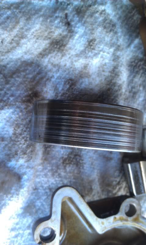

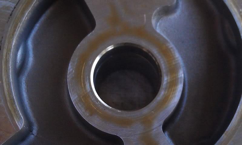

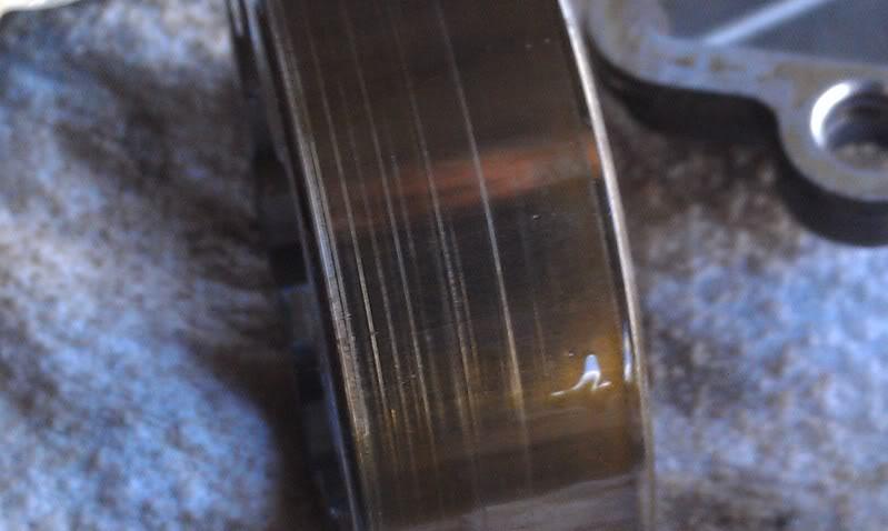

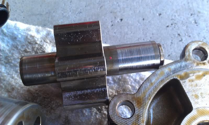

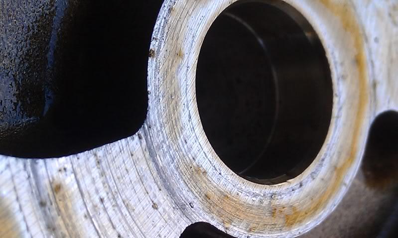

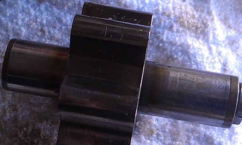

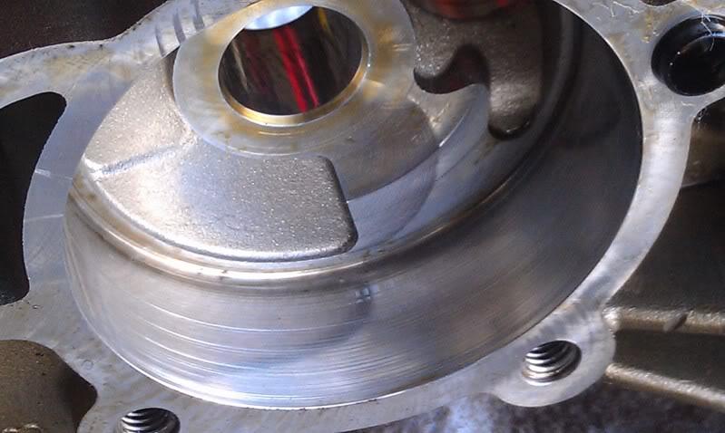

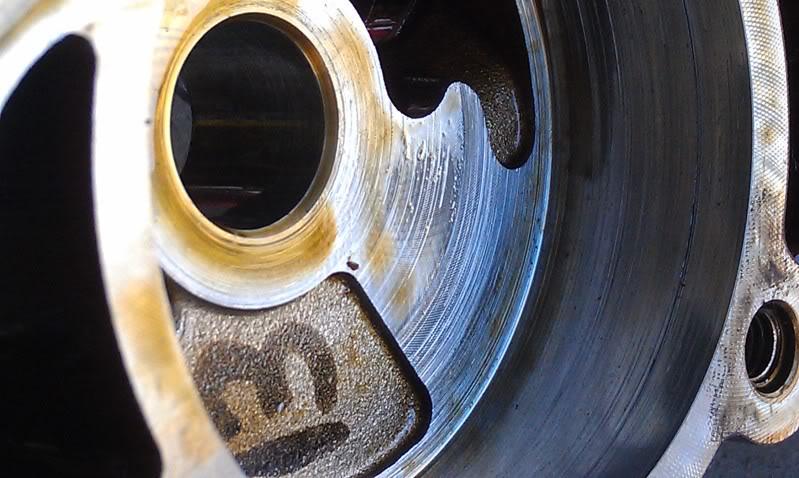

          Now I have it opened up, I am pretty sure I haven't swapped the pumps inadvertently. One is all brown and nasty looking. The other is clean. The sump I lent to Lito has a brown tide mark around it the same as the fitted pump.

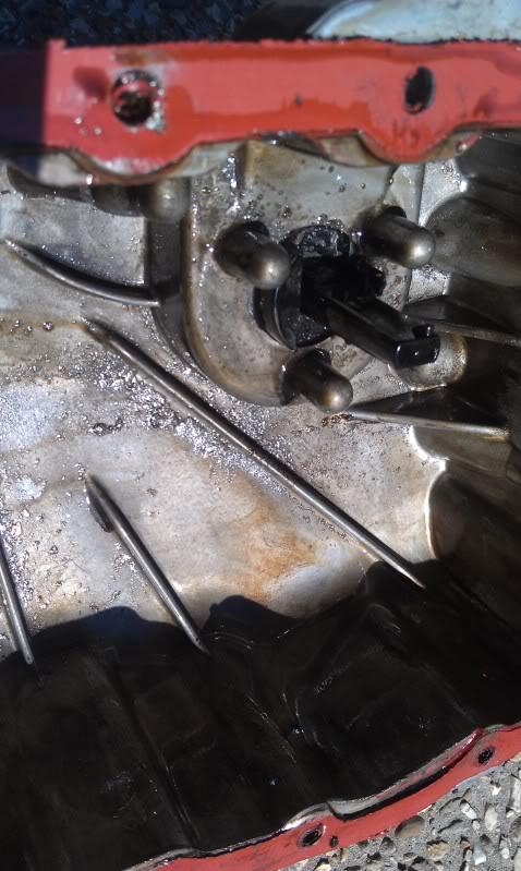

          So still no solid explanation, the pick up is spotless. Doesn't look like any crap made it into the head. A fully charged maglite doesn't make the pools of oil sparkle.
          Last 2 things playing on my mind, the filter mount and the oil filter. A respectable filter from Imparts by Mahle. The filter mount is from the original motor, not sure if that could restrict flow? What do you think Jimmy?

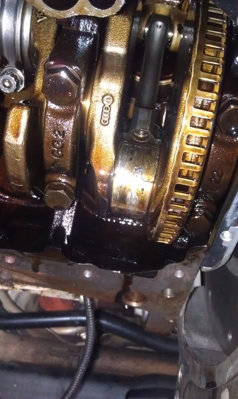

                • Hmm should have had signs though a light flicker perhaps. Have to ask you haven't gave it a caning cold?? or over revved it at all, possibly stretched the rod bolts, if they get stretched the bearing can spin man, pump issues should have been making an appearance imo, a flicker or noises not. Cant see the filter or the filter head mate, I would expect the top end to be noisy and again a light or something, I think all the dramas have been happening at the crank. What a ball ache. Say hi to Rob from me, known him for donkeys years.

                    No noises or anything, just a faint tap to start with and inside of a couple of km it was too nasty to carry on. This will be a clinical build this time.
                    Rod bolts are ARP so better not have stretched!!
                    You can't "over rev" really on the way up and I defo didn't do it down changing.
                    It did stall on me one morning recently, not sure which though. Was on the way to work at the highway. I wonder if that was the first hint of a seize?

                    For interest pictures of good and bad oil pumps.
                    Glittery sump

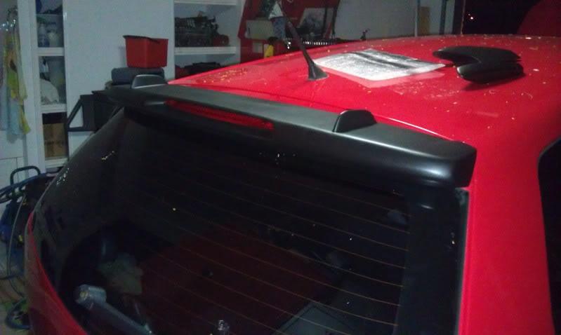

                      • Gavin did you get the spoiler from JC Sport?
                        06 Polo TDi
                        • Originally posted by TDIfan View Post
                          It's from China.
                          A copy of a Cup one, I have just plasti-dipped it in black. I'll be fitting it with sikaflex and hoping I don't have to take it off. The brake light is off a standard no spoiler 9N and I swapped in the LEDs from the GTI.
                          Anthony has another one if you are interested send him a PM.
                          Gavin
