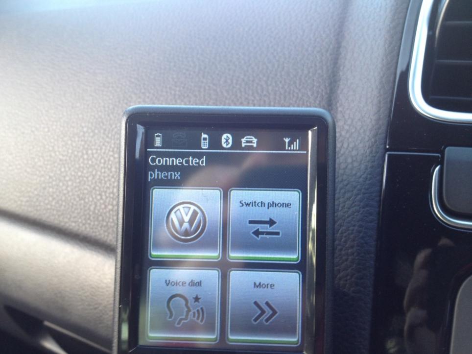

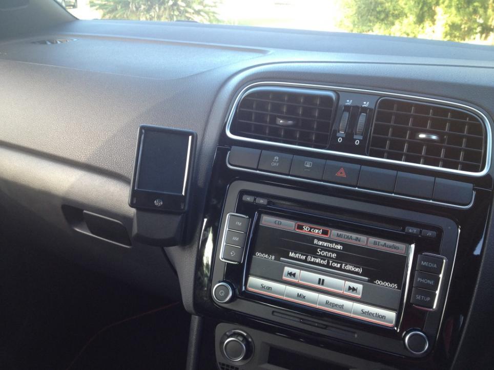

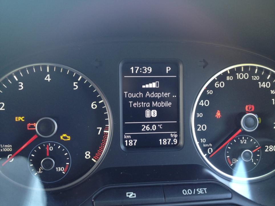

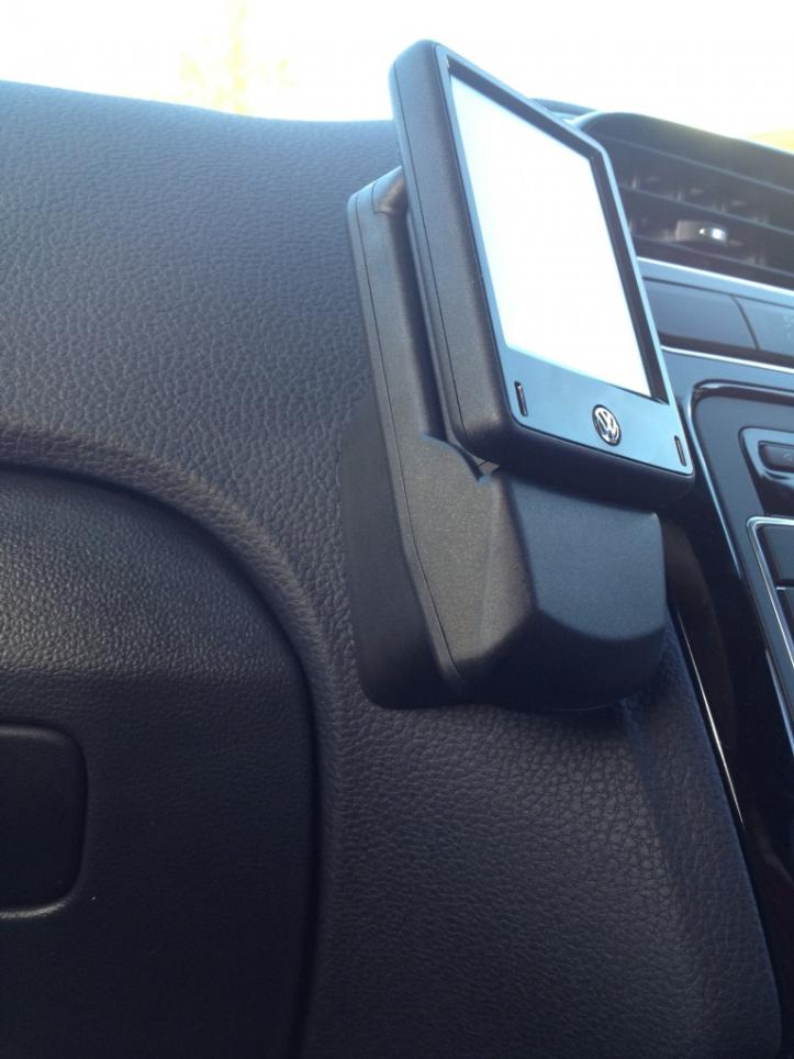

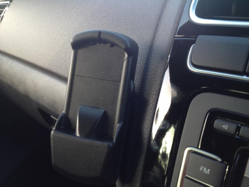

              Okay, so here is a couple of pictures of the Bluetooth "Touch" module on my dash, including with the module removed from the dock.

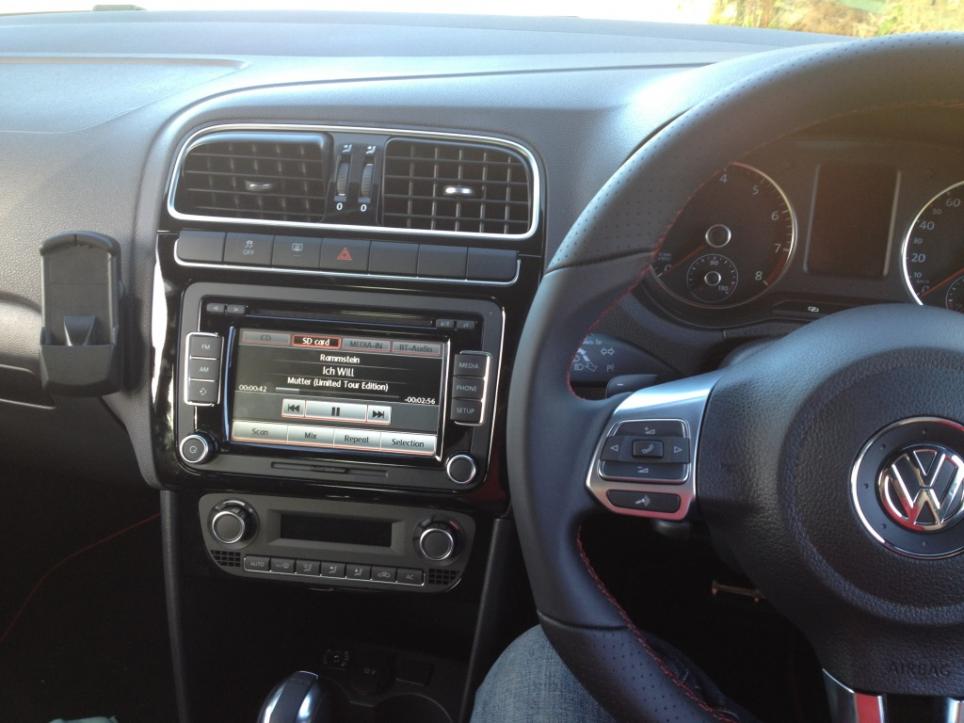

              Ok swell I thought. Now i wanted to take some photos of the MFD showing how the touch adaptor (doesn't fully) integrate.

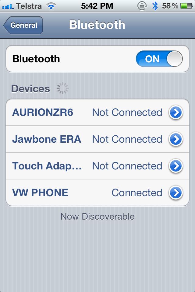

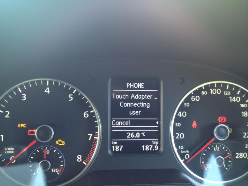

              So anyway, I pressed back on the steering wheel controls, went into Bluetooth settings and it had the option to "add new device". Quite confused by this, i continued, it said "searching for phones, code 0000"... Anyway VW PHONE then popped up on my iPhone, and i put the pin code in and... behold!
              I subsequently removed the touch adaptor from its dock and scratched my head...

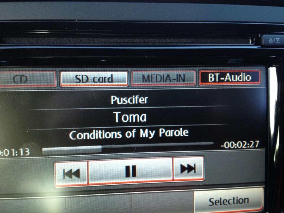

              So i went into my iphone, and it listed Airplay streaming available... and to my suprise I had Bluetooth Audio on my RCD510.

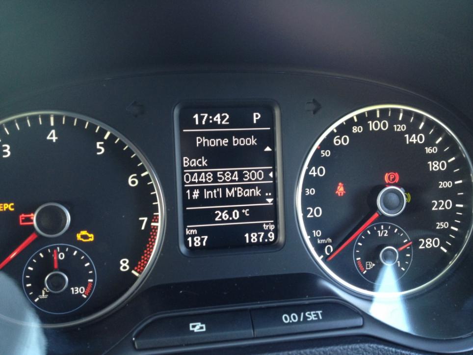

              I also had the full address book in my MFD......

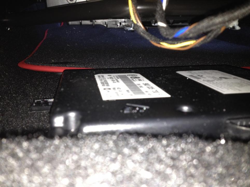

              At this stage I was baffled. So I went to the passenger front seat thinking "ok maybe there is a second BT module?" Nope. Checked Drivers side seat.
              WHAT THE HELL?
              So Volkswagen have included a 9w7 Bluetooth module in my GTI under the driver's seat - but not to be out-done have decided that the Polo must be fitted with two Bluetooth systems, and subsequently fitted the completely pointless touch unit to the dash?
              I am speechless.

                  Thanks for the update. Do you think the Bluetooth touch module (including dock) can be removed from the dash?

                    As far as removing the touch module, its possible to remove it - but you will have a hole in the dashboard. A decent sized visible hole.
                    ---------- Post added at 08:44 PM ---------- Previous post was at 08:16 PM ----------
                    Ok so further experimintation reveals that the Touch adaptor is somehow looped in between the RCD510/MFD and the 9w7 unit.
                    Basically without the touch adaptor connected there is no Bluetooth functionality. With it connected, you can pair to the 9w7 and have streaming audio etc.

                      • SORRY Its 9w7 not 9wZ. But in theory it'd be easy to replace given all you'd need to do is change the box, no cable routing to do
                        I would say though the velcro holding my 9w7 down is VERY TOUGH - its also wedged under the seat like a b*tch, because of the tray/drawers under the seats.
