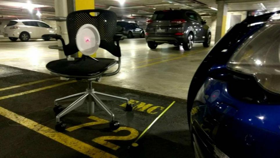

                    Performed a full McGyver ACC radar alignment this morning.
                    Made a laser alignment rig from a laser pointer, a microphone stand and a plastic plate.
                    Calibrated out to about 20m rather than the factory solution which is performed at 1.14m distance to target so I'm hoping the accuracy is enhanced.

                    • #40
                      First test at 60kmh in traffic and performance is improved.
                      Initial detection and lock on target is quicker and it is staying locked more effectively.
                      Happy with the result.
                      Will calibrate a friend's B7 who is still off after the dealer said they had calibrated it...
