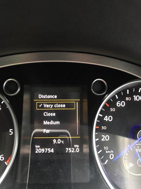

You can adjust the distance to the car in front with the little dial on the cruise control stalk. It has 5 settings - very close, close, medium, far and very far.Originally posted by Hillbilly View PostGreatest thing since sliced bread on the highway. Only thing is that in QLD it holds you a bit far off the car in front and sometimes the usual tailgaters try to push you even at the closest setting. Wish that could be adjusted a bit.Last edited by kamold; 09-06-2017, 09:19 AM.2011 Skoda Octavia vRS TDI DSG wagon|Revo Stage 1|Race Blue|Leather|Dynamic Xenons w 6000K|9w7 BT|THA475 Amp+active sub|Whiteline ALK|RVC|
Ah I see. I've yet to experience that but I suppose they have to err on the side of being conservative. To be honest its probably a suitable setting, just Aussie drivers are all useless...Originally posted by rjt86 View PostThat's true however I've found the same as Hillbilly with people squeezing in on the highway at the closest setting2011 Skoda Octavia vRS TDI DSG wagon|Revo Stage 1|Race Blue|Leather|Dynamic Xenons w 6000K|9w7 BT|THA475 Amp+active sub|Whiteline ALK|RVC|
