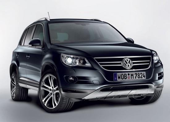

      • Does anyone know if these wheels are available in Australia and what size they are? I found it on a site and they called it a Track or Avenue
        • They look like 19" x 9" Savannahs.
          Can't get the originals here from VGA!
          Although had been featured on the website for like 2-3 years as "coming soon".
          It's possible to get replicas of these though.
          Otherwise, be prepared to pay more than what they're worth (imo) sourcing it overseas.
          Go to post #128 of this thread if you want to see some photos of real ones fitted.

          • They do look absolutely trick! But my dealer quoted me $10K on a set of 4x 19" Savannahs! So I'm sticking with 18" New Yorks for $1200 (at time of ordering)
