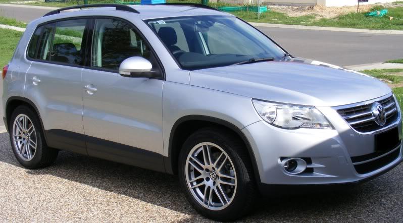

    RS4 replicas, 18"x8", ET45, tyres 235/50/18, ride comfort is pretty much the same as stock, maybe a little firmer but barely, if at all, noticable. Also lowered on H&R springs (about a 35mm drop). I would have preferred an ET30 wheel to fill out the guards a bit more but they seem to be impossible to get in this style.

    RS4 Replicas 18"x8", ET45, tyres 235/50/18, H&R Sport Suspension

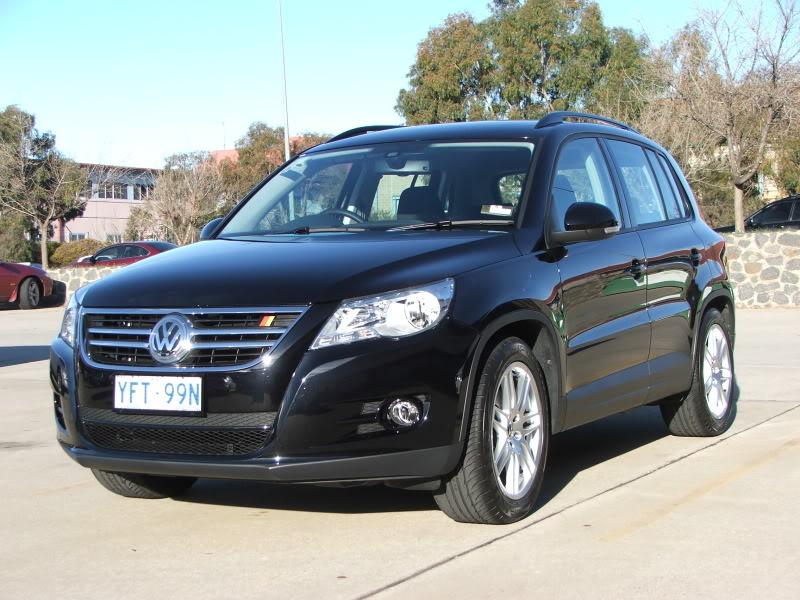

            Hey guys!
            Nice idea for a thread topic. I would like to contribute in order to help all avoid the issues I went through with my new wheels. As many of you may have read on my other threads ("new wheels" and "huge vibrations in Tiguan") I went through hell with wheel issues.
            As I am unable to repost the pics of the wheels properly, can someone please put them up on this thread for me? They can be found in the other threads just mentioned.
            Thanks for your help!
            Tigger
            Last edited by Transporter; 03-06-2010, 12:34 AM. Reason: Insert picture. You're welcome tigger ;)
            2018 Ralyee Green RS wagon. Fully optioned.
            Previous vehicles:2015 Volvo V60 Polestar (my one detour from VW/Skoda!)
            2013 Platin grey RS wagon / 2012 White Polo GTI / 2009 Black 125 Tiguan
              Thanks Transporter!!!!!!
              yep thats my car, (when it had the Advant Concept 18 x 9 wheels and Hankook tyres)
              Loved the look and ride, but after approx 500 kms the car develped an unbearable shake at 115 kmh and up...As noted in the previous thread "huge vibrations in tiguan" it turns out that these were a few mms out in a couple of the holes, which wore loose the tight fit.
              also the bolts were suspected as not being appropriate for the vehichle...
              Such a shame, as I have had to go back to the standard 16" wheels which is killing me!!
              Be careful with your choices guys, and make sure you go to a reputable place. (even though I went to a large "brand name" tyre shop, they still did not know what they were doing...)

                    Ok had my car up on a hoist today so was able to check the offset on my RS4 replicas. ET40 with 235/50/18 tyres
                      I shall rename this "The RS4 Replica" thread hehe, nice detailing there looks like glass!
